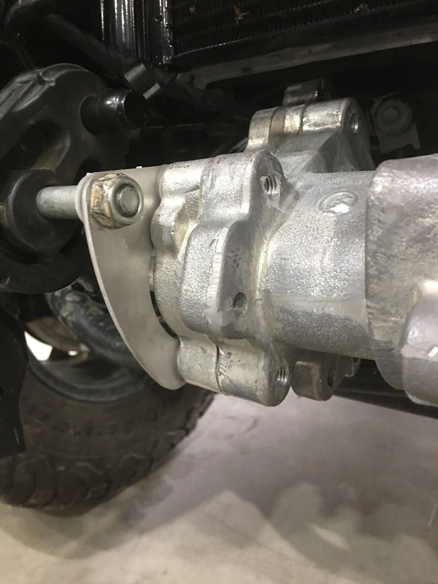

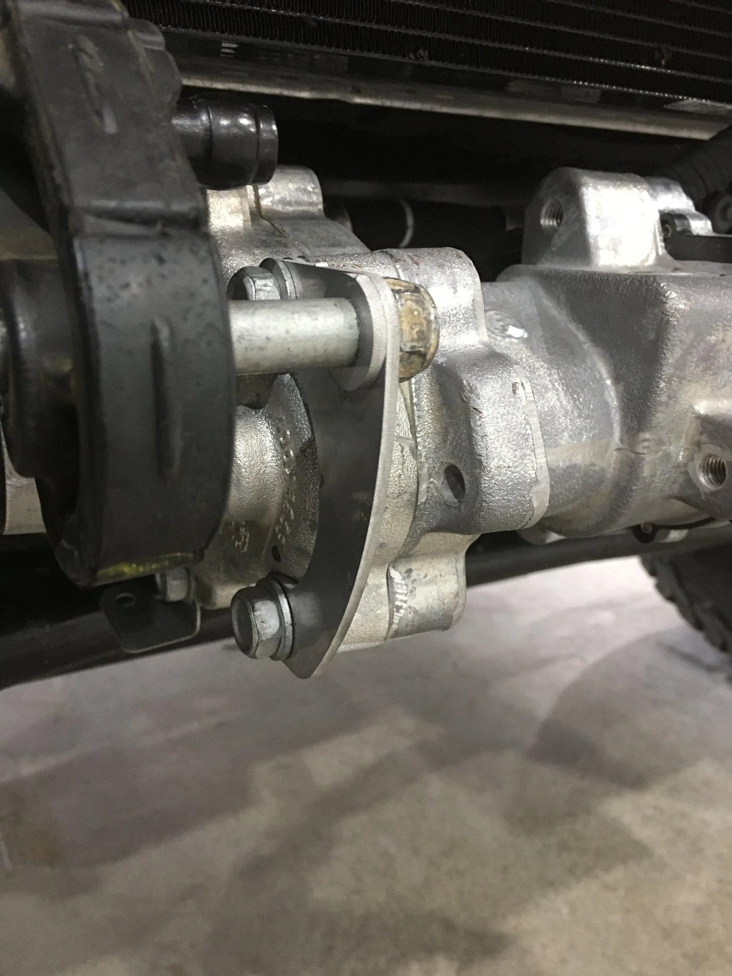

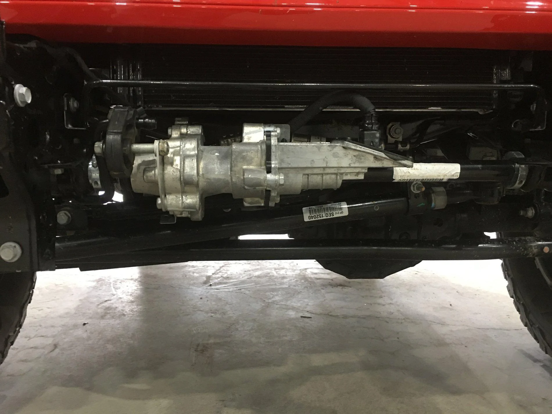

Red Rocket Racings sway bar motor clocking bracket.
Here is a prototype picture of our new bracket that rotates the sway bar motor 90 degrees up wards to increase clearance.
The bracket is made from 3/16 304 stainless steel and will include all hardware and spacers required for install

I wondered if the bracket version (here) had benefits greater than just the Ace bolt.

That bracket would most likely interfere with any aftermarket/stock front bumper. I clocked mine using a bolt from home depot and theres barely enough room with my EVO bumper. Imagine all others are similar or worse. As always YMMV.
