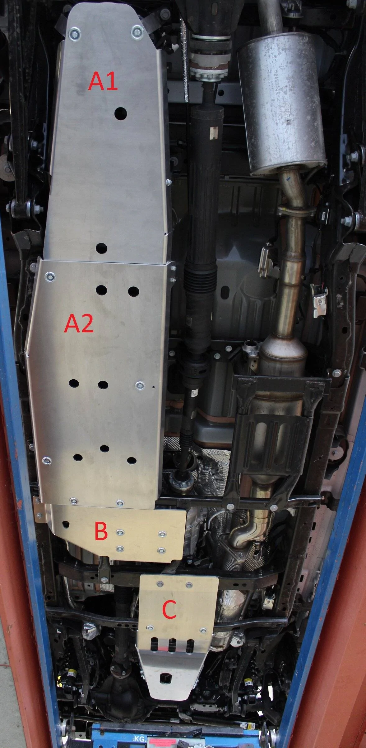

@ASFIR4X4 Any pictures of the full skid install on a 2021 Diesel? also, where are install instructions? looking to see what the install is like compared to the Metalcloak and Motobilt I ran on my last 2 JLs.

Hi J, i've attached a picture of the set installed on a Diesel JT.
A1+A2 are the Fuel Tank skid-plate. It is constructed out of two plates so it can be shipped.
B being the Transfer Case and Fuel Filter plate. And C is the Engine and Gearbox.
Not in the picture but also exists ia the Steering Rod plate for an ASFIR front-bumper.
As for installation instructions, each product have an installation sketch. All of our skid-plates are complete bolt-on and require NO drilling or cutting of the vehicle.

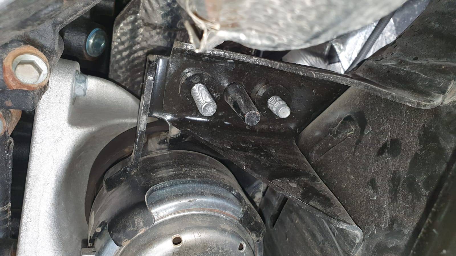

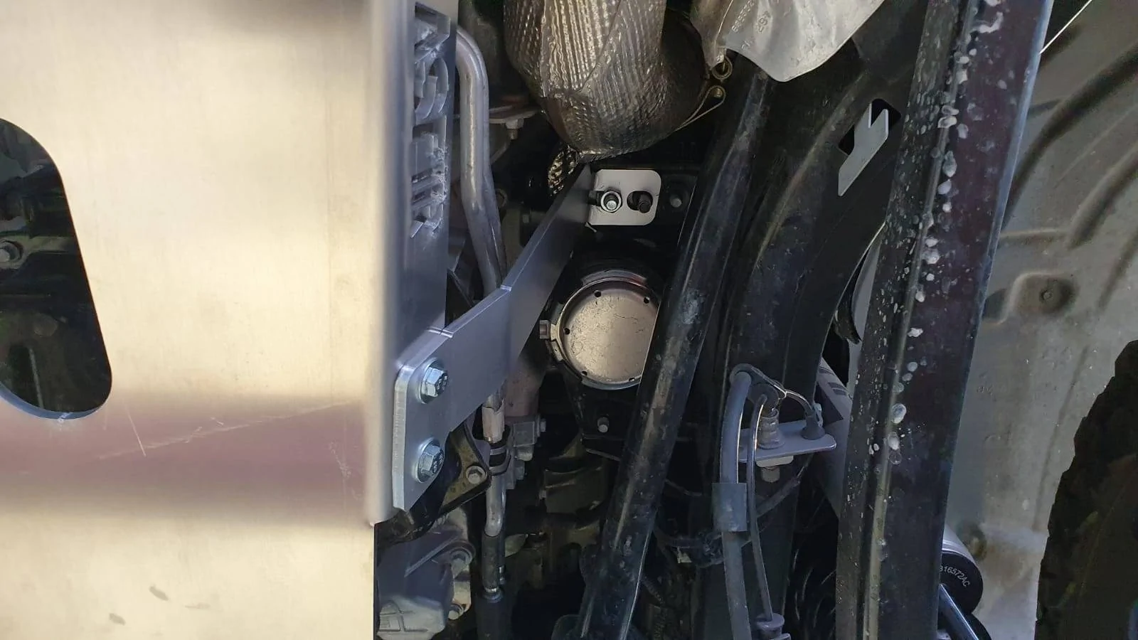

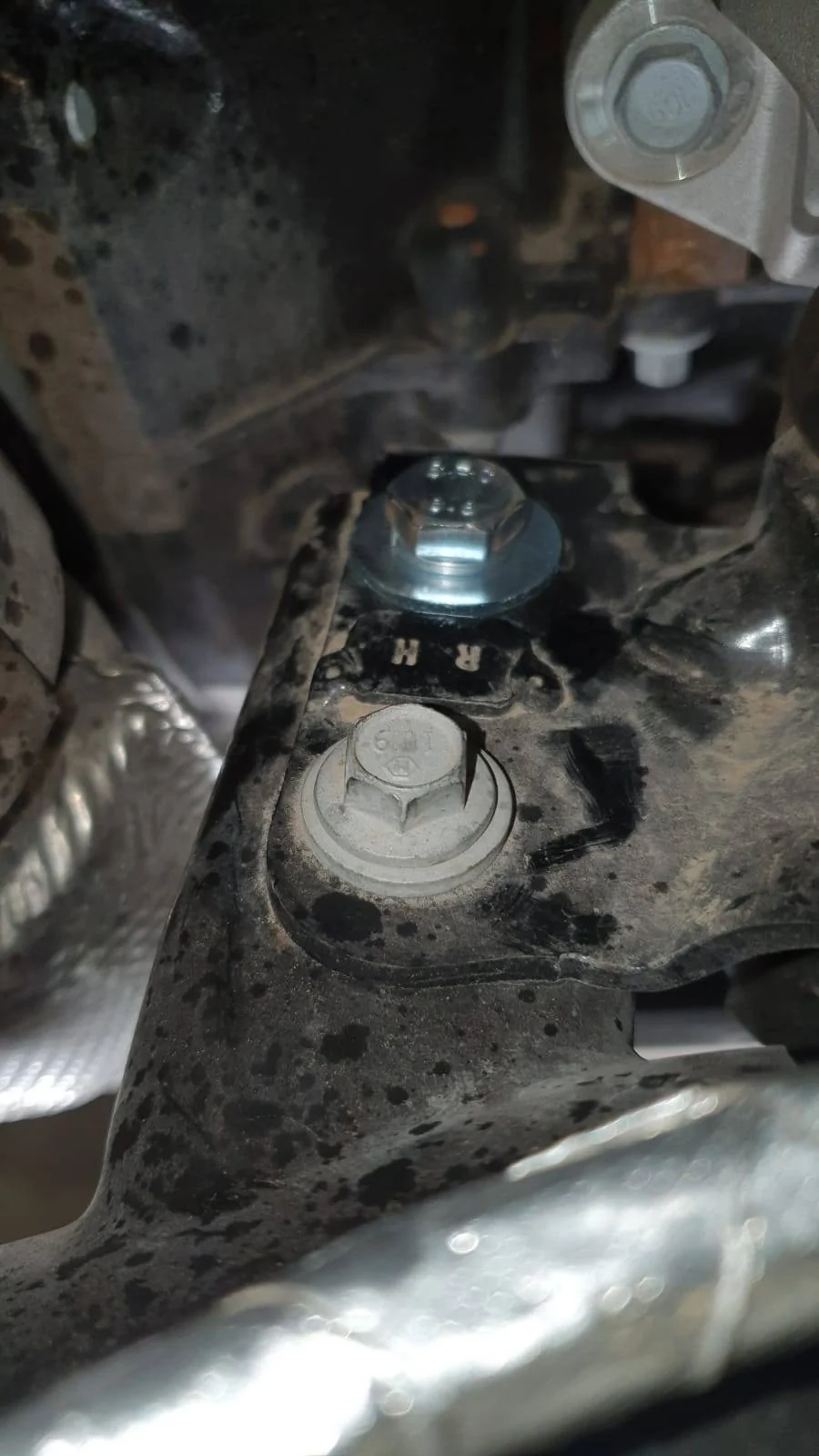

i am looking for the info on how the engine skid mounts. do I need to pull the motor mount bolts to install, or do they mount a dofferemt way up front?
Yes. You'll need to move the plastic flap at the wheel base (see attached video), remove the two bolts (attached pic#1) and exchange it with the bolts we provide. The bracket (connector) should be assembled as shown in pic#2 (atached).
If there's anything else we can help with, please let us know.
