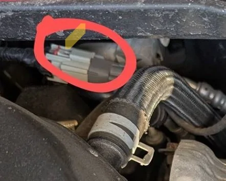

So how do you "release" it? where do you press/push?
Believe this is the connector you are talking about, or at least this style. You pull out the red locking tab. This then lets you depress the gray tab that sits right above the red piece....the piece at the bottom of the yellow markup.
