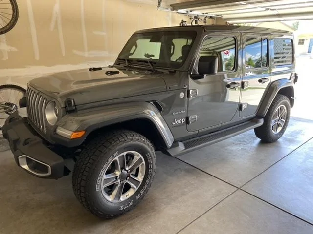

I just picked up my 2020 Sahara a couple weeks ago and put 265/70/18 Cooper at3 4s on there. They fit and look great.

A quick picture with the 265/70/18 tires.
You have any more pictures with this setup? Looking to do the same tires on my Sahara ?
