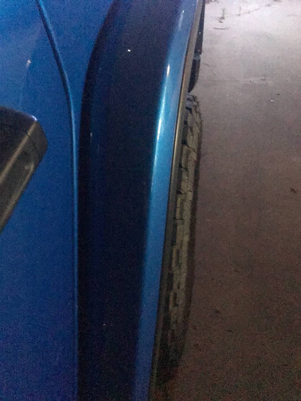

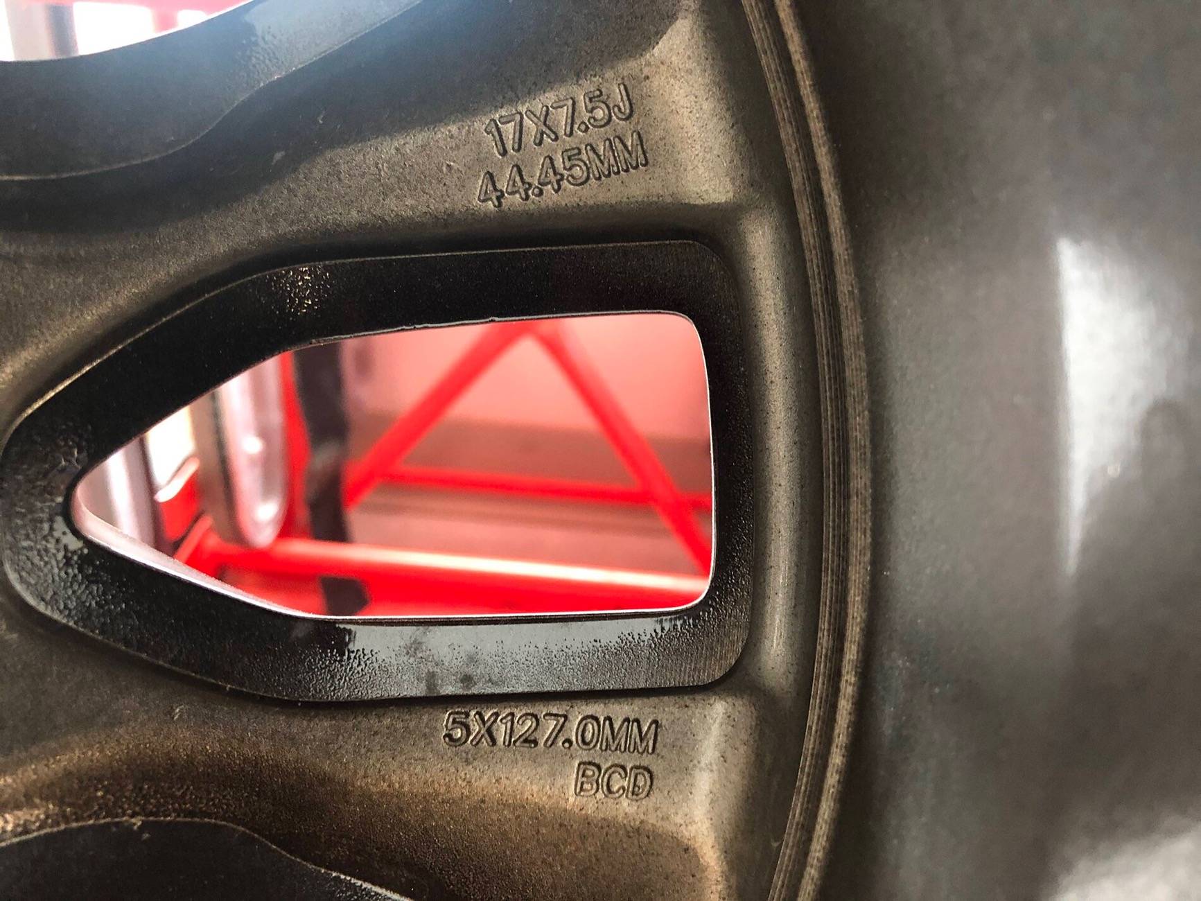

Looking at picking up some 392 wheels for my stock Rubicon. Any fitment issues? Offset? I don't want them poking out. I have 35x12.5 on the stock rims and they fit perfectly now.
XR or non XR ? Non 👇
Jeep Wrangler JL Stock Rubicon Wheels vs. 392 Wheels? 4418DC1F-DF4D-4C26-9DF3-B6966D448220
12.50’s tread is ~ even with Rubi fenders
Jeep Wrangler JL Stock Rubicon Wheels vs. 392 Wheels? 9324BBD0-4DDC-4368-9695-5CC6292932F1
XR 8” 12 or 20mm for ~1 1/4” or 1” more poke. Sorry I don’t know which.
no fitment issues, but DT insisted they R&R the trim rings unnecessarily, but they didn’t charge extra- some do, some don’t remove them inconsistencies. The Bronze faded to nearly gray in 3 years, and they are 31 lbs. ….. replaced with 8.5” -1mm 21 lb Bronze non beadlock capable.
