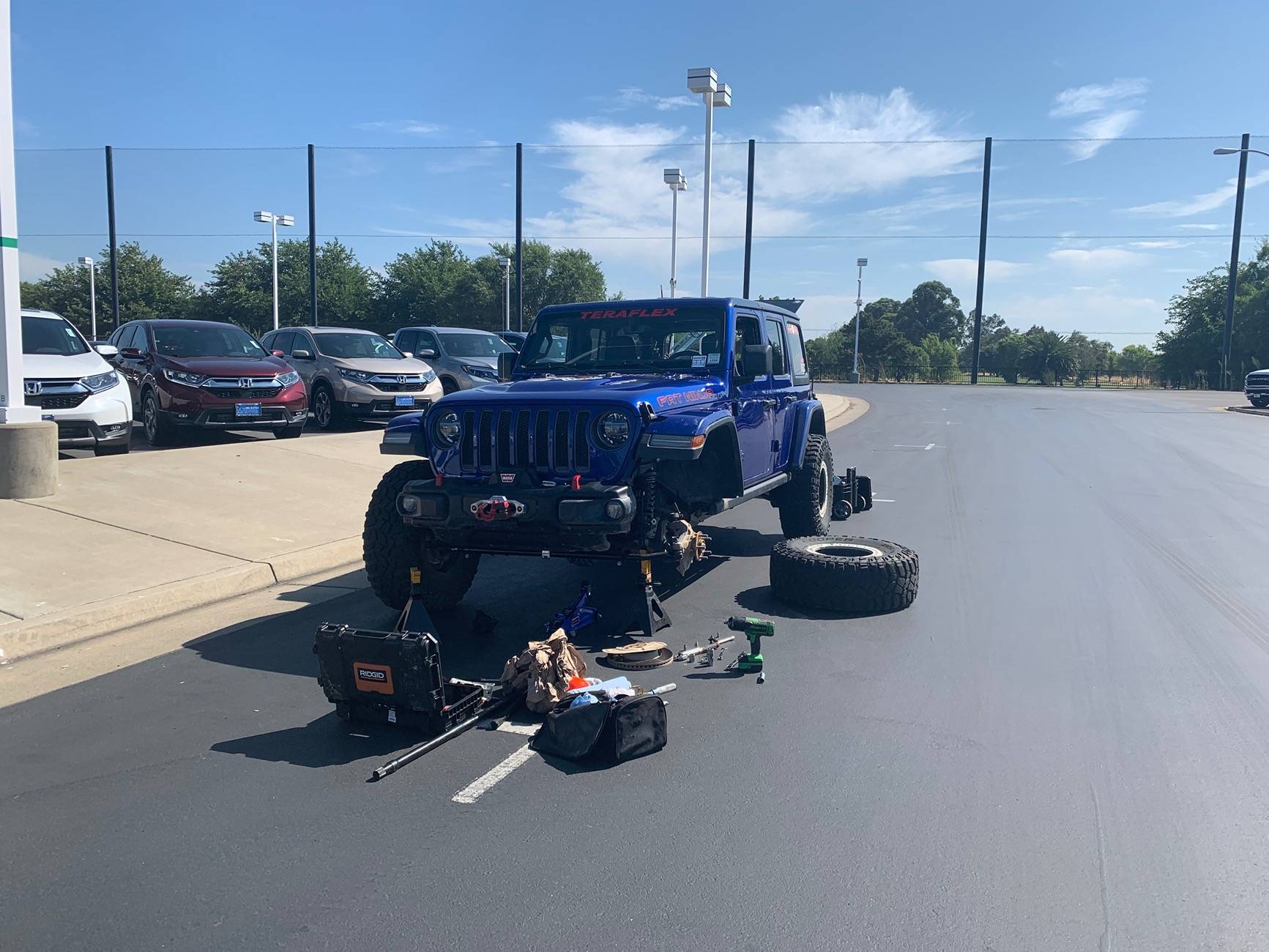

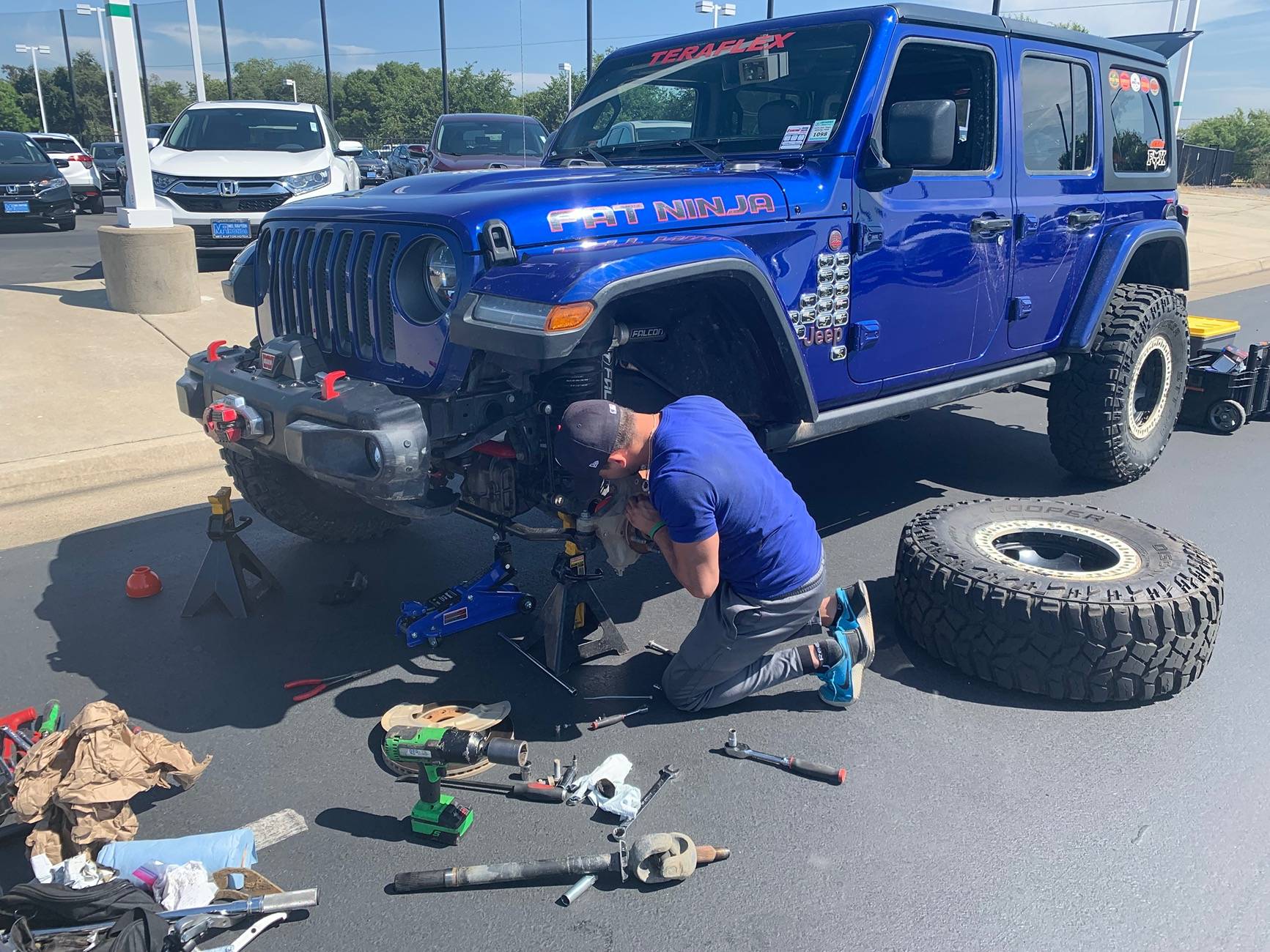

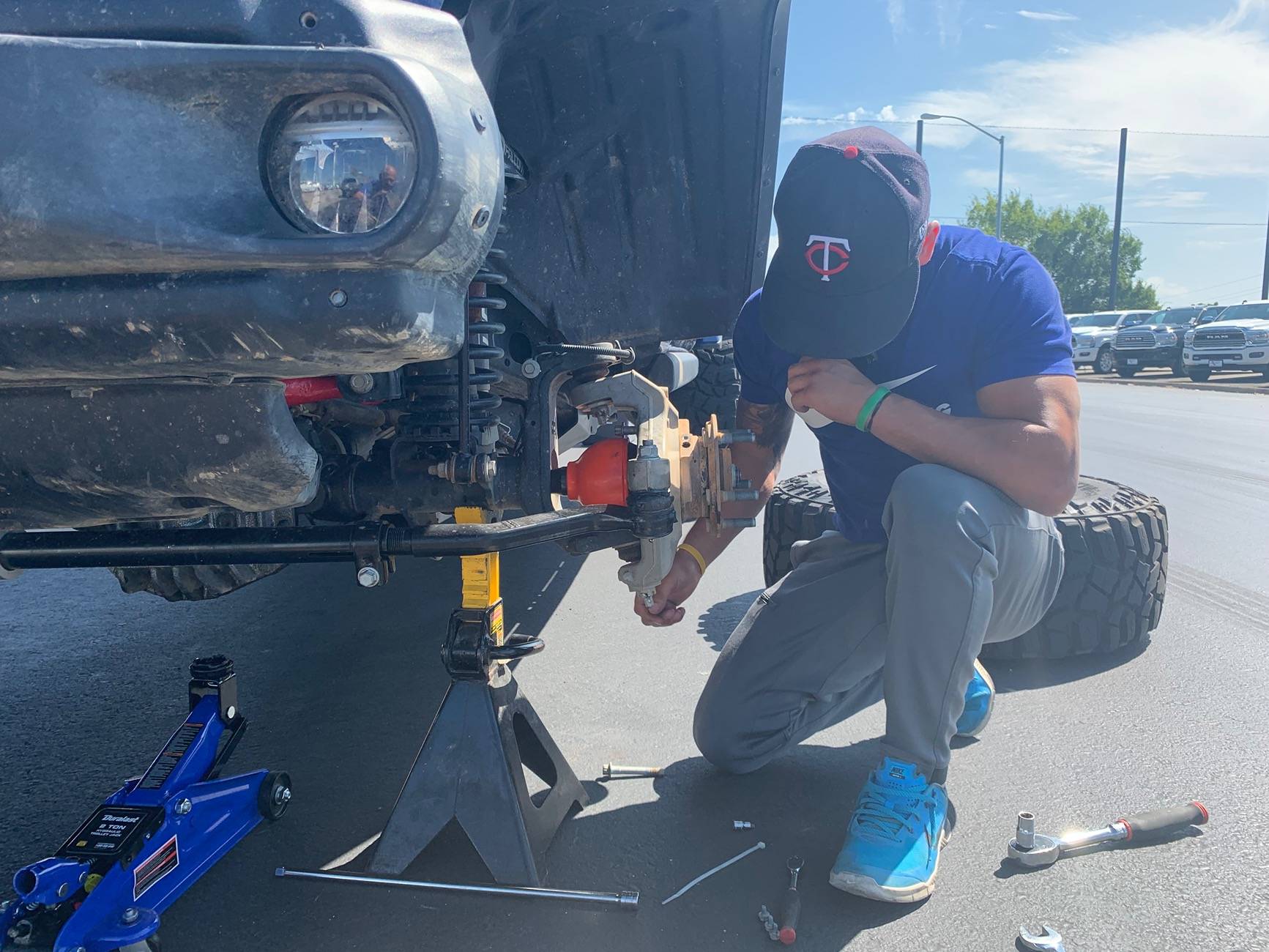

My brother and I installing RCV’s in the street next to a Jeep dealer. This was in CA the day before running the Rubicon. lol. Had the shafts shipped to our hotel and then got to work.
Man… this was almost 6 years ago already. Wtf. lol.
