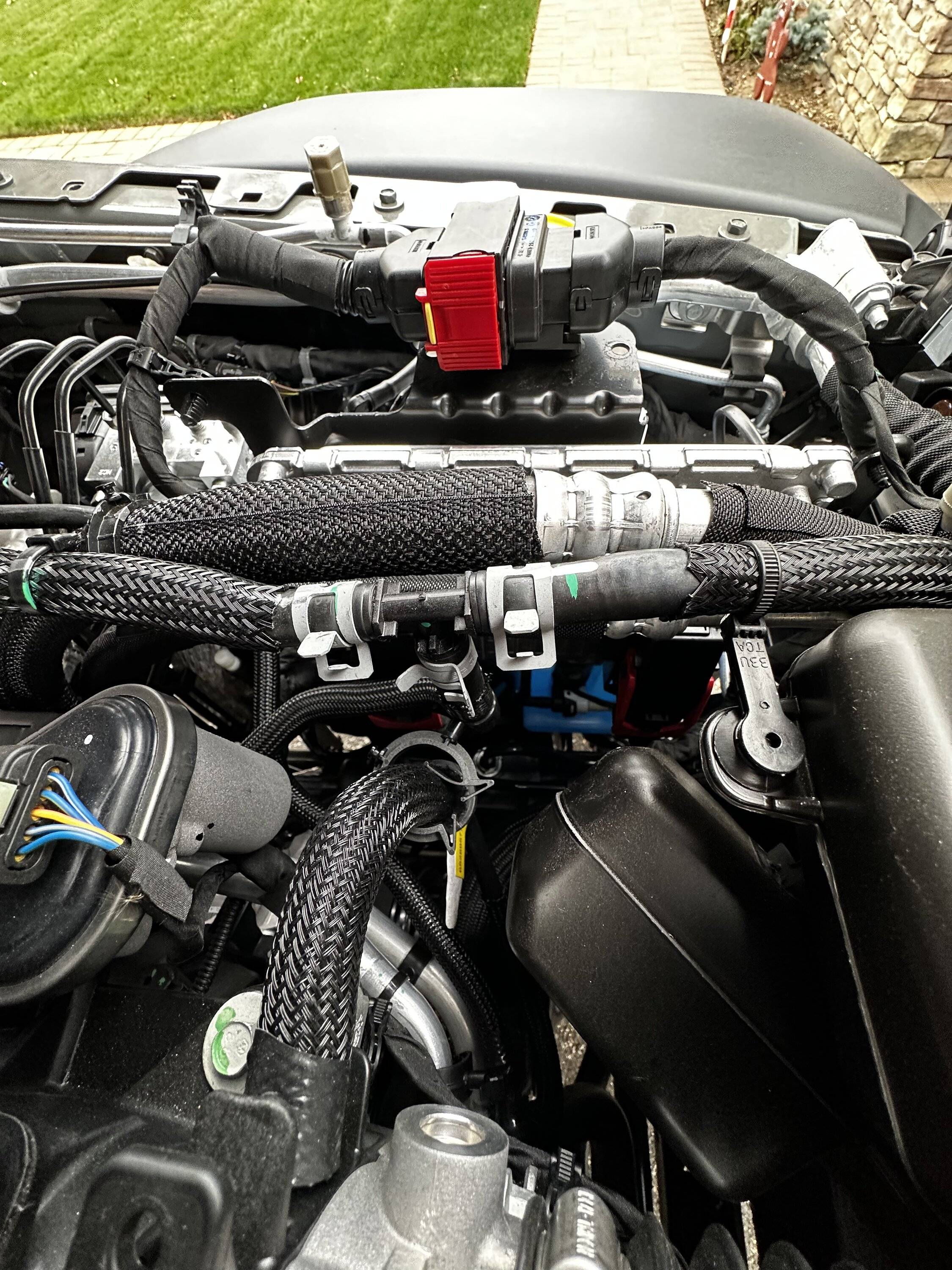

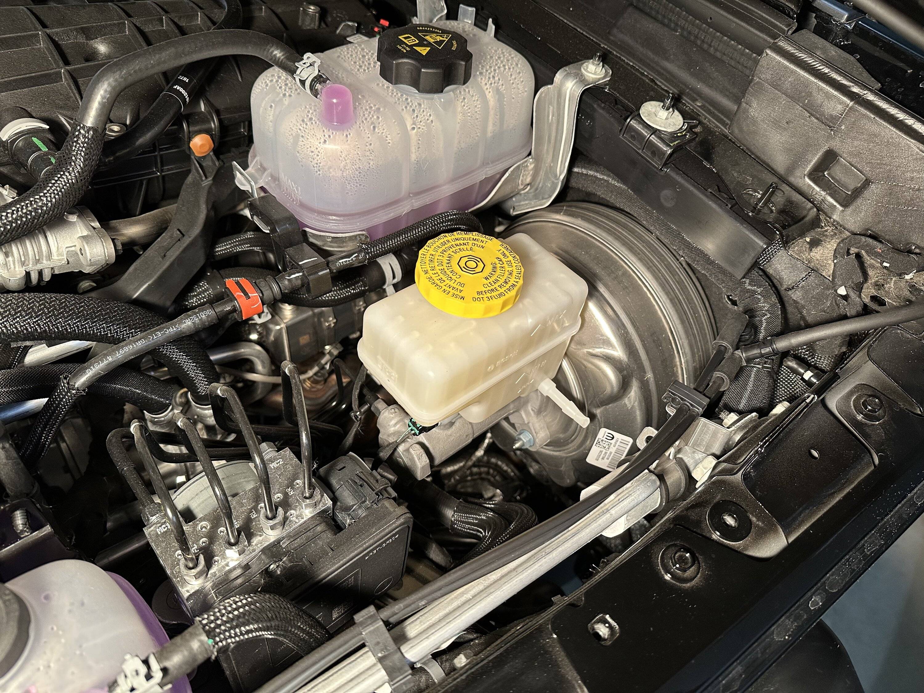

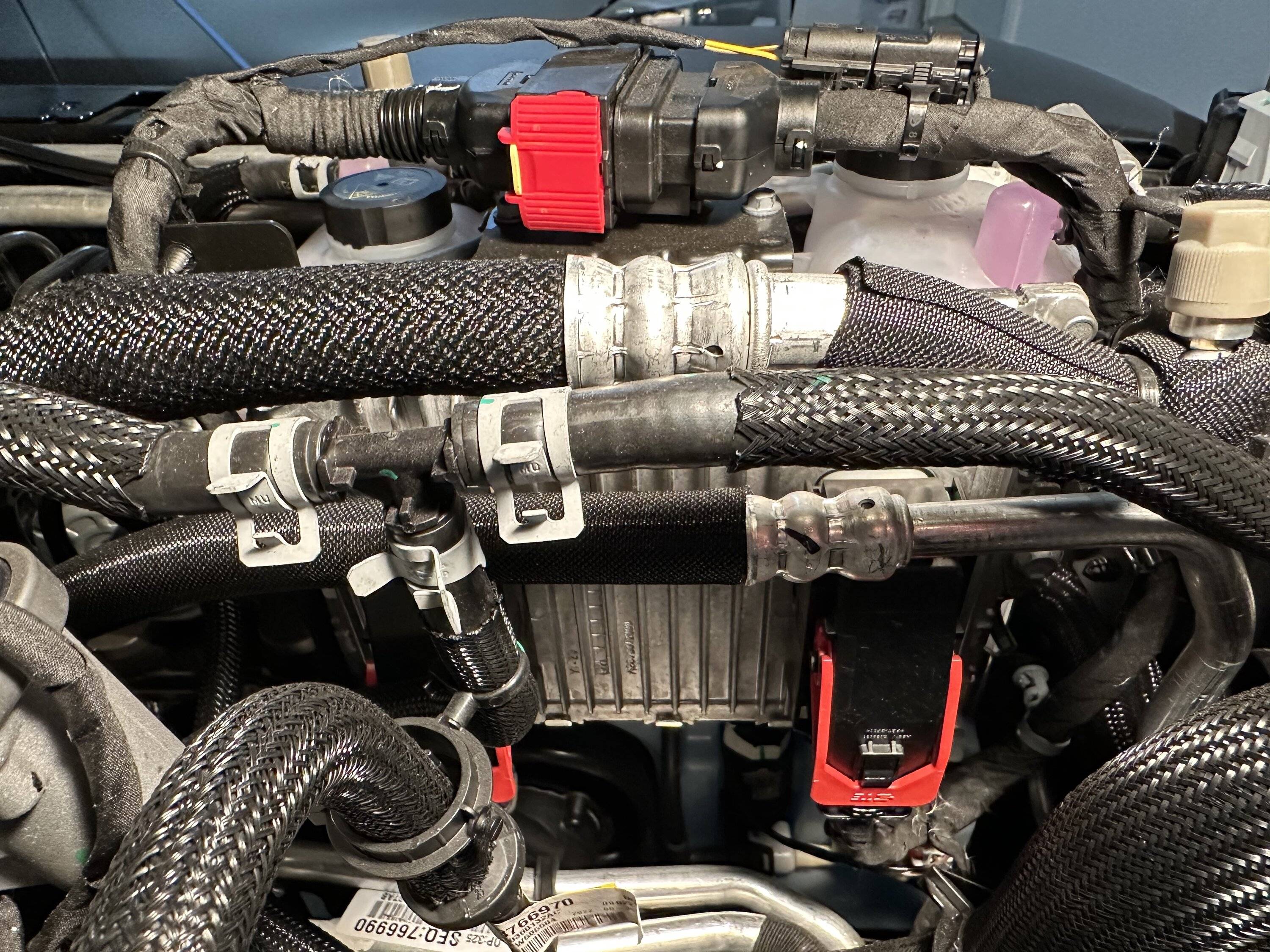

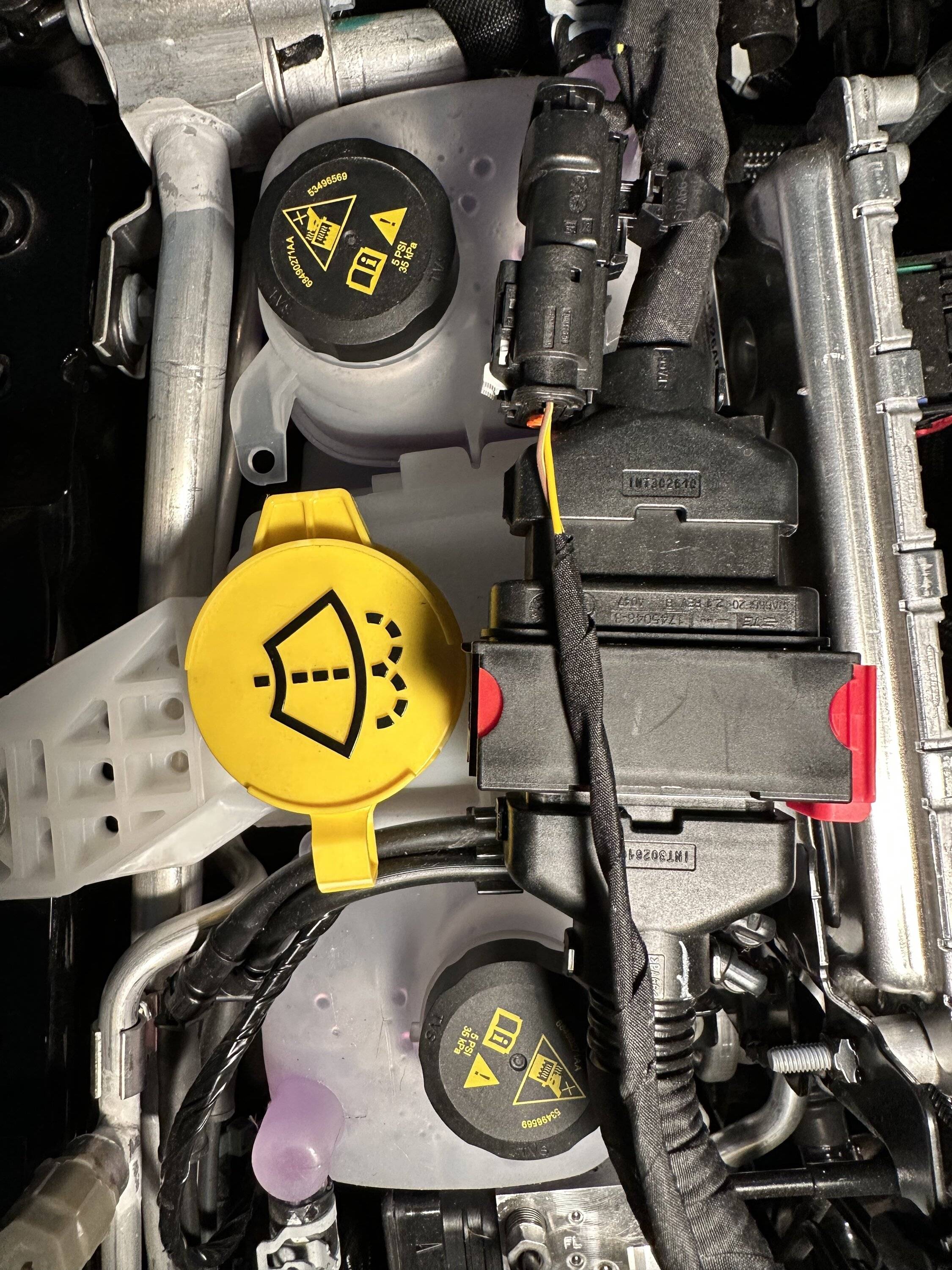

Don't know if these help any, I can get you the 8.4 screen a little later after the wife is done yelling at me as it's dinner time.... LOL
Jeep Wrangler JL Stock Hardtop and Front Camera Washers IMG_7439
Jeep Wrangler JL Stock Hardtop and Front Camera Washers IMG_7440
Jeep Wrangler JL Stock Hardtop and Front Camera Washers IMG_7441

hey! thanks for the pics! so I need to see how all 3 hoses are connected to the pump which is on the bottom side of the reservoir (it's hard to see from the top -I'll take a pic tomorrow and put it up to show the angle from which it can be seen)
does your windshield or rear washer work together with the front camera washer? I doubt the windshield works together with the rear as there's options to activate each at the steering wheel handles.
Thanks!

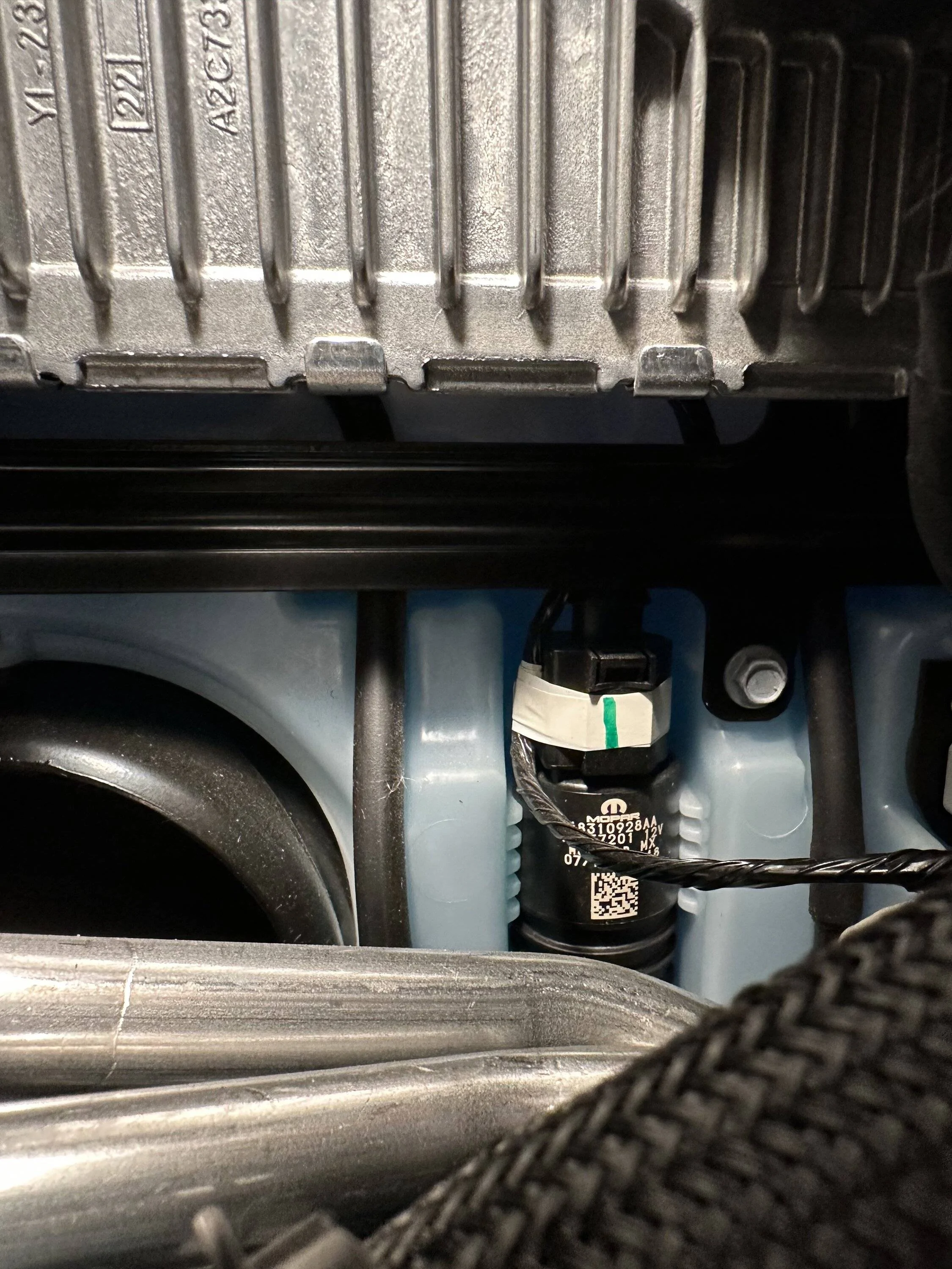

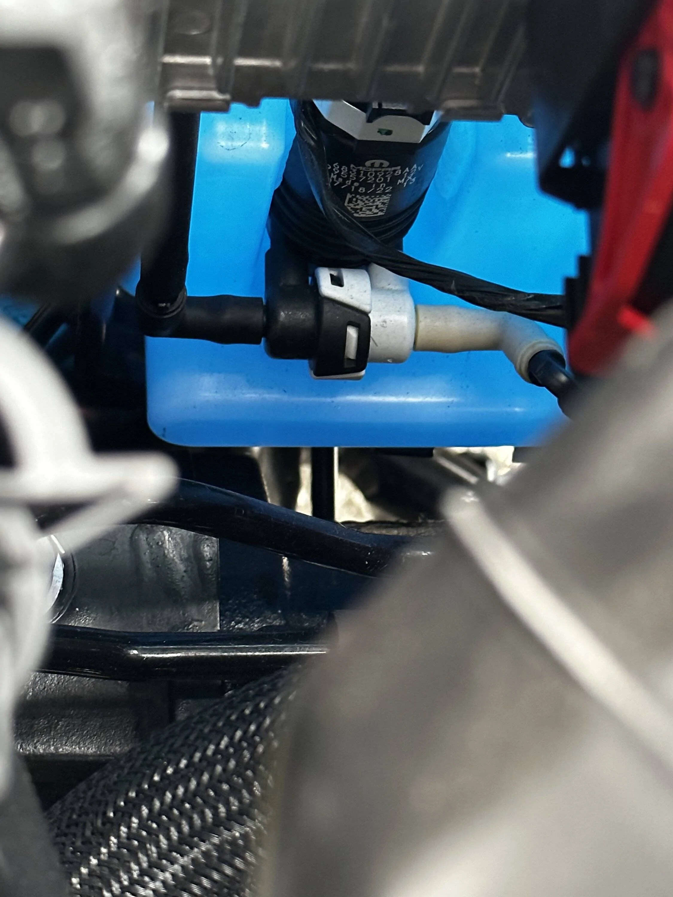

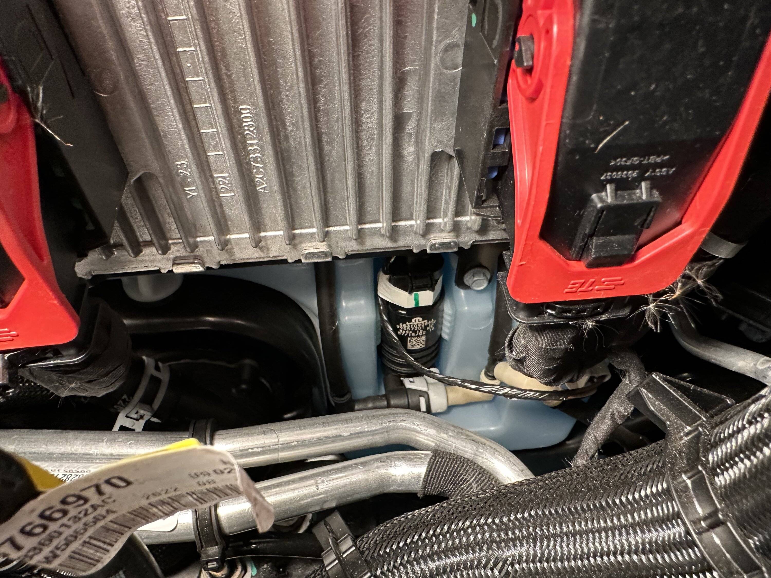

hey so do you mind getting pics like these:
Jeep Wrangler JL Stock Hardtop and Front Camera Washers 9450FD80-947F-4AC3-9086-2201F925A203
Jeep Wrangler JL Stock Hardtop and Front Camera Washers 3A0E44F7-5806-4E5F-9413-4D926A9A4C23
Jeep Wrangler JL Stock Hardtop and Front Camera Washers 5D67618C-EA0B-4AC4-B62E-05CEBD48F20A

thank you! so i'll put a Y fitting on that side for the rear washer then
No pictures but the camera washer is tied to the rear window washer. I guess that made 100% sense to a Jeep engineer.

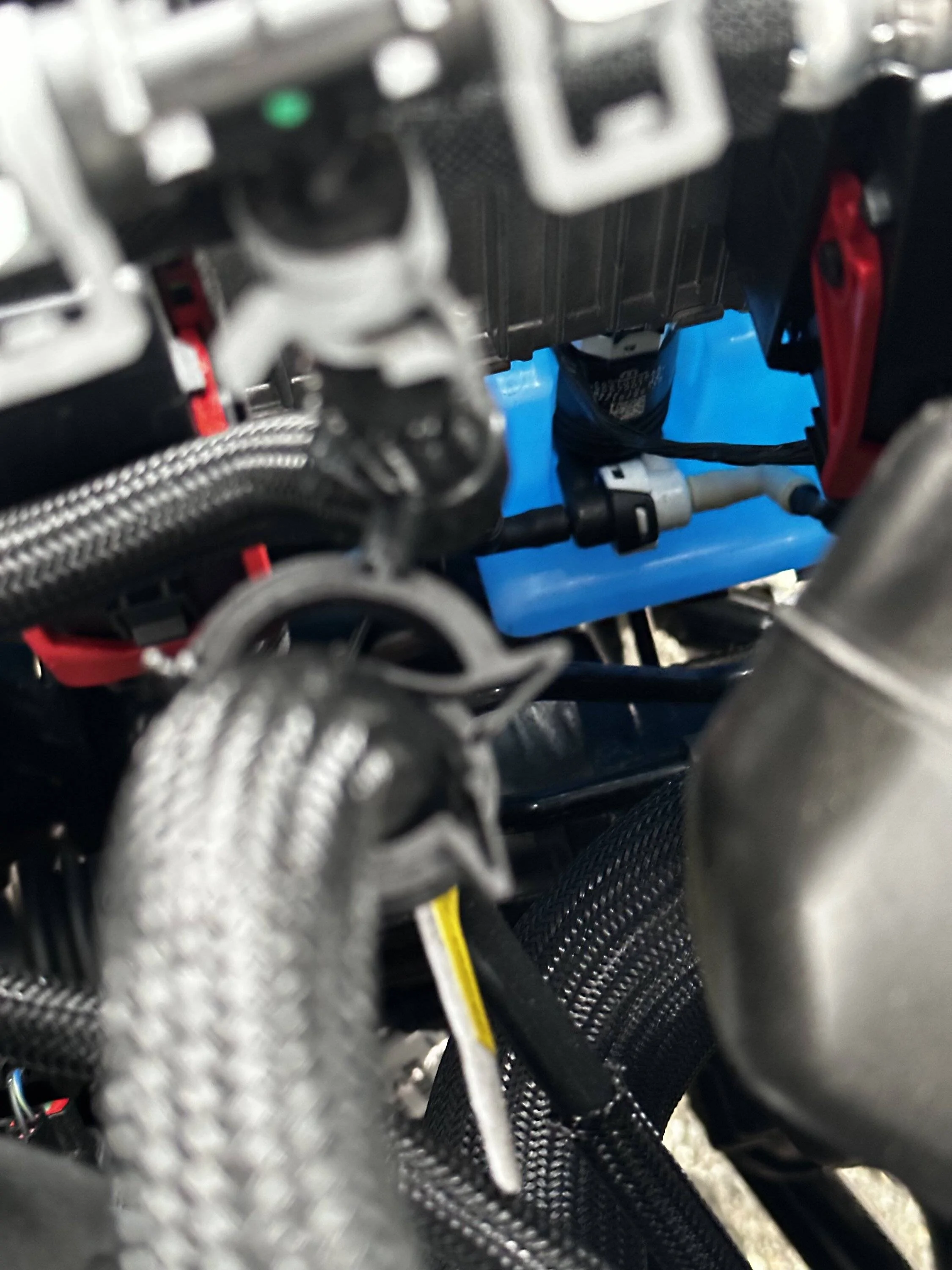

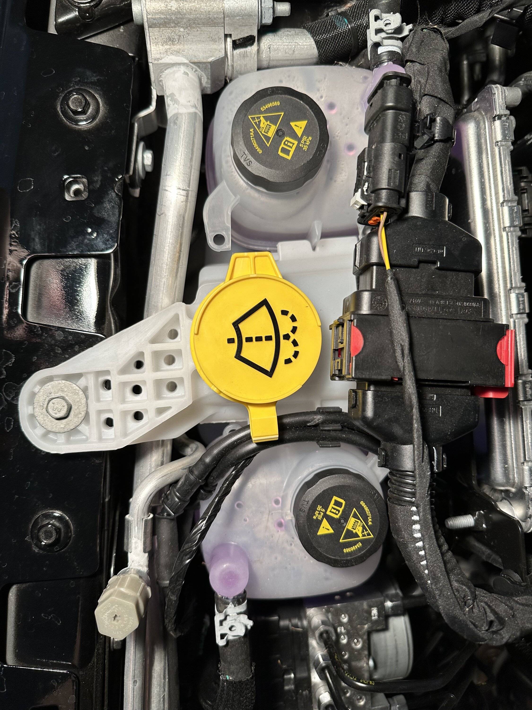

Sorry for the delay, been crazy busy with work, plus this is my first Jeep (2 weeks old) so I'm still learning... :) If you need something different, please let me know, I just grabbed these quick before dinner...
Jeep Wrangler JL Stock Hardtop and Front Camera Washers IMG_7464
Jeep Wrangler JL Stock Hardtop and Front Camera Washers IMG_7465
Jeep Wrangler JL Stock Hardtop and Front Camera Washers IMG_7467

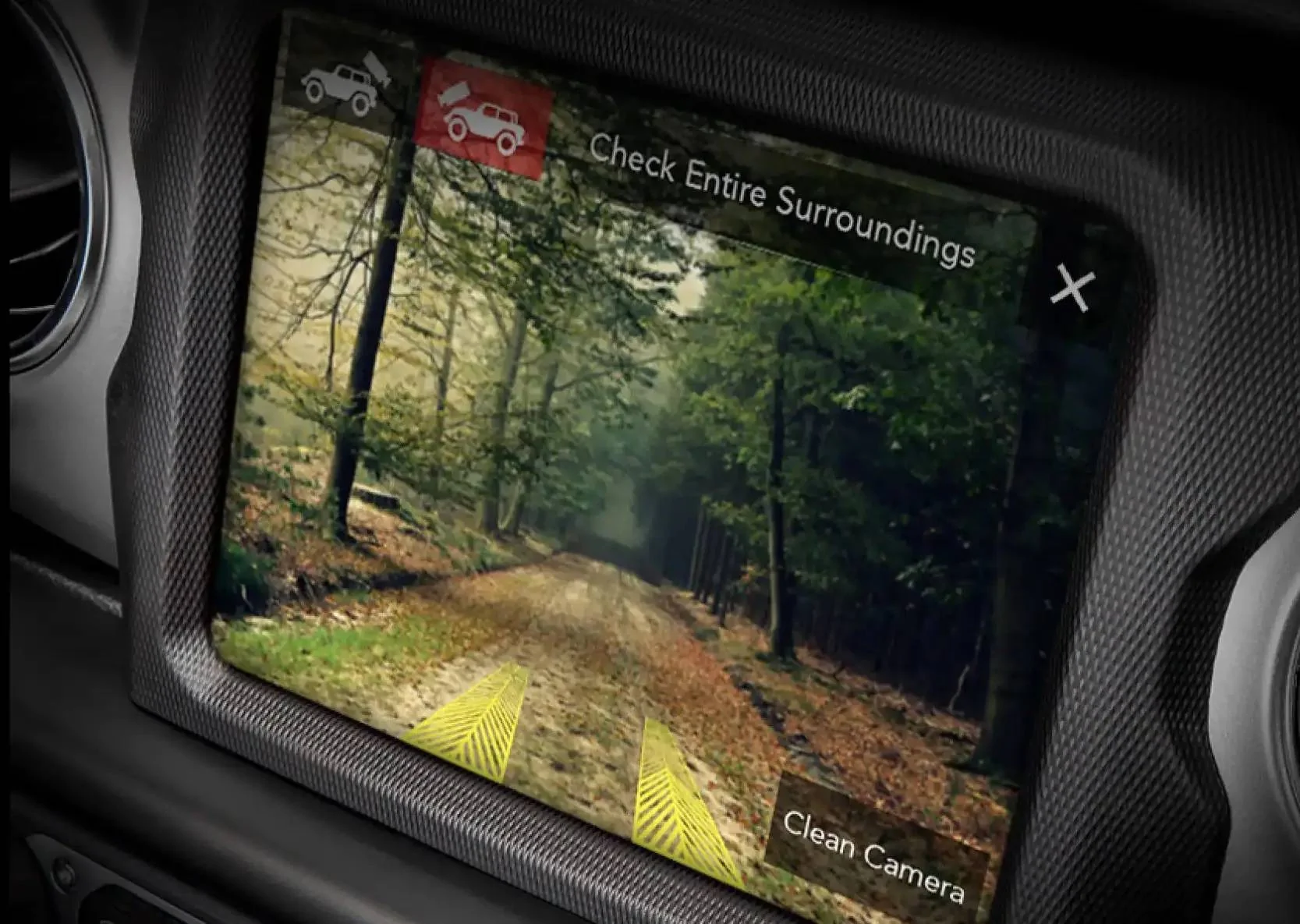

I didn't have the key with me to turn on the display, but from what I've seen so far, is that from the backup camera screen (which appears to be the same screen for the front display) that in the top left hand corner, there are two on-screen buttons, one for the Rear view and one for the Front view that you can press and display either Front or Rear.
Along with that, in the lower right hand corner of the same screen, there appears to be an on-screen button to wash the Front camera, but to be honest, I've not yet had a chance to play with it.
Jeep Wrangler JL Stock Hardtop and Front Camera Washers Jeep Front Camera
Hope this helps some.... :)
