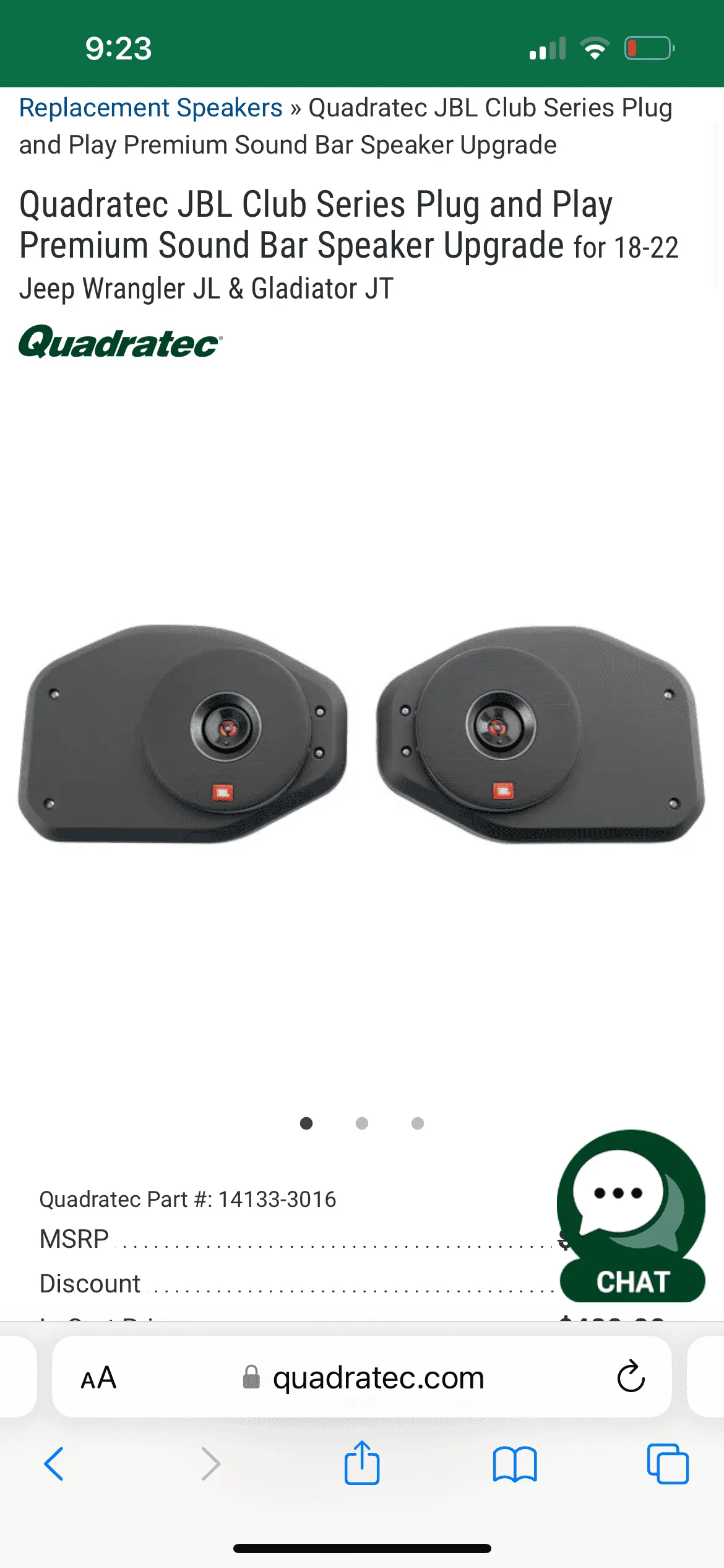

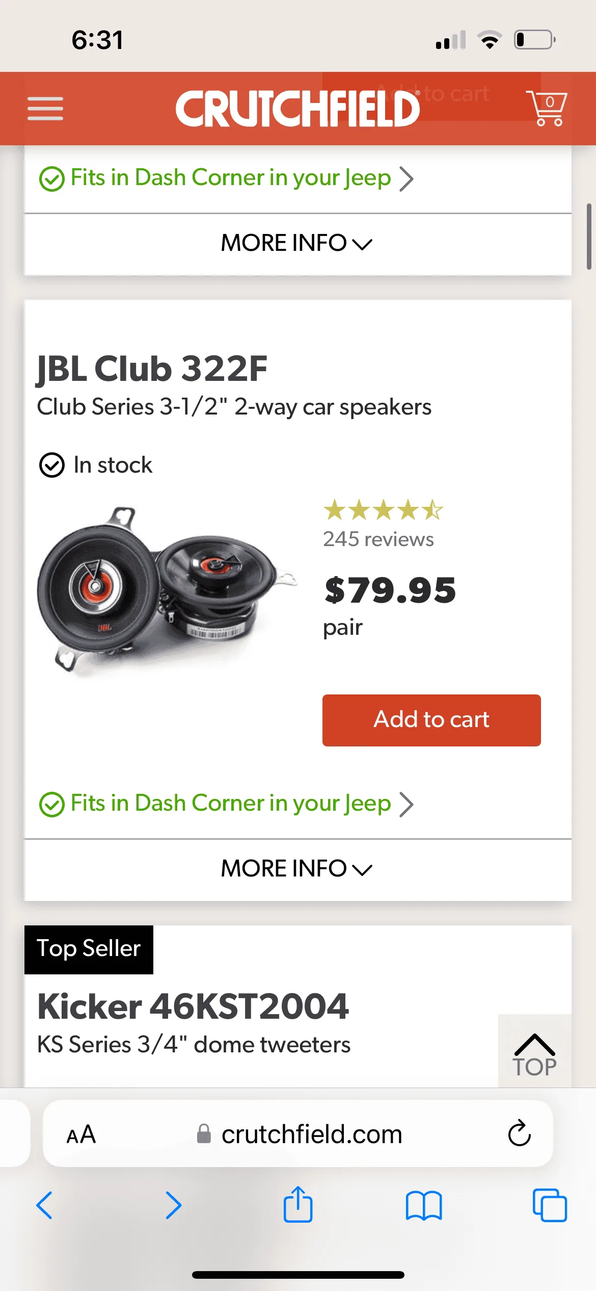

I've had good luck with the JBL’s in my Jeep. But I don't listen to it super loud very often. I'm not sure if that is the difference or not.
Is this what you’re running?
No I'm running the GX328 set in the dash. Got them pretty cheap on Amazon. I liked them better on paper than the 322F you linked.
