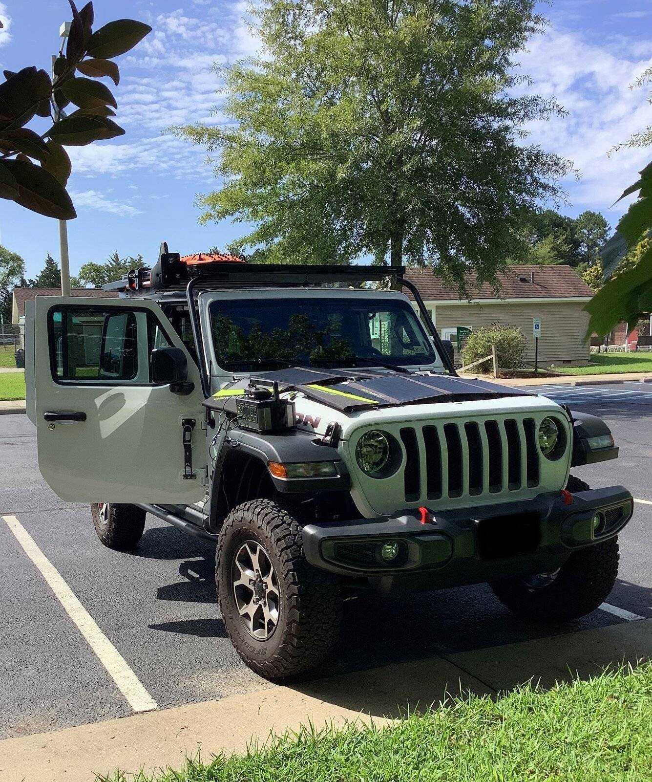

I have a 2020 JLUR 4-door v.3.6 AUTO with MOPAR lift at dealer. The steering was a bit "JEEPY" from the beginning to about 1300 miles. While I was at the dealer, a really knowledgeable parts department guy and I struck up a conversation about my steering. He told me 99.9% of the steering issues on my specific model are fixed with a computer software upgrade. HE ran back to the service department and told them to (it was free) to do the software upgrade. I drove the JEEP and { BIG SMILE } I couldn't believe the difference. Drives really sweet now! Now, that was service.
