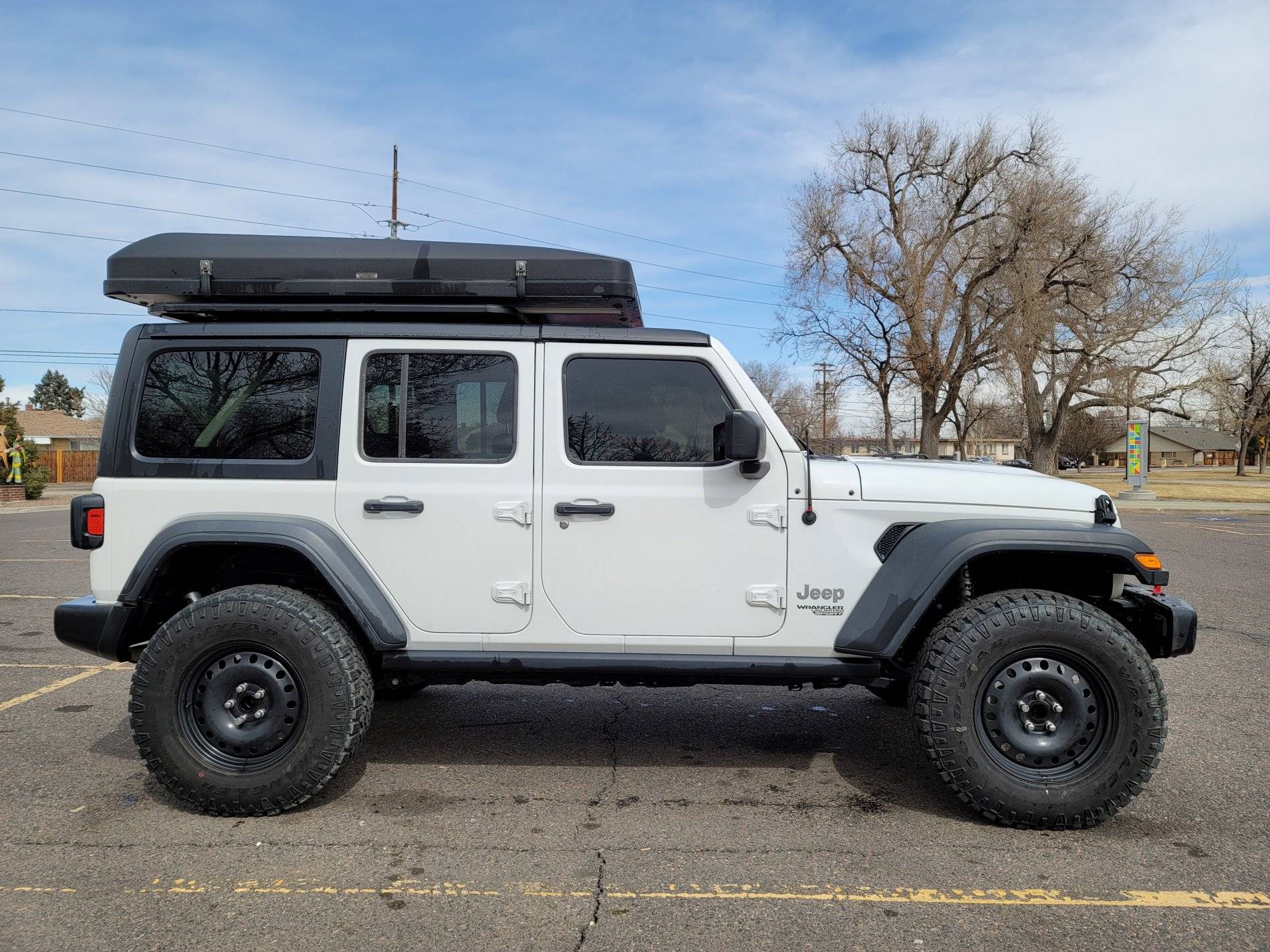

I think I'm going to buy some of these rugged ridge trail runner classics. They're a 17x9 with 0 offset (4.5'' backspace) @ 33lbs each. Not too bad...

How did they work out? Any photos?

No never purchased these, I've been on stock wheels for 55k miles now with synergy spacers. Perfect poke imo and never had an issue with 37x12.5's. I haven't seen a need to use anything else. I still like those steel wheels but knowing what I know now I would just buy some second hand. I've had the stock wheels on a 37x12.5 down to 12psi with no issues and that's been fine with me.
