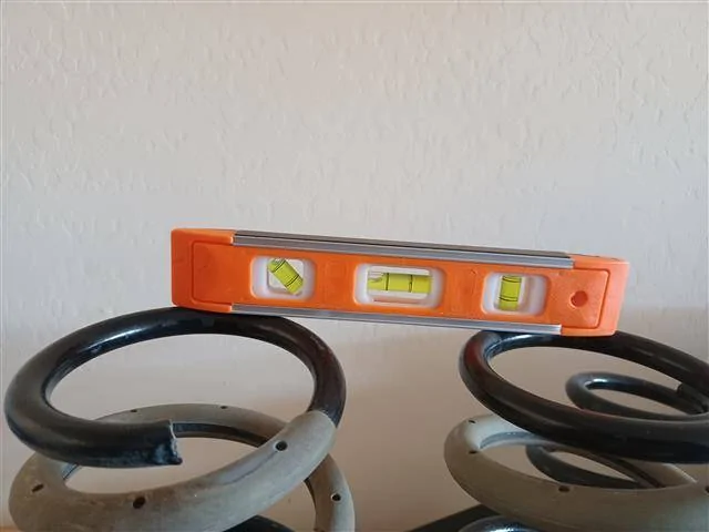

My willy's springs
68253658AD Drivers Front
68253659AD Passengers Front
68253587AA Drivers. Rear
68253588AA Passengers Rear
The rubi springs i picked up:
XXXX LF (tag missing)
3662 RF
3592 RR
3597 LR
Best guess is the untagged spring is a 3661AA (usually paired with 3662)
Jeep Wrangler JL Spring Question spring 1

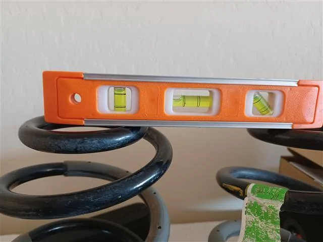

the second pic (below are the 3592 & 3597). If the rule of thumb (from somewhere on this site is correct) each number up = approx 1/3 of an inch, it is just my belief that I do not want to pair the 3597 & 3592 of my Willy's which does not have the steel bumpers and towing and the heavier 700cca battery etc.
Jeep Wrangler JL Spring Question spring 2
to my knowledge the 3592 on the passenger side rear, 3591 driver's side rear, 3662 passengar side front, and XXXX(untagged but probably 3661) driver's side front. That is why i only wanted a single 3591 spring.
