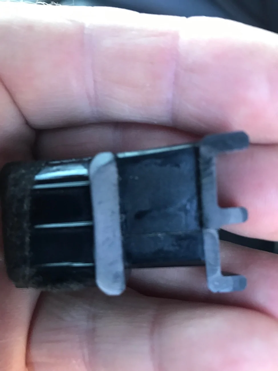

When mine stuck “obstacle” it was the broken plastic track end of a crossbar. I cleared the broken pieces and it closed. That’s the good news. Well, here’s the bad news , $1,730 for
Jeep Wrangler JL Sky One-Touch Top Replacement IMG_2467
one two bar crossbar track end, nearly all labor to remove, disassemble to weave in the new one and reinstall. … max care covered minus $100 deductible. This Time, 3 years 2 months coverage left. Replacing the whole top if possible is likely cheaper considering labor, homework required.

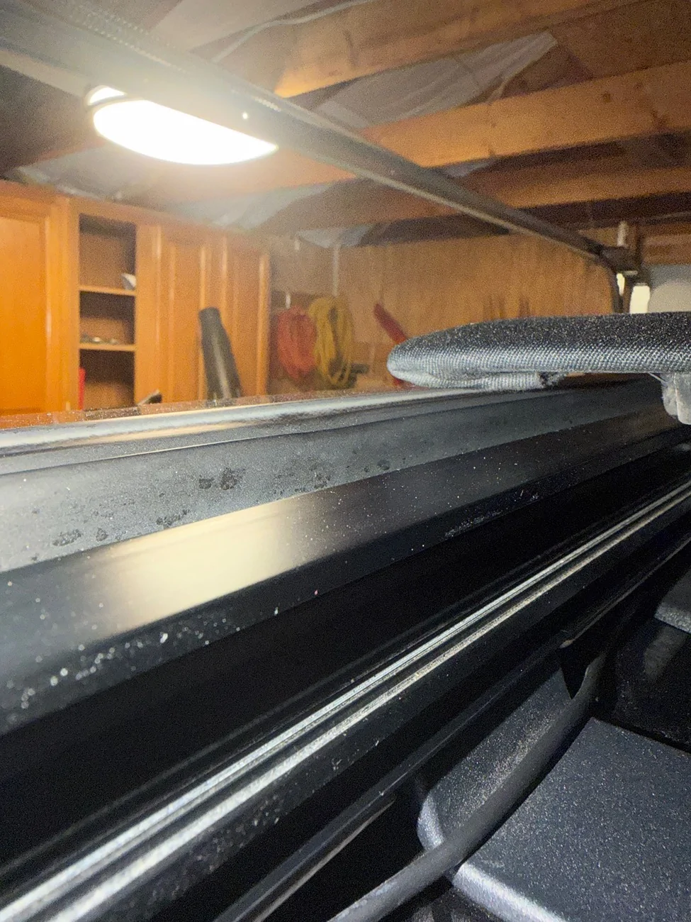

@2nd 392 could you tell me where that piece is located exactly on the top? I don’t see it right away and there are no pieces that have broken&fallen to the floor.
Also here is a picture of some damage that I have discovered. How this happened, I have absolutely no clue.
Earlier in the day I spent well over 5 hours cleaning the inside (shampooing the seats, vacuuming, detailing the entire inside, top open to get all the spaces between the top and inside), washing the entire outside of the vehicle, washing the tires and wheels next, to drying off, to trim work, to tire and wheel work. No problems. Did some running around town, maybe an hours worth of driving with the top back (max speed limit in town is 45mpg (I did max 48mph). Then when I go to close I heard the sound d, got the obstacle message and that’s that.

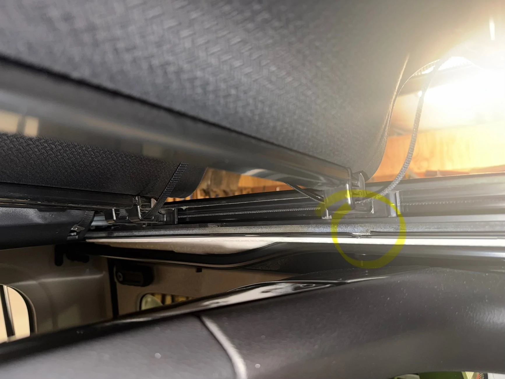

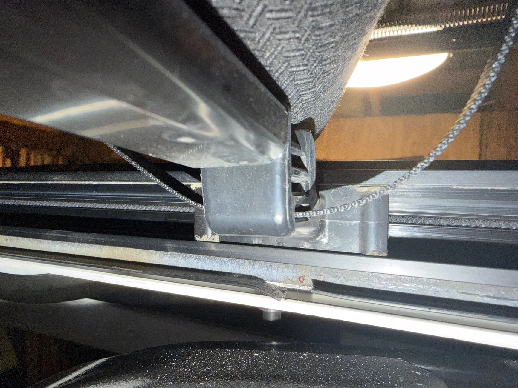

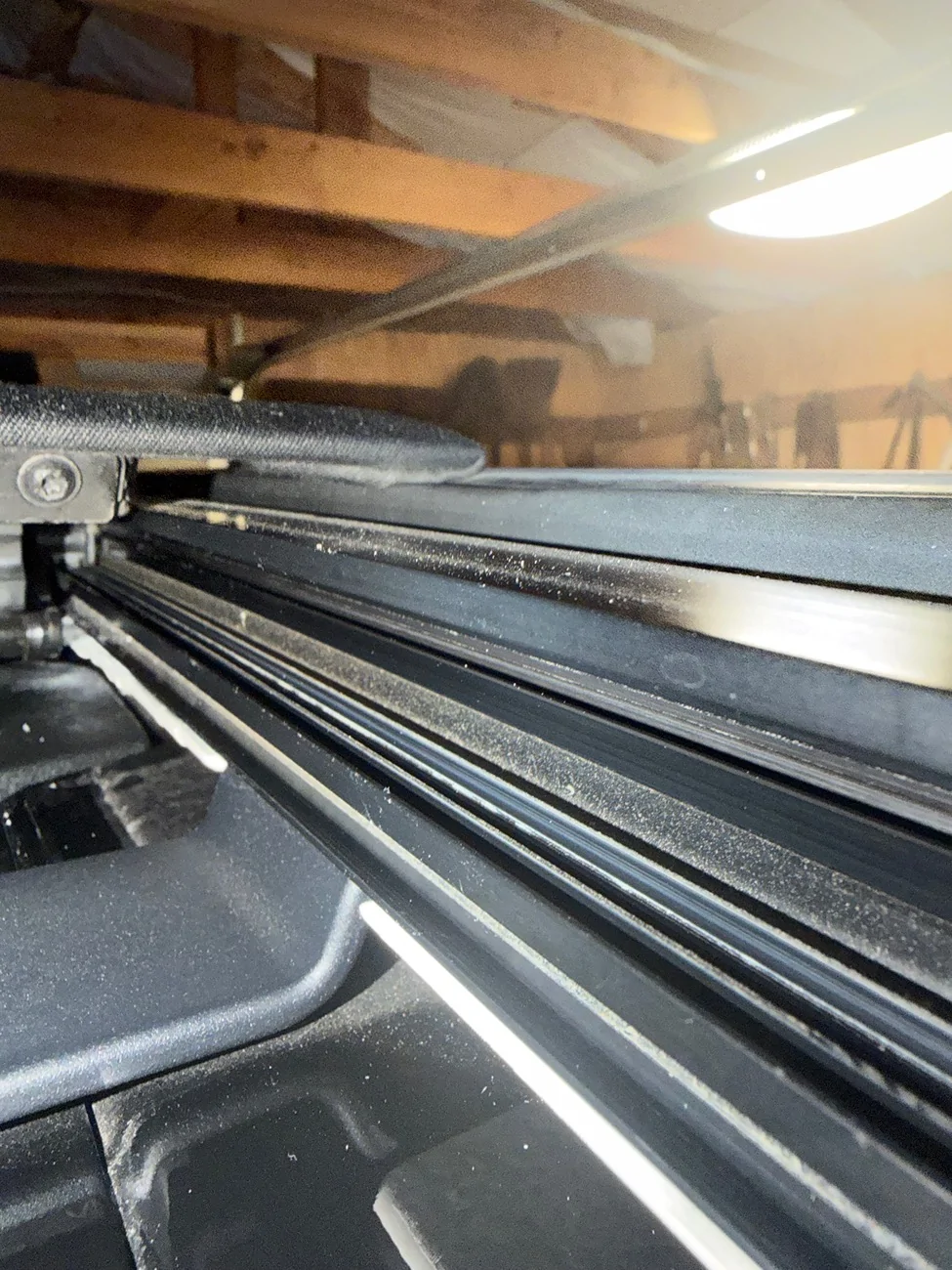

I have also just noticed that when looking straight down to the rear of the jeep, the top on the left is raised from the frame, on the right, it looks pressed down. So it is off track somewhere but I can’t see where.
I really just need to get it to where I can get it closed and latched/secured, u til I can figure out what I’m going to do because this is a price tag I just don’t have right now

@scottcox1105 - the crossbars are in two bar sections. The leading one runs on the tracks, the other folds up. That piece is from the track bar end over the passenger side rear seat. .. The top was never hit from either the top or bottom to my knowledge, it was only through a brushed car wash it’s first wash. It was being opened at ~30 mph. My only wild guess possibility is the high powered blow dryer at the hand wash then brushless tunnel used.
The rest of that broken piece was on the floor, but the top wouldn’t close until it was spotted and removed from the track.
