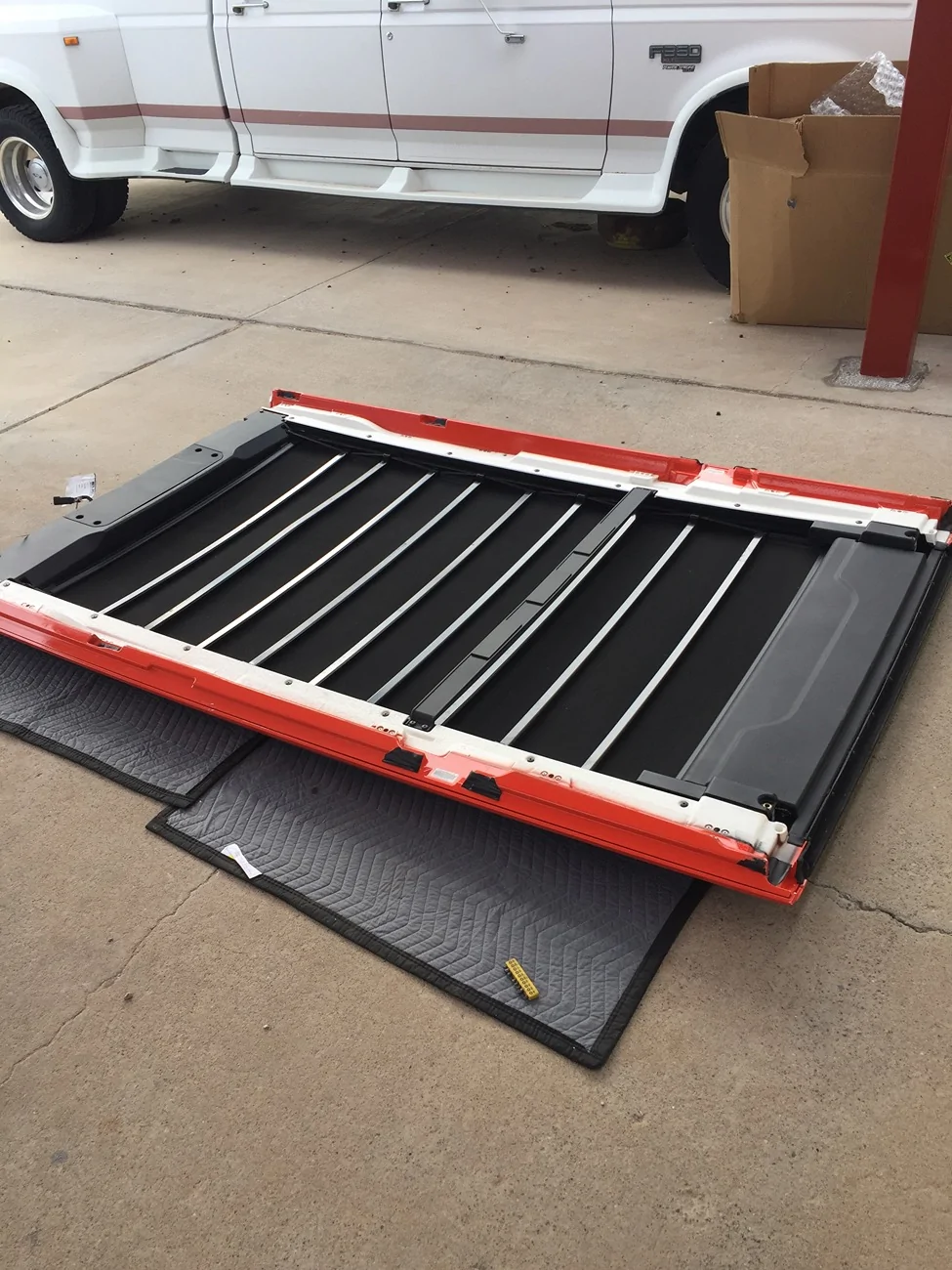

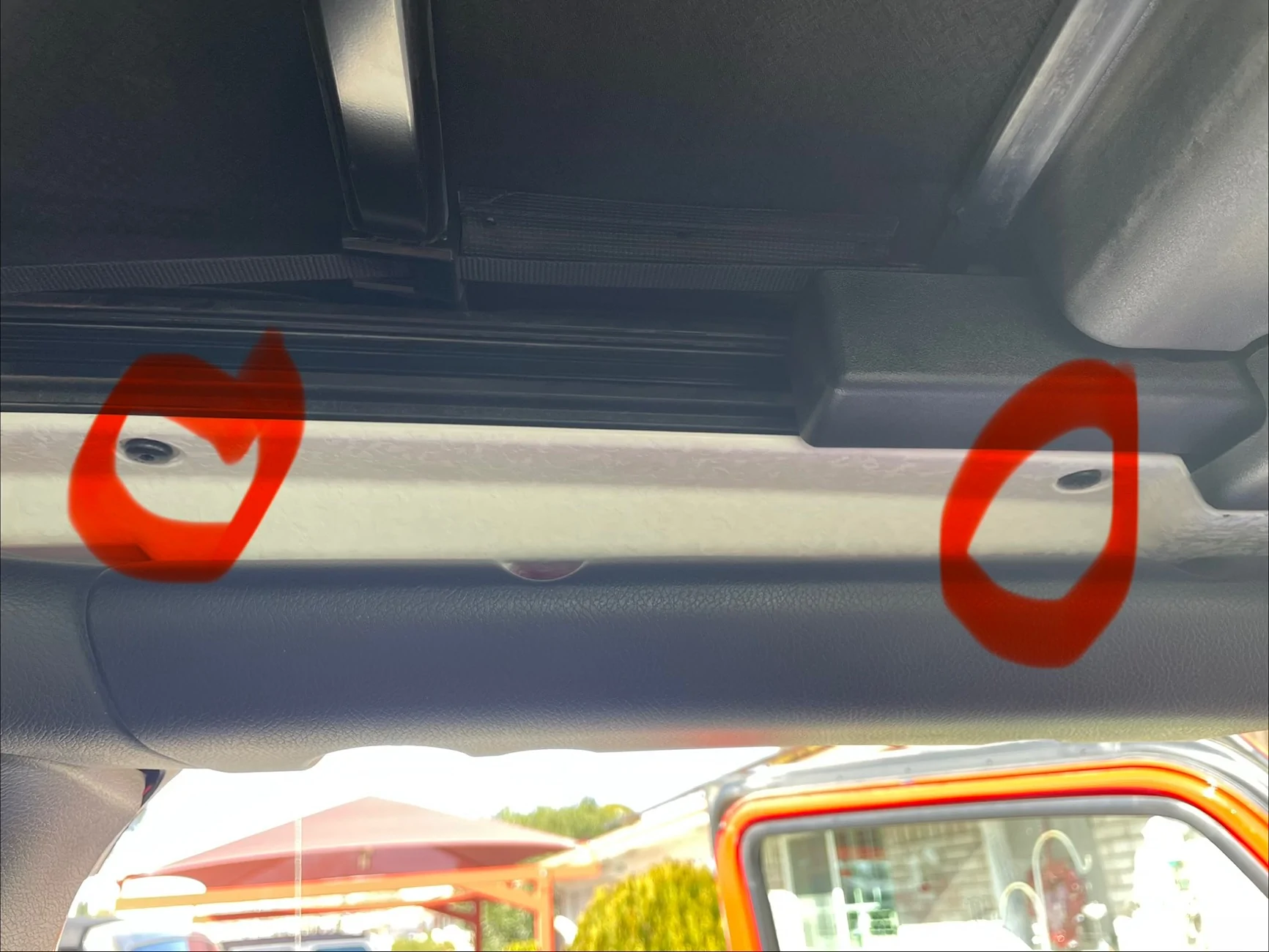

Not really, once you take the top off just flip it over and the torx screws are in the side rails, take those out and it separates them from the top mechanism.
this is two of them, I believe there are 6 on each side.

Looks easy !
Thanks

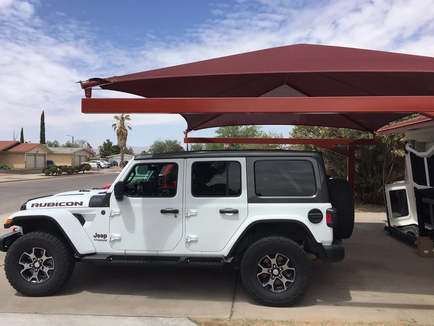

Found a picture of the top before paint.
Jeep Wrangler JL Sky one Touch paint and seal replacement 63901045043__B92160C8-82F6-45F9-88EF-0AD705FD02E3
there are 7 screws in each side.
Jeep Wrangler JL Sky one Touch paint and seal replacement IMG_3483
and after paint.
