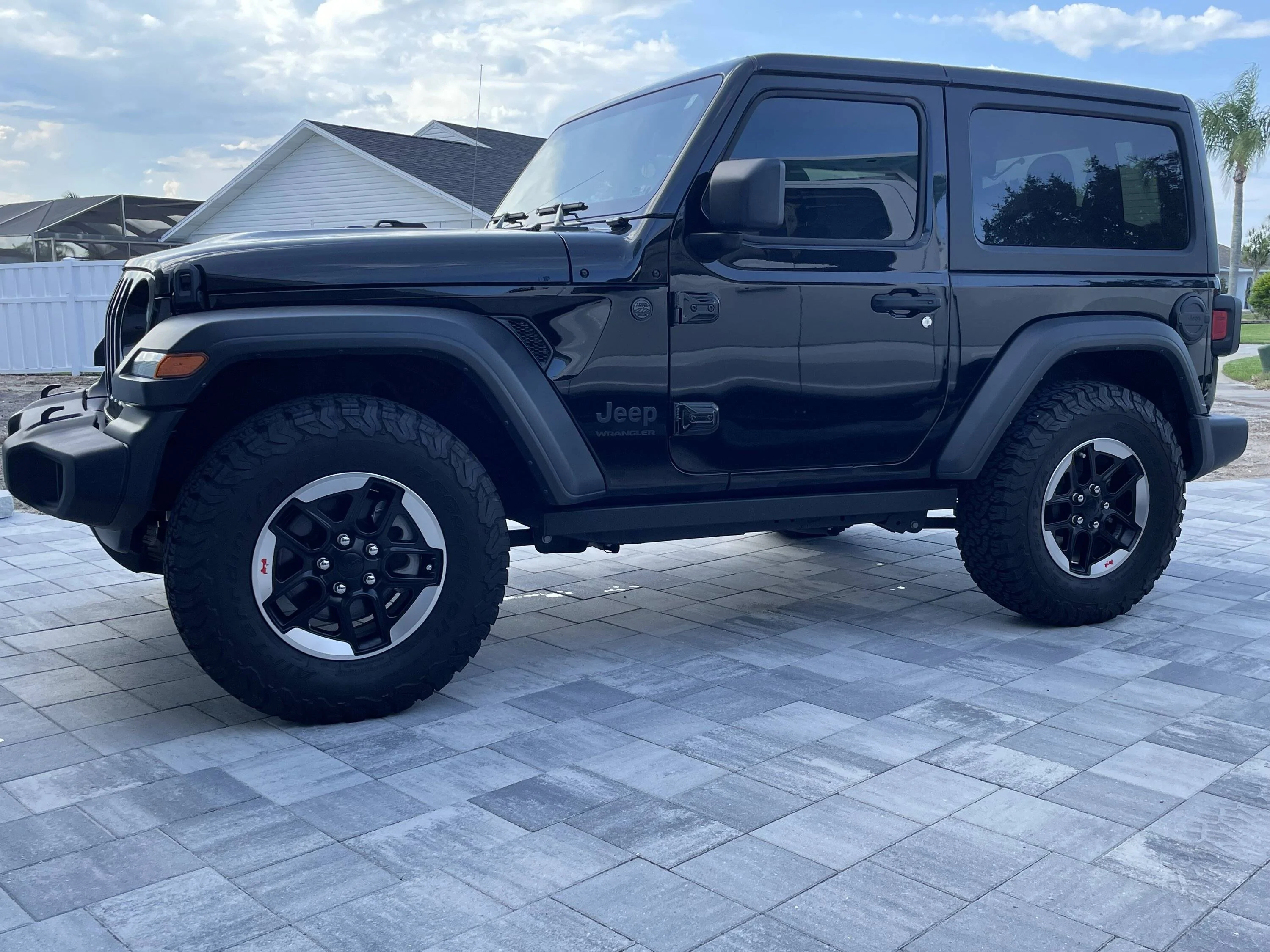

A nice way to upgrade tires is get a set of New Rubicon take off’s from your local classifieds. The 285 tires will fit nice with no lift & spare will fit with no changes. I’d recommend finding a set with the BFG All terrains. They drive & wear nice. Here is our 2dr Sport with Rubicon take off’s.
