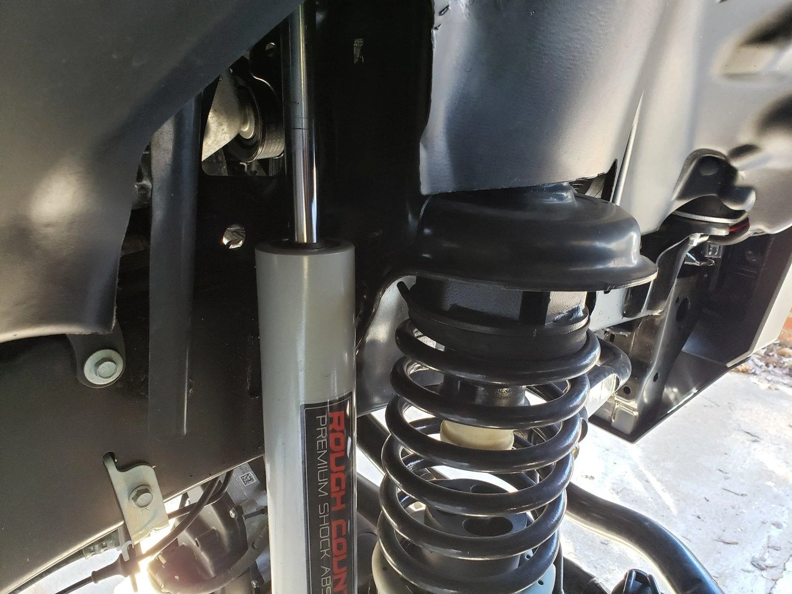

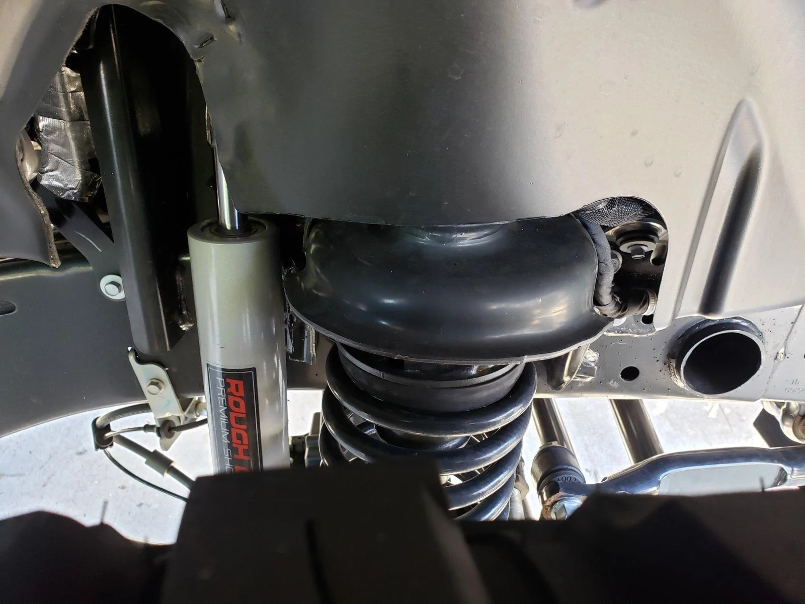

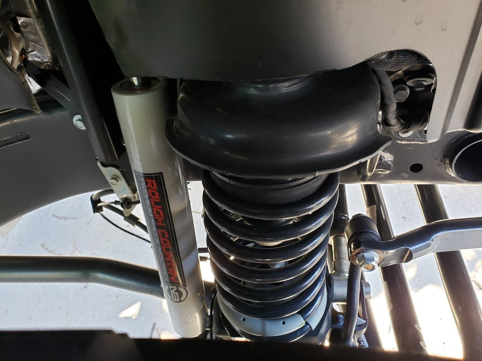

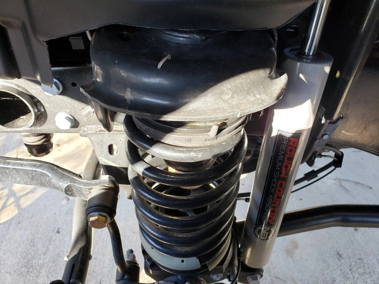

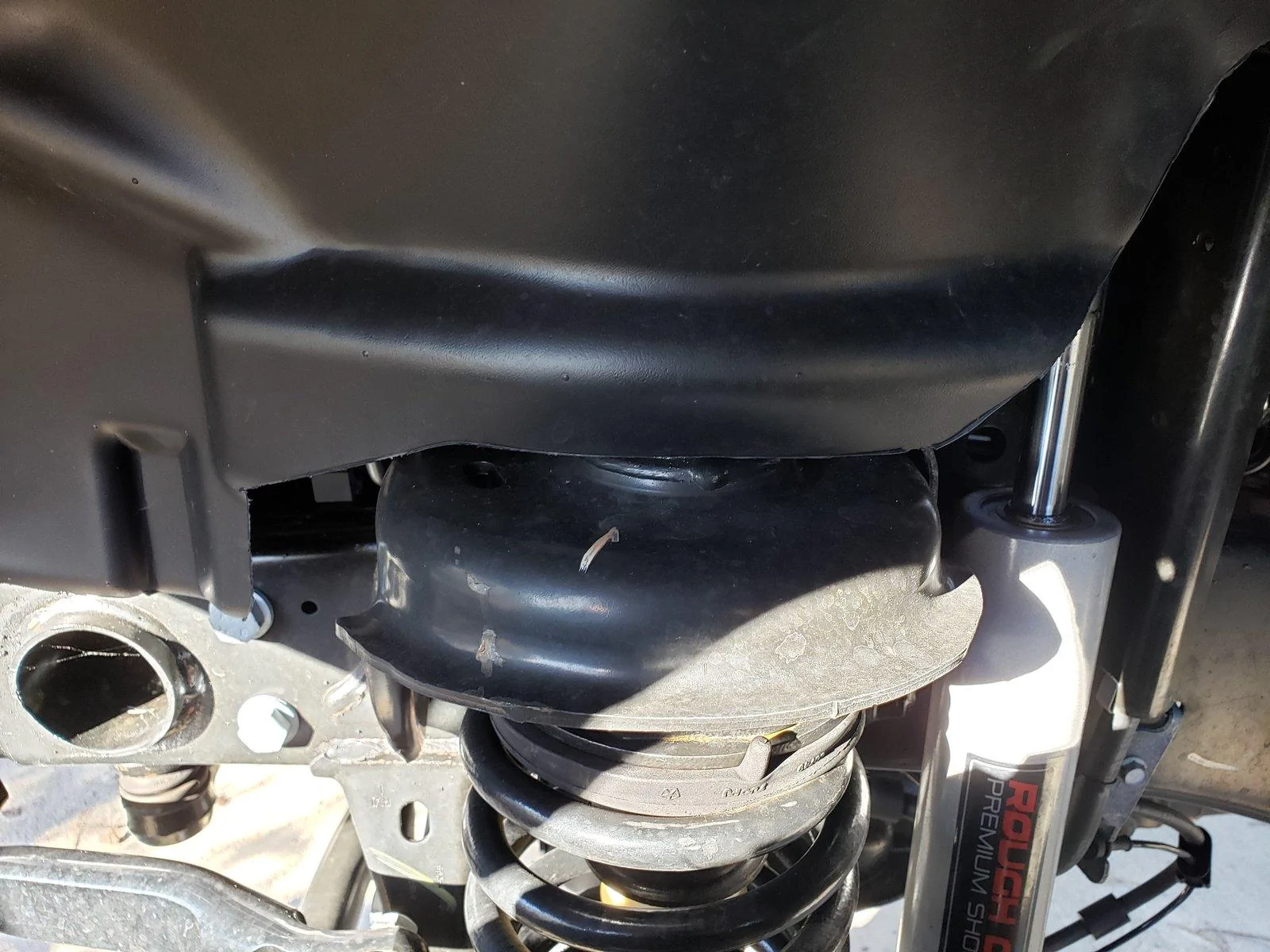

You could have a loose shock mount on that side that's banging around or a bad shock... I'd get under that side and feel around and check all the arms and the shock to see if I could find something loose... I'll walk out and take a pic of mine and post it in a sec...
Mine is more covered than yours but I have several wire harnesses that push the passenger side fender liner out... I can push them in but it pops back out...
Edited to add pics...
