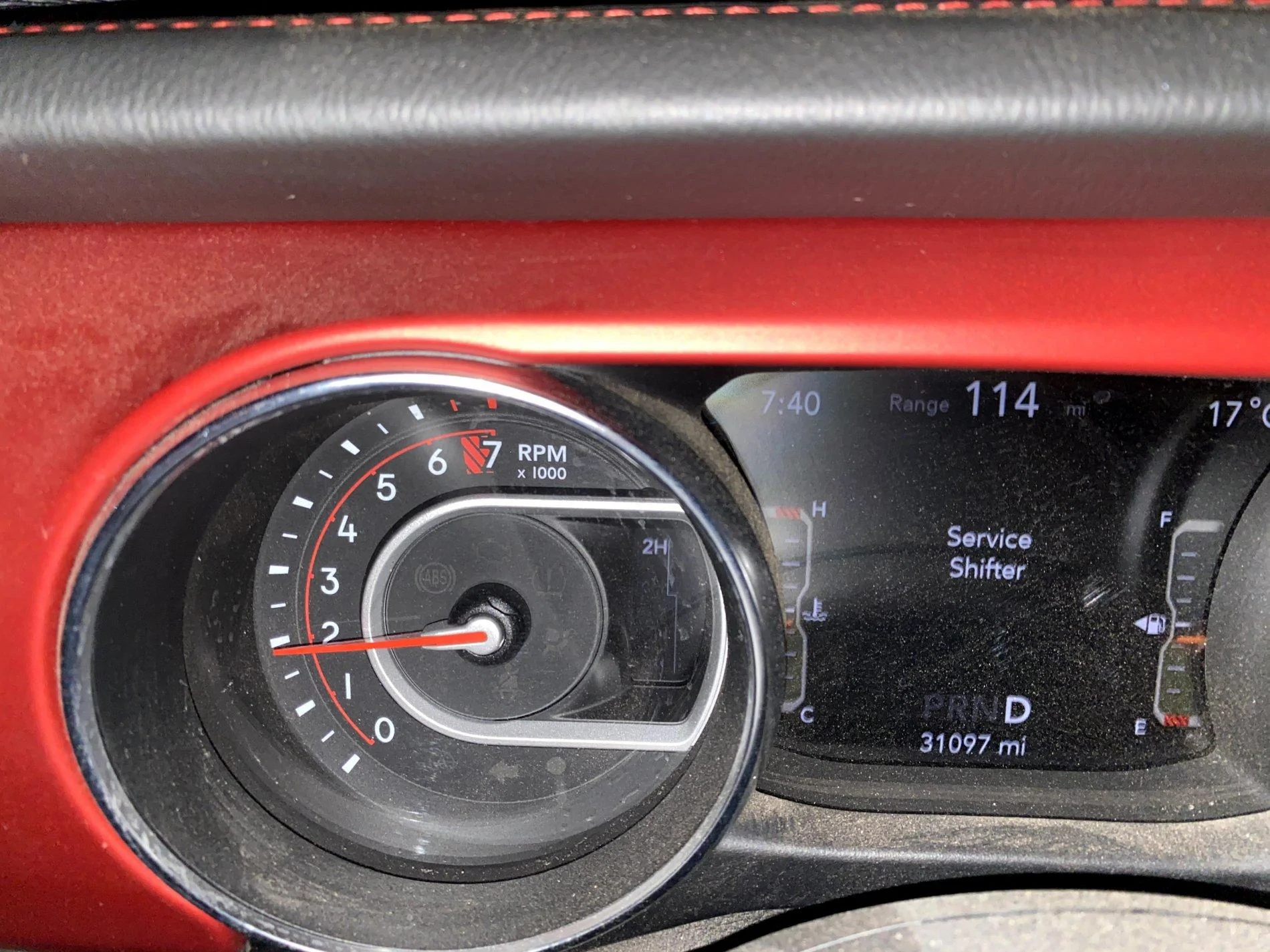

Hi,
So for a couple of days I have "Service Shifter" that appear while I drive (with the beep tone).
However there is no check engine light.
Message mostly appear when I accelerate.
I tried an ODB2 reader and the fault code seems to be U0074 in transmission category.
I recently connected a SPOD, tried disconnected it after but "Service Shifter" still appear.
No Tazer connected.
It's a JLUR 2019 3.6 v6.
I will update the thread if I have an update but in case anyone have/had similar issue that would be helpful!
Apparently U0074 is DEDICATED POWERTRAIN (D-PT) CAN BUS OFF
