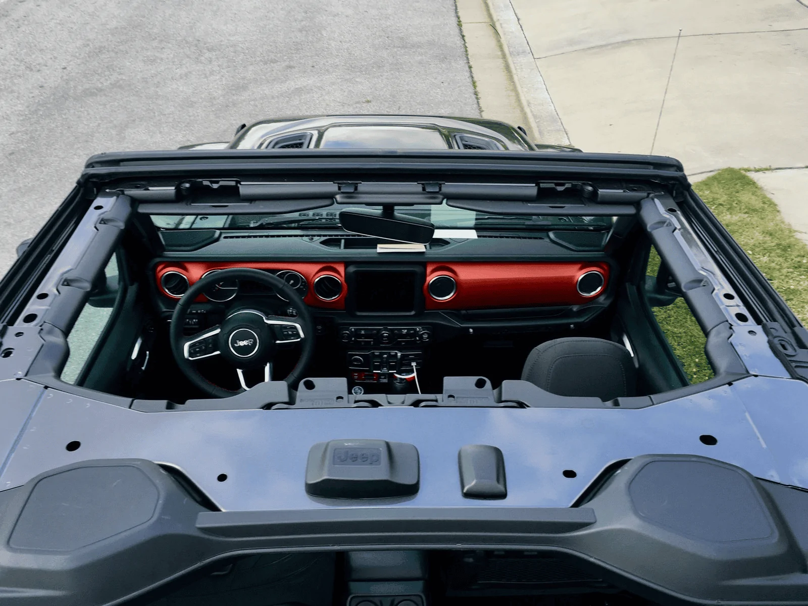

It mounts here:
Jeep Wrangler JL Satellite antenna 1589499649369

Ok that’s half the battle, now how do I get to behind the head unit?
I believe the factory runs it down the C pillar. From there it goes under the inner door sill trim, through the passenger side kick panel trim and behind the glove box, then towards the radio.
Nice looking rig by the way.
It's not mine. Just a pic for your reference.
