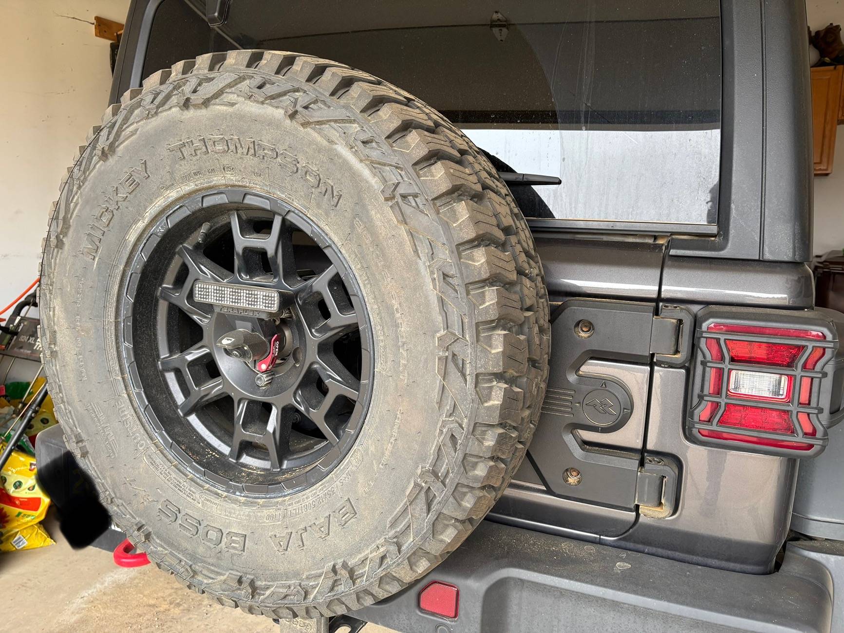

I have the Rugged Ridge hinge & Teraflex Alpha carrier for my 35s, no issue here other than a little rust on the RR bolts. I am running the 35s on the middle mounting location, it lowers the spare so it doesnt take up as much of my rear view vision which I like.

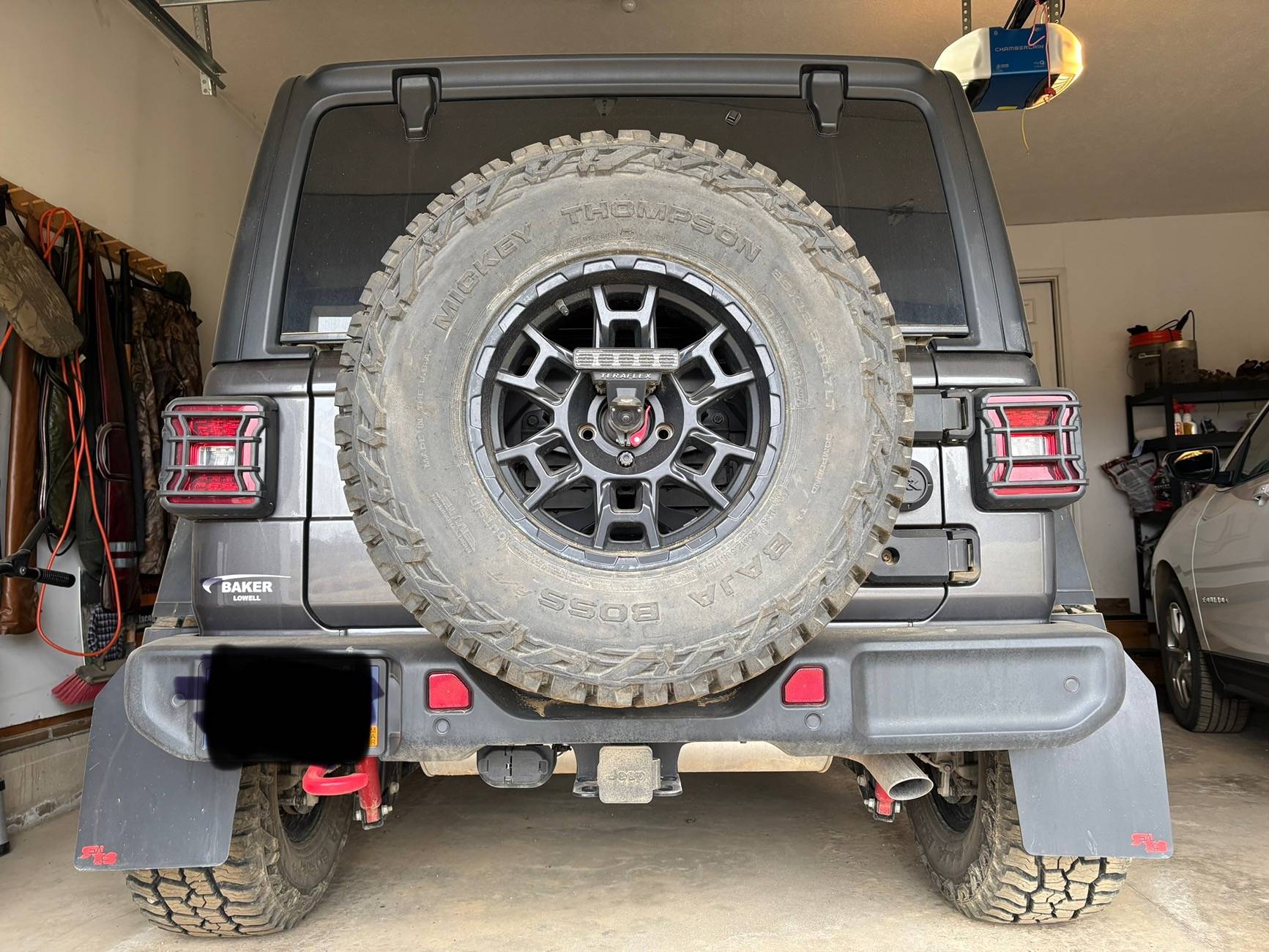

Just get the CavFab. You are adding a ton of weight back there on the gate that isn't made to hold it. The hinges will help, but that gate itself is pretty flimsy. With the CavFab, the entire weight of everything back there is on the upgraded carrier and that carrier is going directly to the tub/frame on bigger hinges with an extra hinge bolt.
One of the best upgrades I have done on my JLUR. It would REALLY suck to have a carrier fail with traffic behind you.
