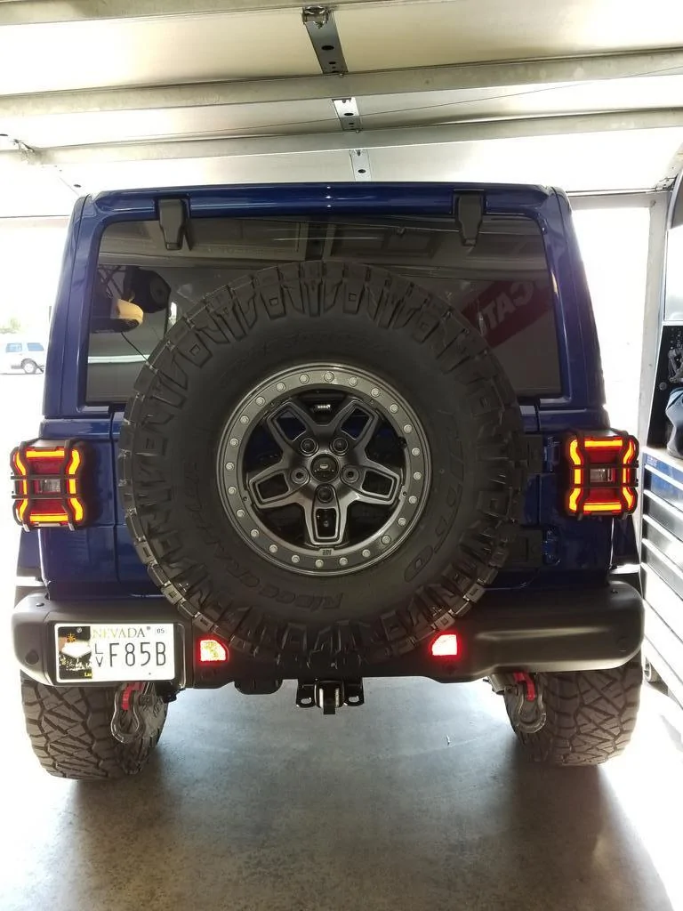

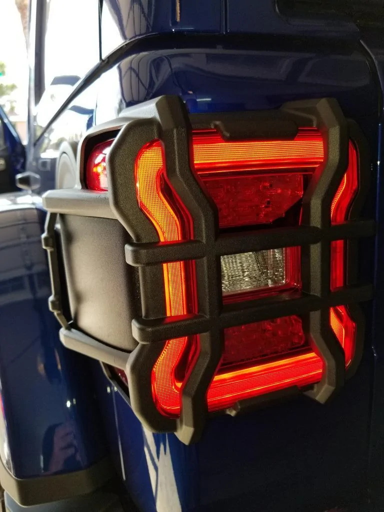

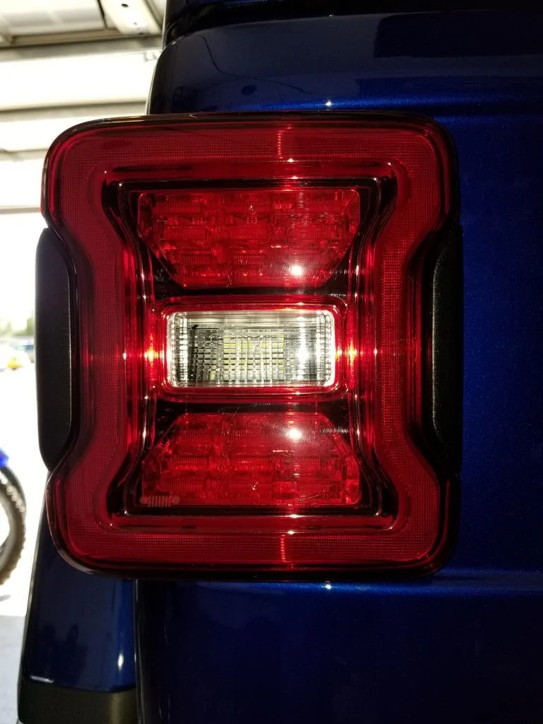

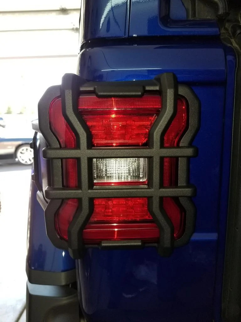

Here are some pics of the Rugged Ridge front and rear light guards installed.
I do not have anymore pics of the front. Both are easy to do.
***** The Mopar tailgate reinforcement does push on the light guard and moves light about 1/8th of an inch. *****

Ive been looking at these since they got released. I have the headlight ones and was wondering how the build quality of the tail lights are?
So fully opened tailgate with hinge reinforcement puts pressure on the covers?

The quality is top notch. Yes when the tail is fully opened it puts pressure on the passenger side light bracket pushing on it and it moves about 1/8th of an inch.
This is for the Mopar reinforcment kit.
Tail lights need to be removed to install the rears.

sorry to revive an old post but can these be modified so they are compatible with the Mopar Tailgate Reinforcement plate?

Yep you just have to cut off the piece of the tail light guard that gets hit.
