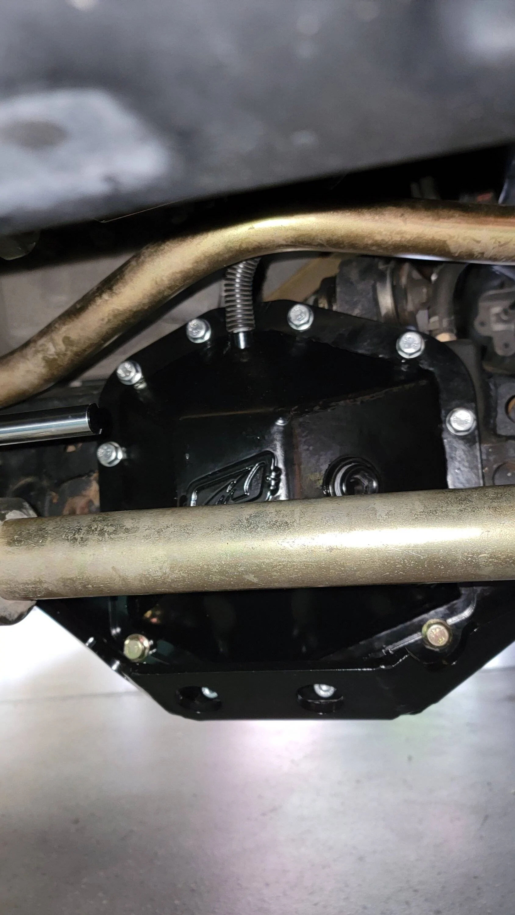

Jeep Wrangler JL Rubicon XR differentials Front Skid + Cover
Jeep Wrangler JL Rubicon XR differentials Rear Skid + Cover

I just finished painting my metal cloak covers. Ended up buying royal purple 75w/140 tonight but only bought 3 quarts. I didn’t factor in that the covers might require more oil. I kinda regret going with metal cloak, though. They’re cheaper (probably the only time that’ll happen) than arb or some others but the others at least have the fill hole where the level of gear oil is supposed to be, magnets to catch any shavings, etc. Would have made this a lot easier. But I’m a pretty big fan of MC. Have the undercloak already and the diff skids that’ll go on after I finish installing the new covers. I had read about the XR’s bump stops but didn’t truly grasp how big they were and how much they impede articulation until I took it out for the first time. I read one guy just did 2.5 springs and shocks and was happy. After talking to MC, though they highly recommend at least the 2.5 true dual kit. I didn’t want to spend so much so quickly. I’ll probably just have to deal with less articulation for a couple of months and then I’ll go for the 3.5 true dual lift kit with rock sports. Kinda feel like 2.5 is a bit of waste of money.
