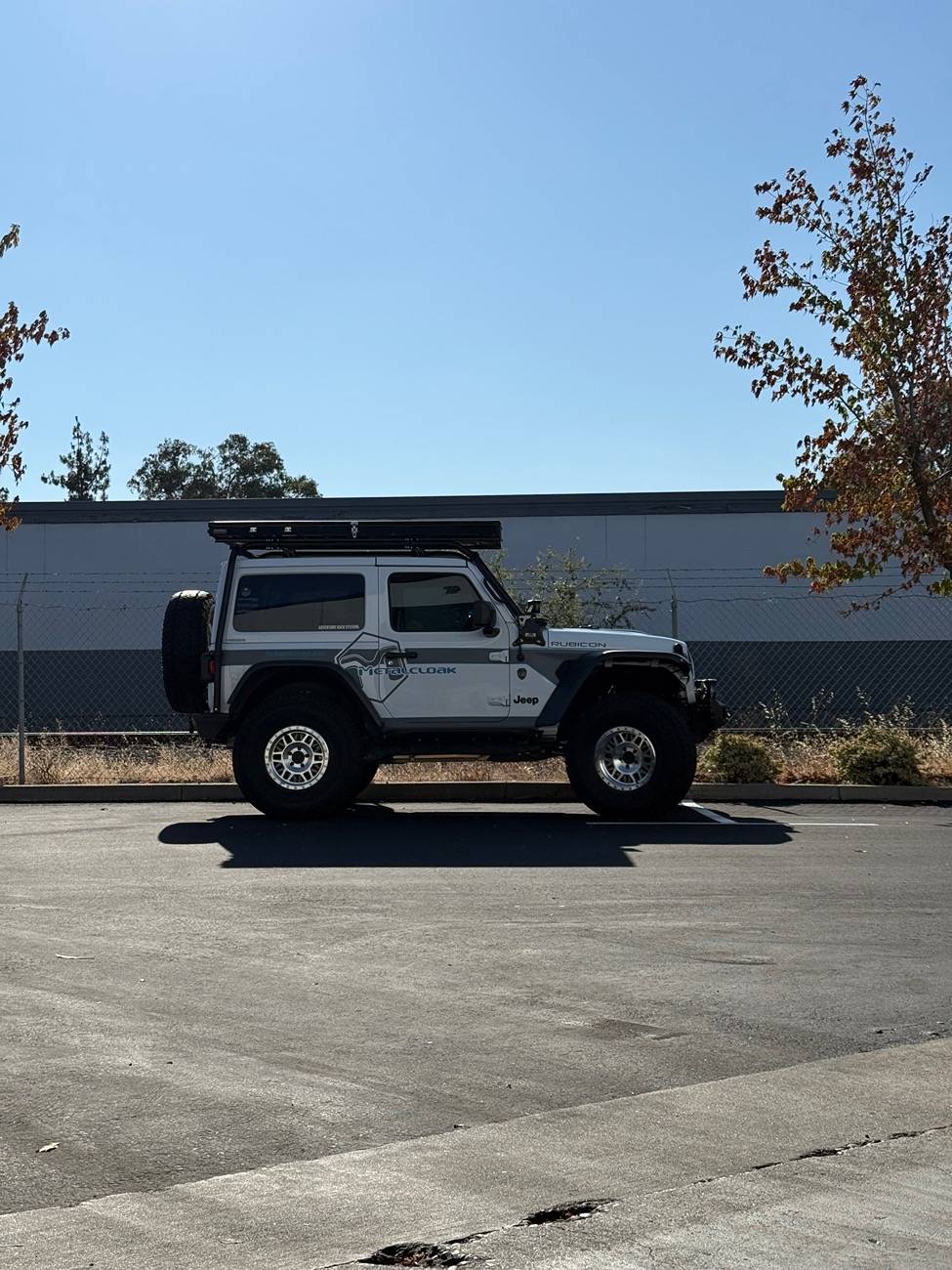

It's a good solution for light duty if you're not going to run an RTT. I need strength for a tent, so I run the ARS Rocklander and just remove the trusses and rear hoop when not in use (so that it fits in my garage)

Mike,
That's a sweet setup. I have the ARS rear bumper reinforcement brackets on my OEM steel bumper. Thanks for the picture too. It would great to have this turn into a collection of different solutions, with reasons and pics. Thanks, JBC

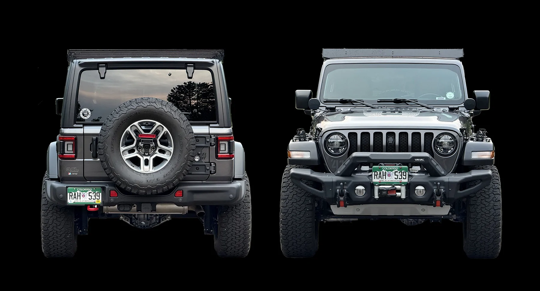

It has been a few weeks since putting up this thread and I promised a recap after install. Here it is:
Jeep Wrangler JL Roof Rack Talk... front and rear views to scal
At time of ordering, estimated delivery was 1-2 weeks. They came in at 2 weeks and 1 day, so not bad. Trouble with a laser cutter was cited as the cause. Upon picking up the rack everything was very well packaged. The main rack components ship in a large box measuring about 96" x 11" x 4" and weighs about 55#. It slid in my JLU with the front resting on the dash and the rear resting on the rear seat. Hardware and brackets came in a separate, smaller box, again - nicely packed.
Installation instructions were printed off the web site. First thing's first – unpack everything and go through the parts list to ensure all the required pieces were there. Unfortunately they were not. Two main brackets were missing, which was frustrating. Because they were closed Friday it meant waiting until the following Monday to get everything installed. Reading the reviews, I noticed at least one other person experiencing this same issue.

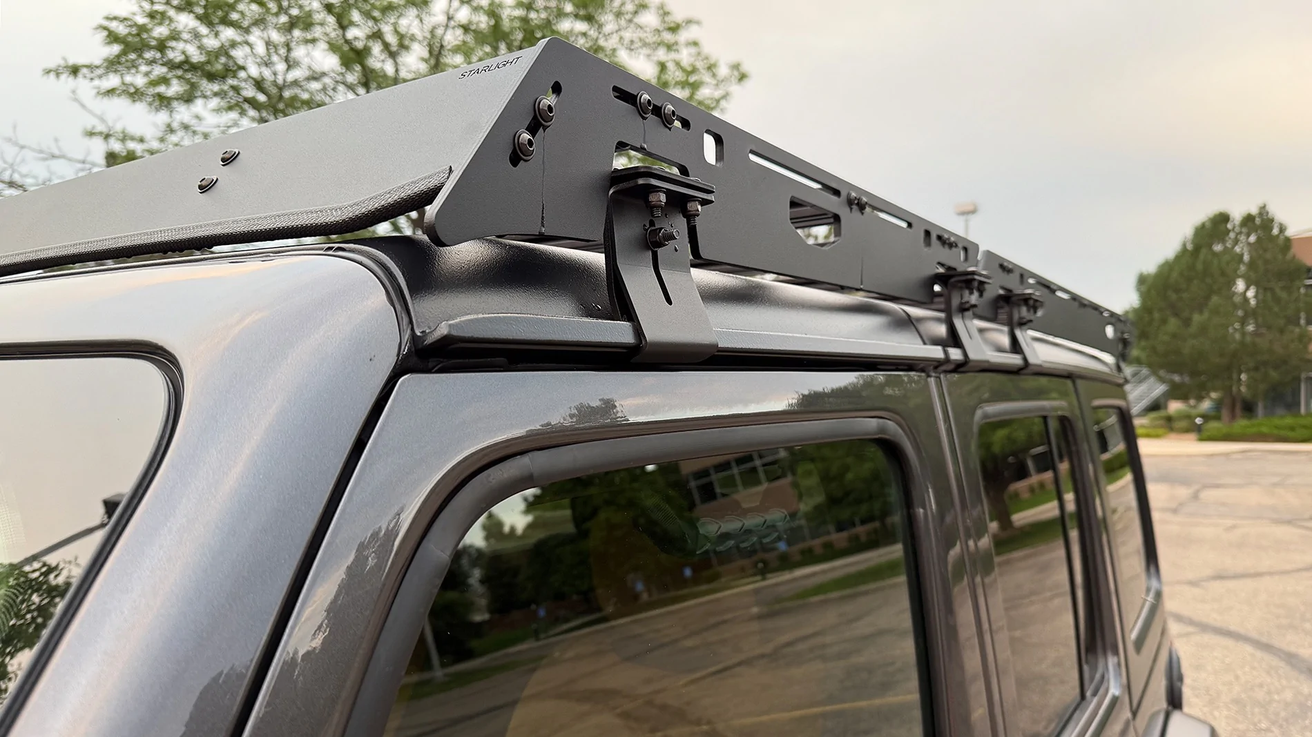

The rack mounts to the roof in 2 sections: the front, over the Freedom Panels, and a longer, rear section. I opted to install the front first - bc that's all the bracketry I had. Everything went together perfectly. Every one of the hundred+ bolts, washers, nuts, etc. were perfect - no damaged threads. Every one of the cross members were also perfect. This is one area I was a little concerned about. Two holes are tapped into each end of each (9) cross members, with button-head bolts screwing into aluminum. It would have been easy for taps to be imperfect. They were not, and everything bolted together cleanly.
Assembling and installing the rack solo was easy, though did take some time bc I'm slow and measure everything carefully. Rather than assembling the rack on the ground (or a table), then lifting the (heavy) assembled rack onto the roof - they have you assemble and install the main cross-bar assemblies one-by-one, positioning each onto the roof. A thick blanket across the roof eliminated any possibility of scratches as each of the 4 bars were positioned, measured, adjusted then fastened down.
Jeep Wrangler JL Roof Rack Talk... Starlight Brackets Closeu
Side rails go on next. Because each side rail is relatively light - lifting and positioning them is easy. Fine tuning placement of 4 supports along the length of the vehicle is easy, and soon the rack started taking shape. Once the 4 main supports were mounted, the remaining cross bars between were positioned and tightened down. A small step ladder made it easy to see exactly what you're doing atop the roof.

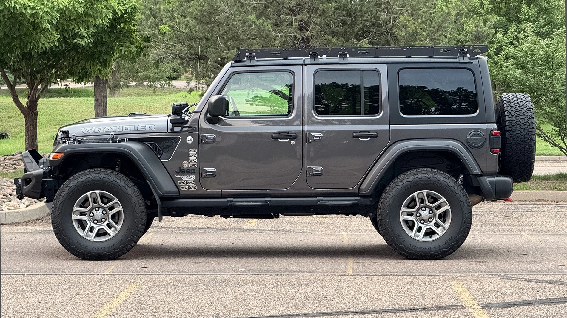

Overall impressions:
The rack is very well designed, engineered and constructed. It feels extremely well-built and sturdy. I watched other videos of guys hanging on the (3/16") side rails of other racks and they flexed. These side rails don't flex - at all. At 1/4" thick, they're extremely rigid and securely fastened to the roof at 4 points on each side.
Jeep Wrangler JL Roof Rack Talk... Driver Side Vi
A few notes about weight:
  1. The rack reportedly weighs 55 lbs. I didn't weigh my final assembly, but did weigh a cross-member, which weighed 4.4 lbs. With 9 cross members, this clearly represents the bulk of the rack's weight. If you can get by with fewer cross members you'll save weight.
  2. The Jeep owner's manual says to not put more than 100 lbs. on the roof - including the weight of the rack. They cite OEM/factory cross bars, which allow only 4 points of contact; 2 x 2 bars. Using that number is a great guideline. But it got me wondering...
  3. If 4 points of contact on the factory roof rails support 100 lbs, I wonder if the 8 points of contact on this rack might support a little more - spreading the weight out over a larger area. I don't know - it's still only fiberglass - but I suspect the answer is yes, a little more. This helps, because...
  4. Subtracting the weight of the rack (55 lbs) from the officially allowed capacity (100 lbs) leaves a scant 45 lbs of cargo weight on the roof. Not planning to overload it - but things add up pretty quick. For example, our River Quiver 2-banger comes in at 22lbs + bracket. That leaves about 20 lbs for things like bed rolls and other light incidentals.
  5. If you're going to get a roof rack and put anything on top, pay close attention to weight.
  6. I see a lot of guys with these ROAM boxes. They look great and all, but they're heavy (95L/83L weight about 25 lbs each). I also have to wonder what is being carried up there if one is strictly adhering to weight restrictions?
Wind & Noise:
The rack is very low profile, adding only about 2.5" to the height of the vehicle. This was important to fitting him in the garage (2" lift and 35's). No problem at all in our standard 8' garage height.
Because of the low profile, wind noise isn't bad. Positioning the front fairing is important. They recommend it not come in contact with the roof, and to leave 1/4" gap. So far wind noise isn't too bad, but as of this writing I haven't taken him on the highway for extended periods. I'll report back when I do.
