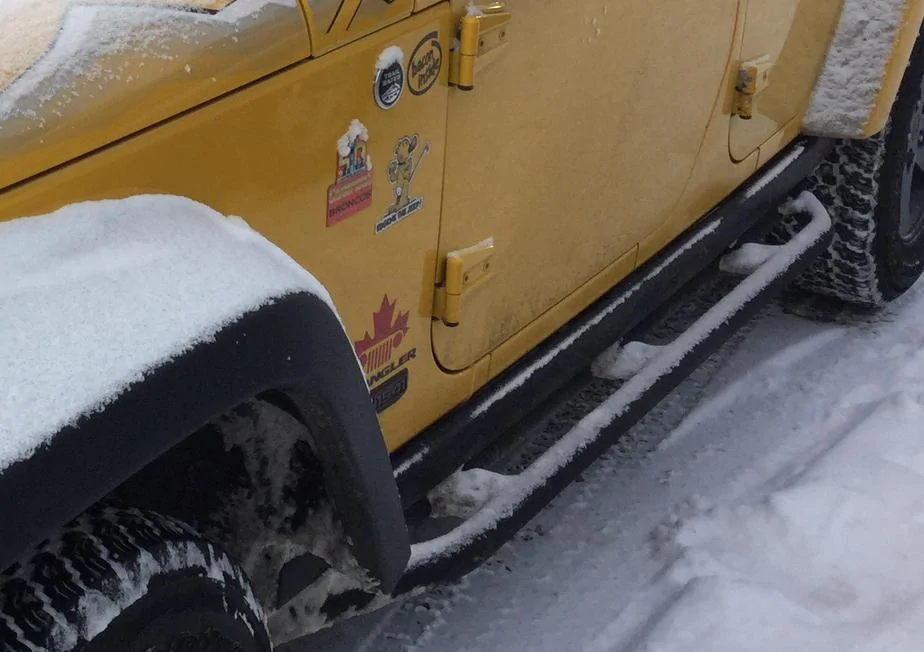

Interesting from that angle it looks like the rails themselves are tighter to the frame (ie mounting bolts slightly inwards, only by an inch, but seems a smaller stepping surface)..
I think you might be right. I've never seen the JK's in person so I'm not really sure. It's definitly not a large stepping surface, but it works fine for me.

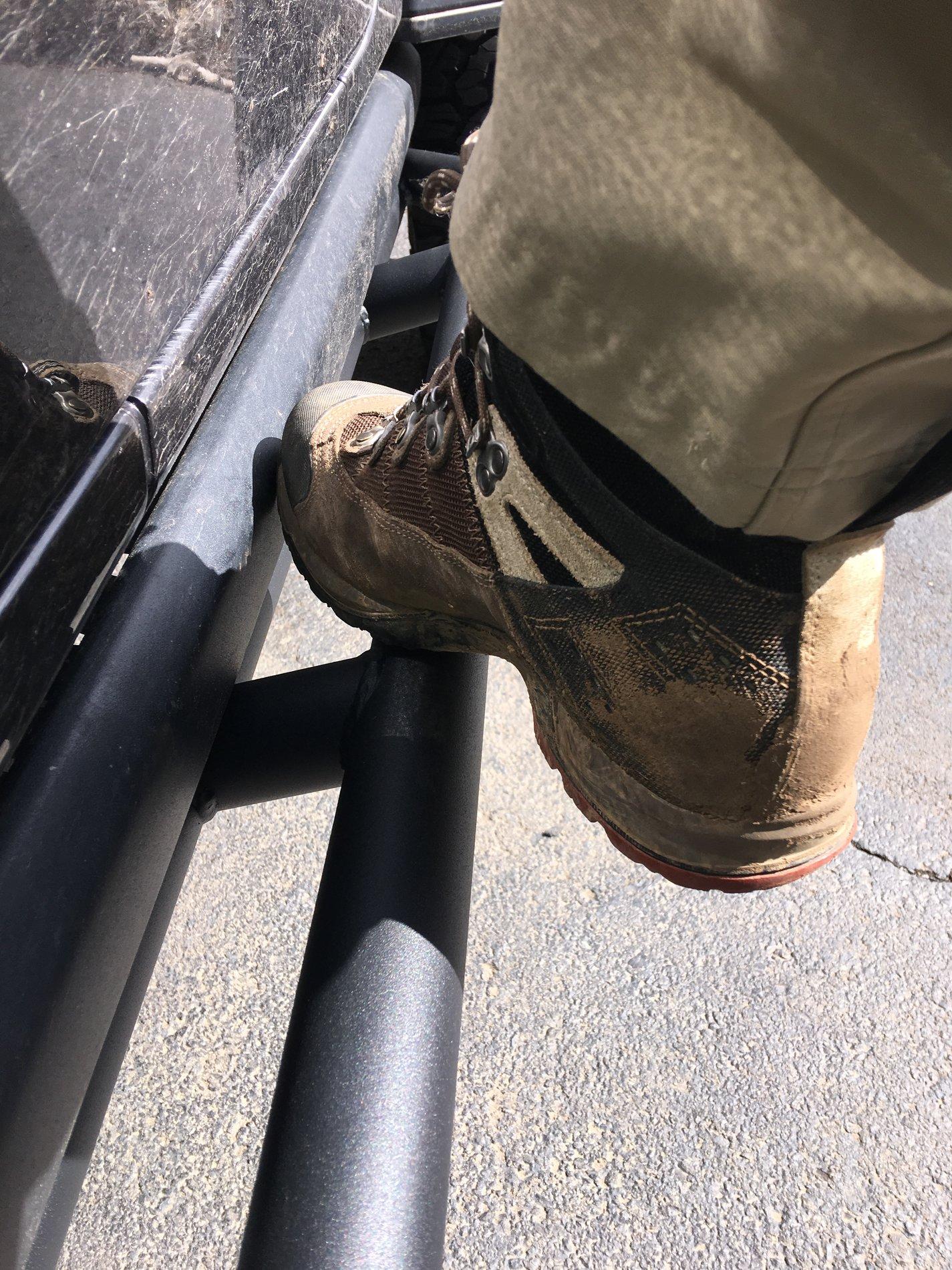

Here’s how a Size-10 hiking boot looks on the rail. Perfect size for me. It will be easier with sneakers or flip-flops.:rock:
Jeep Wrangler JL Rock Sliders and Side Step 250C270B-EE98-4C86-9C11-3CFF5F8FD31E
