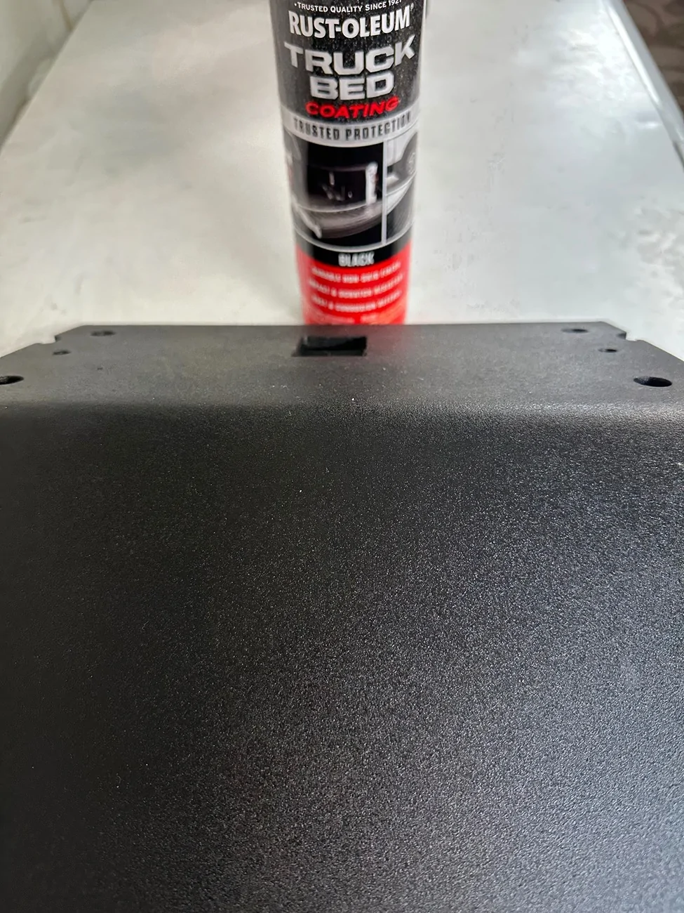

I’d be tempted to try Rustoleum truck bed coating first. It’s cheap, dries super fast, and is easy to touch up areas and have it blend in. It has a low gloss and a very fine sand like texture. If you end up not liking it and paying for LineX or similar anyway you’ve mostly just lost some of your time by experimenting with the rustoleum. Here’s a skid with the Rustoleum on it so you can see the texture.
