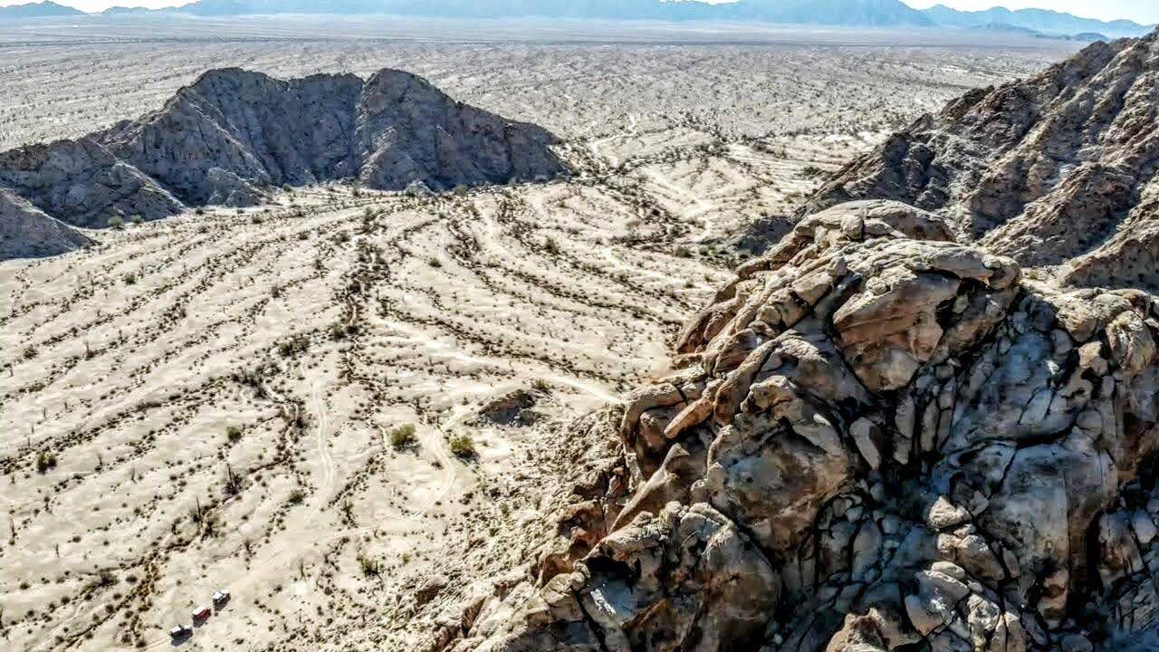

Desert

The Jeeps are in the lower left corner. I did some climbing that day.

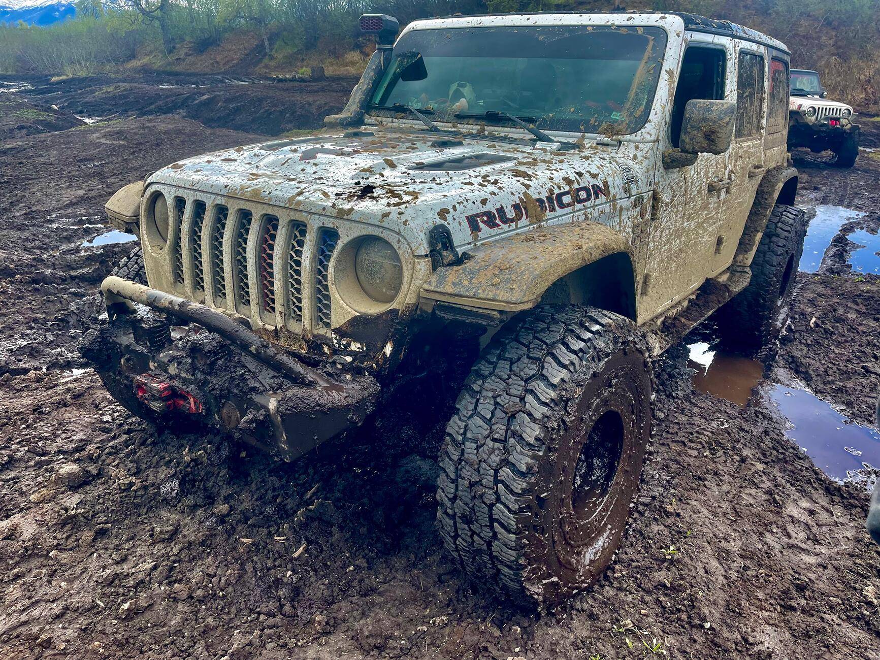

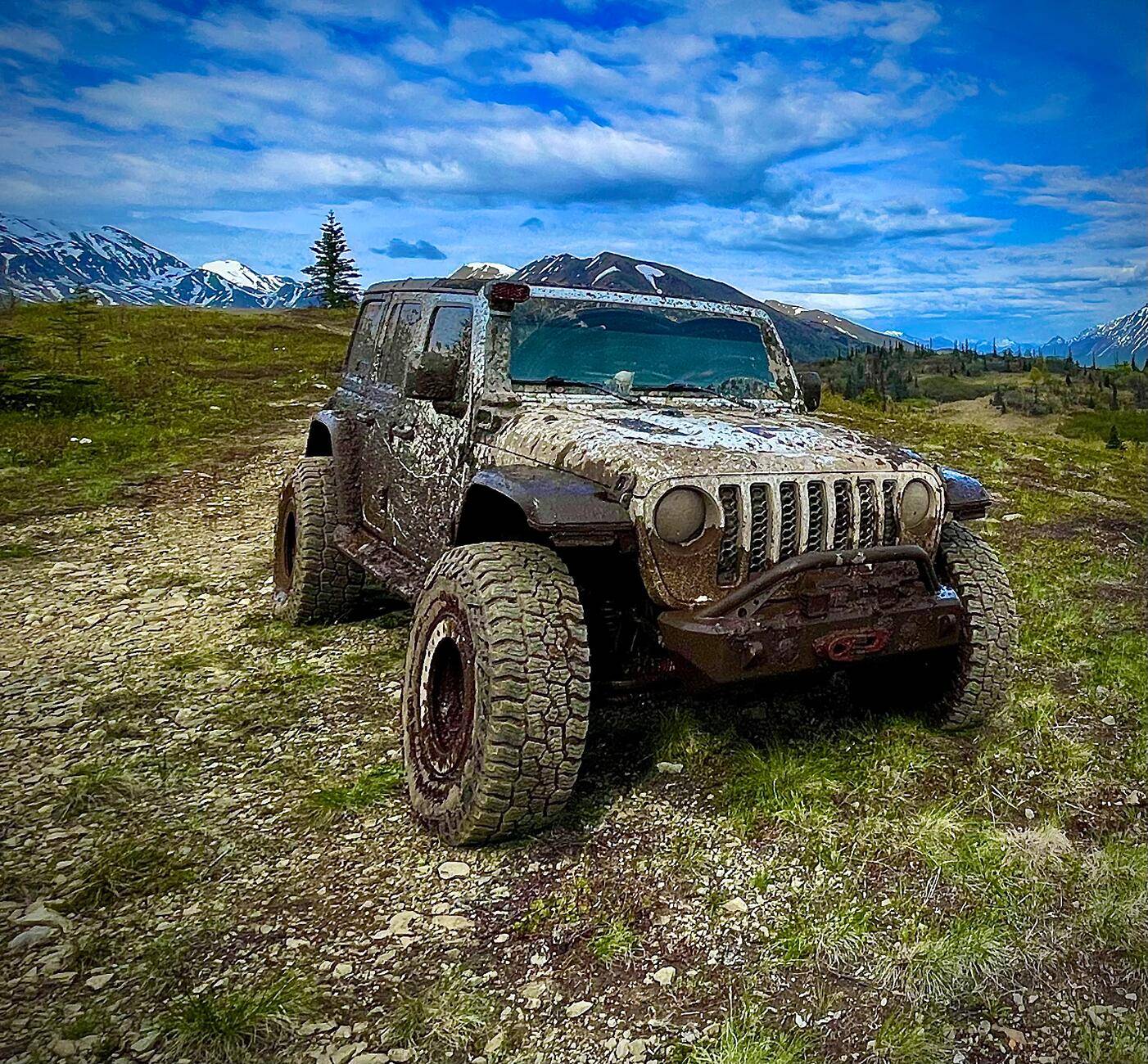

Mud
Jeep Wrangler JL Replacing Serpentine Belt--Is it Difficult? 1736516976640-xq

Then mud like this packs the radiator and idler pulleys fail.

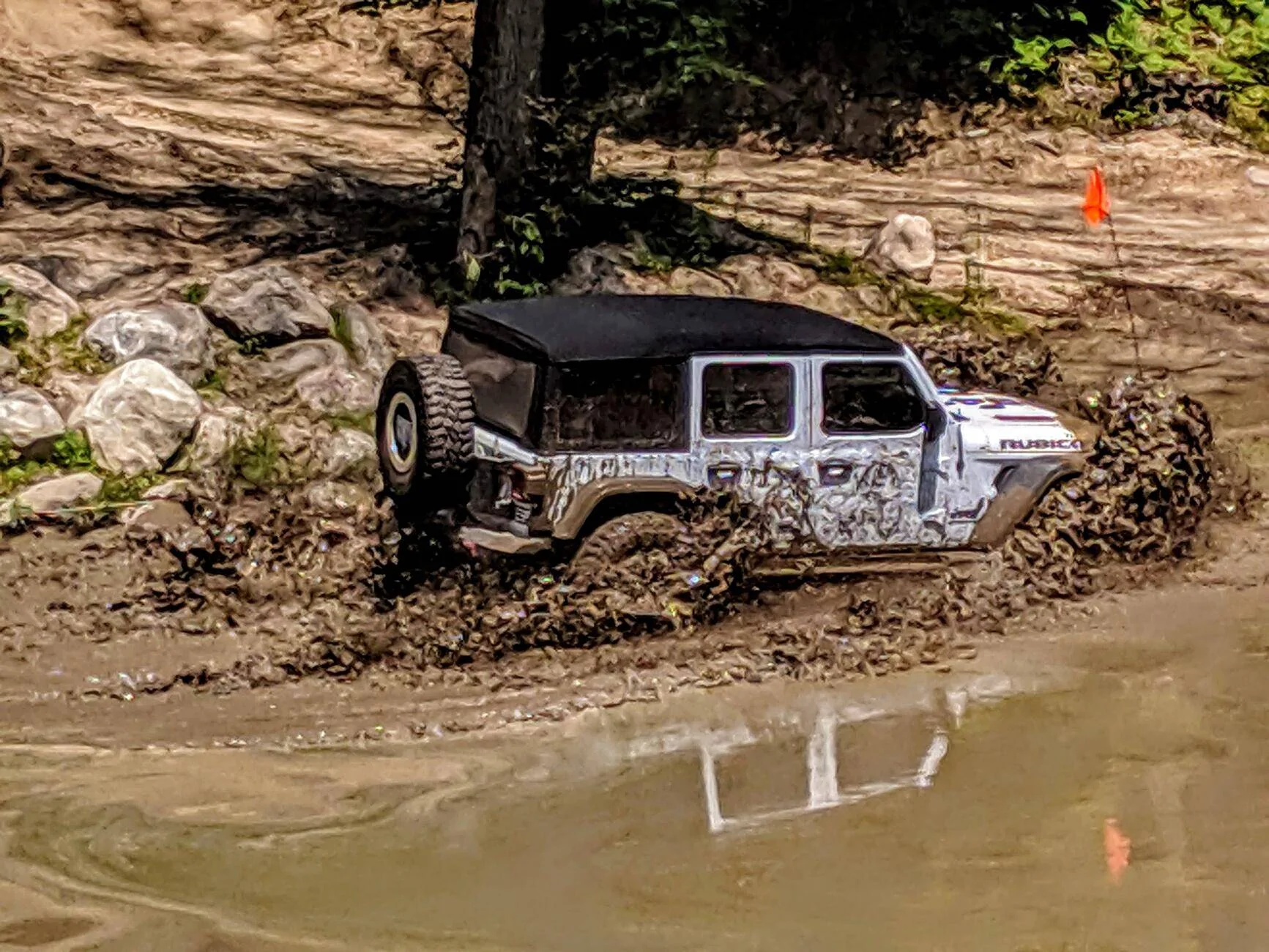

Hundreds of water crossing like this probably don't help.

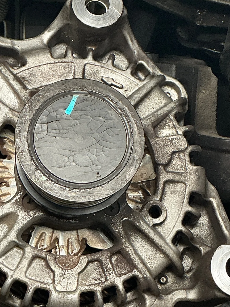

On Alternators -- here's mine on a 21 JL 3.0 diesel with tow packadge an 134K on it .. my tensioner pully went out ... Wabbling and grinding noise . So before i bolt up my alternator again .. i spun it to ensure its not noisy or sticking but check the wobble ... WTF ..???

Also what about the cracks in center ?

I would replace that alternator if it makes you feel more safe. It’s clearly wearing out, but not bad.
