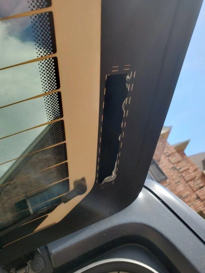

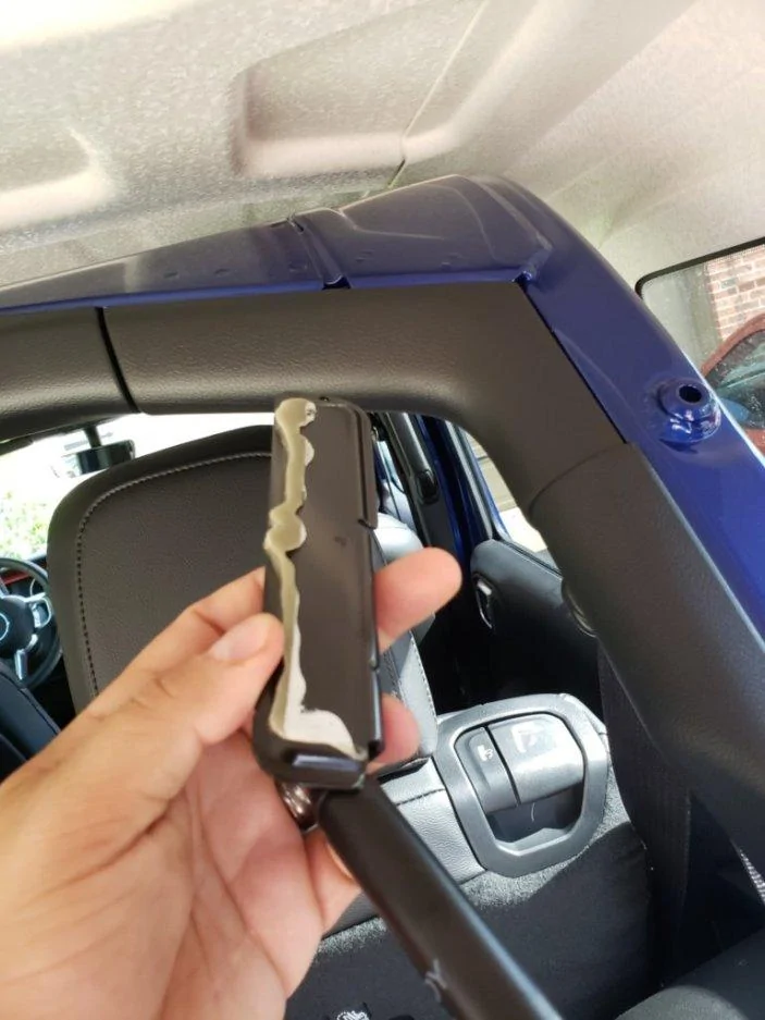

I was gone for a week and came back to find my passenger side rear window strut fell off my window! The other one is fine and this one was off. Has this happened to anyone else and if so, what did you do to fix? I could bring it in under warranty but this almost seems like a job for some epoxy?

I haven't had the bracket come off but I did have my defroster wire come detached. I'd take it in to a dealer to have them start a warranty claim for new back glass and for a temp fix you could epoxy it on. When the new back glass comes in (in a month or two), it's like a 20 min swap.
Ours fell off this week, same one as yours. Haven't found the right epoxy to fix it yet.
You might try one of the kits that are sold to reattach rear view mirrors to windshields.
