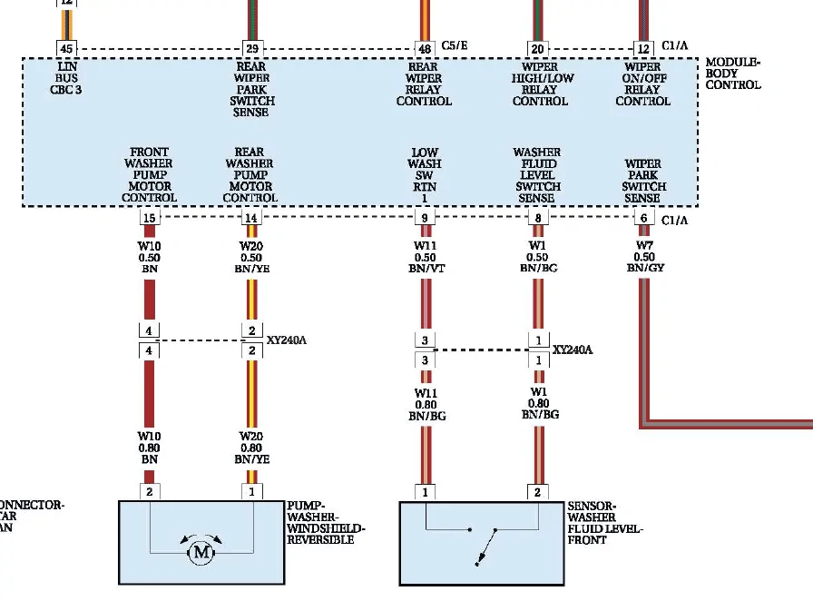

Can anyone please tell me what reverses the polarity on the windshield washer pump?
I have installed the mopar hardtop conversion kit. Activated with Jscan yet when I push the rear washer only the wiper turns on. I really don’t want to go to the dealership $$&
