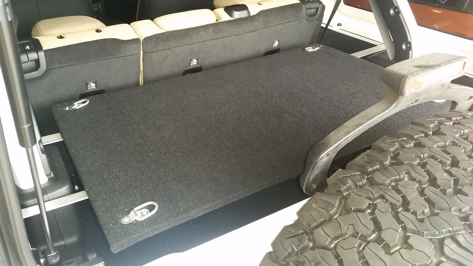

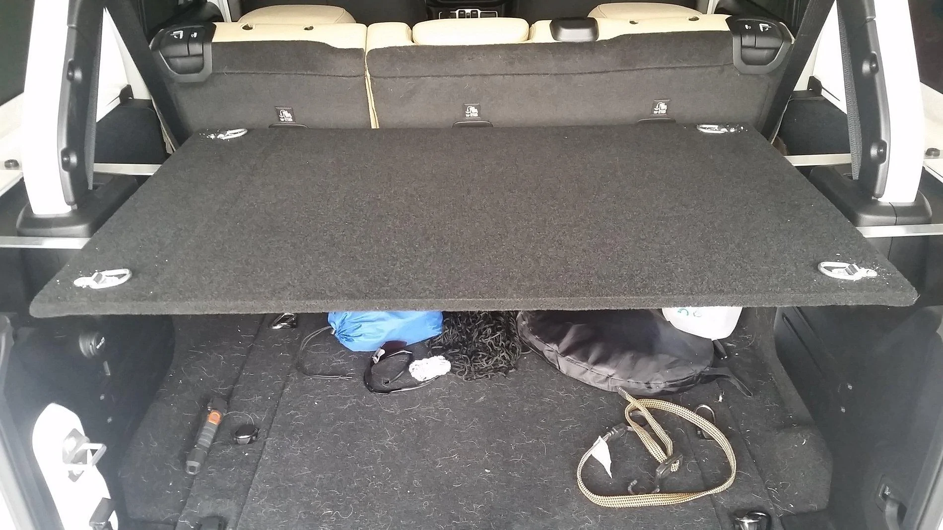

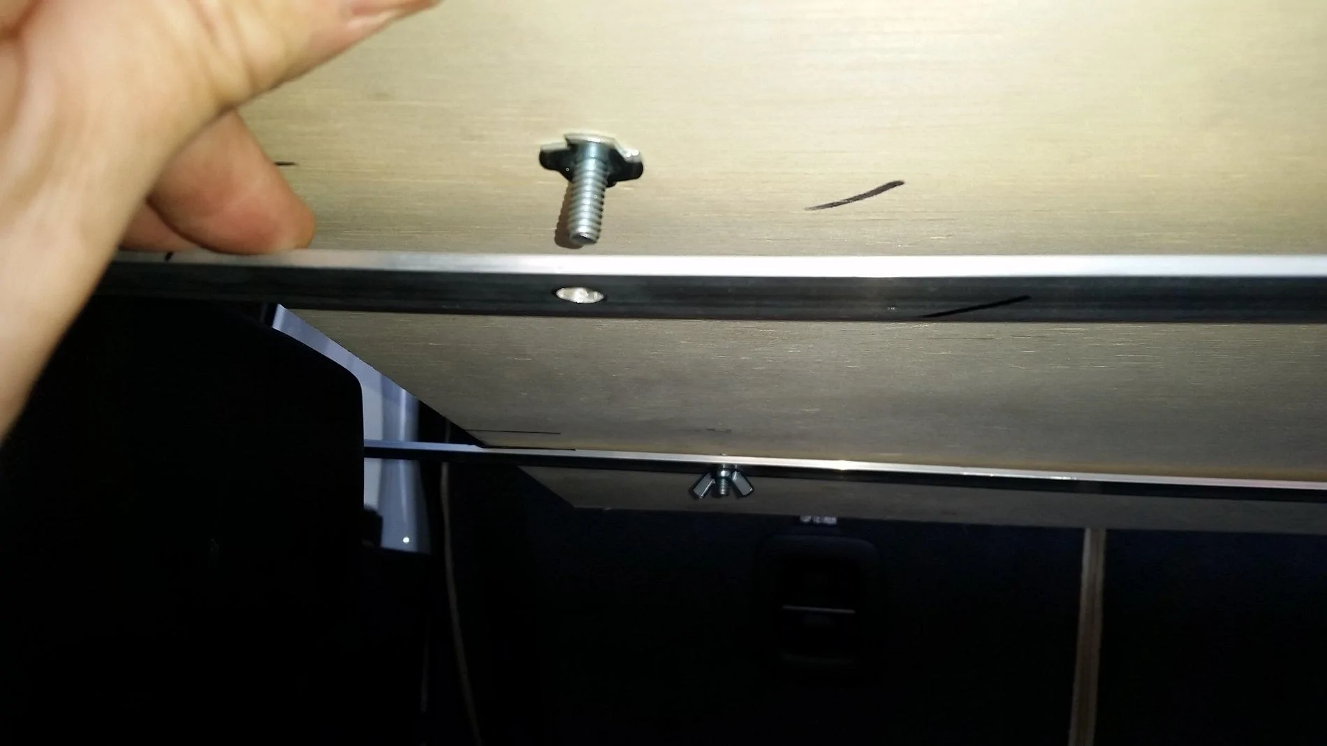

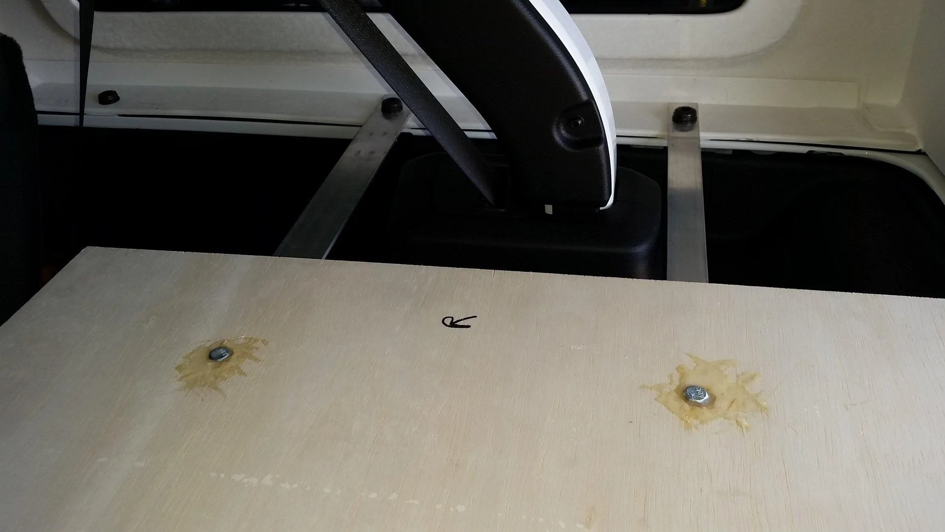

I wasn't keen on spending $300 on a basket/shelf so made my own.
- 3/4" inch Home Depot cut board
- Two aluminum flat bars
-Pepboy Interior carpet
-misc hardware
Simple install;
-Remove roof bolts and place flat bars in place.
-place the board with threaded stud through mounting holes and tighten wing nuts.
-misc hardware
Simple install;
Jeep Wrangler JL Rear Storage Shelf 20180401_075051
Jeep Wrangler JL Rear Storage Shelf 20180401_074923
Jeep Wrangler JL Rear Storage Shelf 20180331_153923
Jeep Wrangler JL Rear Storage Shelf 20180331_153815

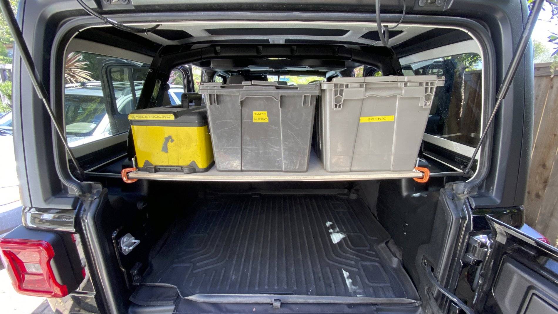

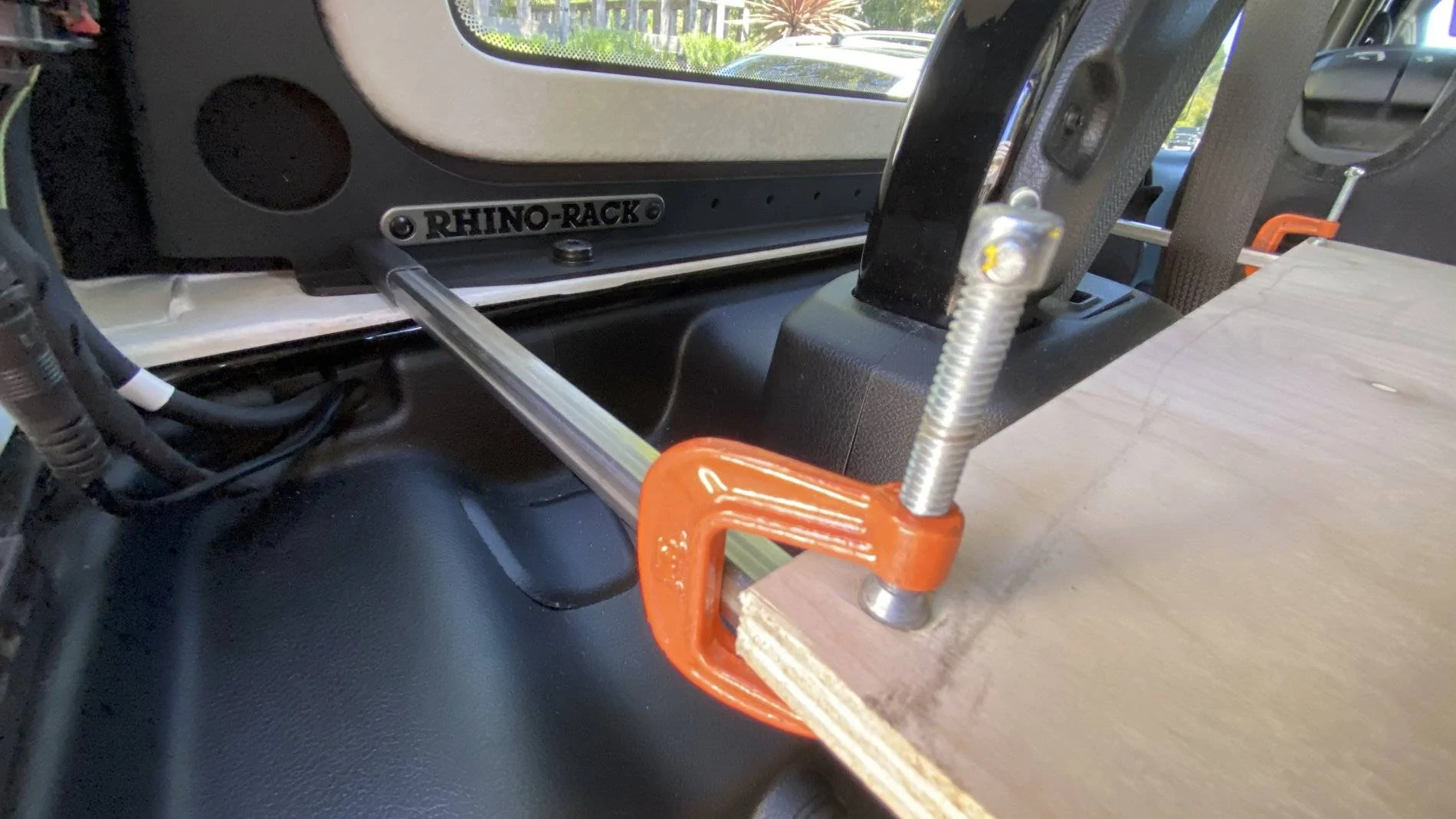

Hey Ron,

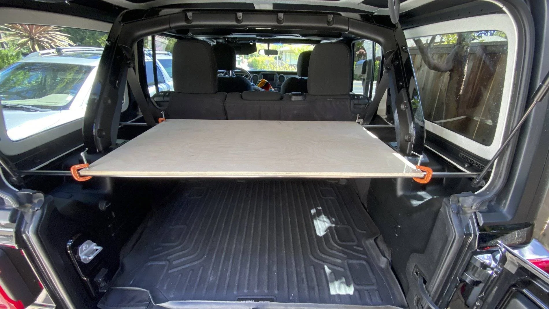

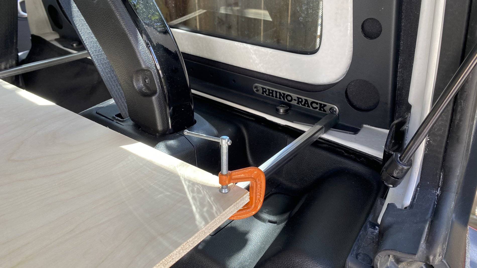

Here's my low-fi $75 version that you inspired. Not as nice as yours, but it works!
Home Depot parts:
https://www.homedepot.com/p/Everbil...-Tube-with-1-16-in-Thickness-801107/204225750
https://www.homedepot.com/p/TEKTON-1-in-Malleable-Iron-C-Clamp-4009/205606961
https://www.homedepot.com/p/Birch-P...476-in-x-23-75-in-x-47-75-in-154153/203504316

Hey Ron,
Home Depot parts:
