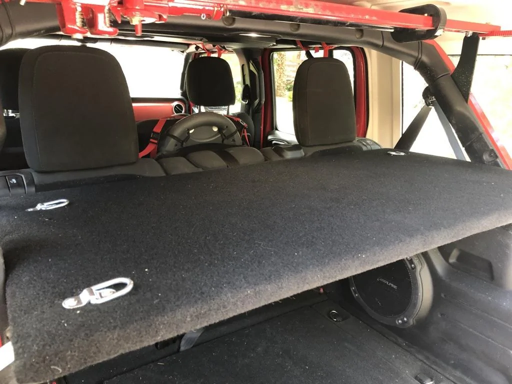

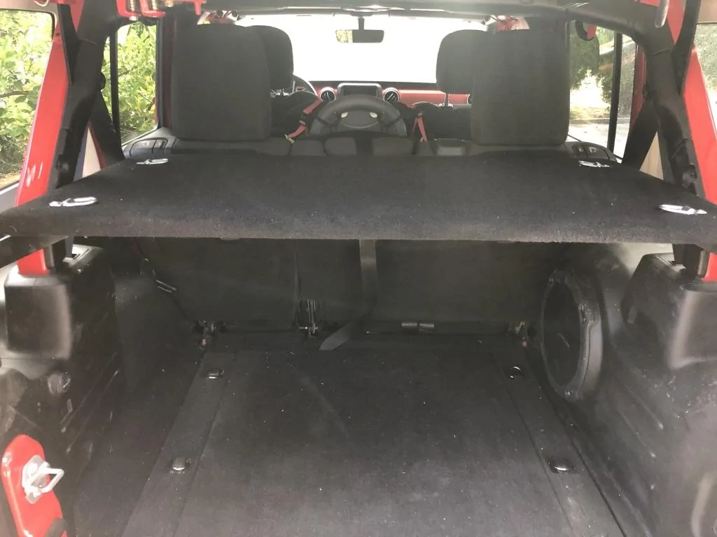

I wasn't keen on spending $300 on a basket/shelf so made my own.
- 3/4" inch Home Depot cut board
- Two aluminum flat bars
-Pepboy Interior carpet
-misc hardware
Simple install;
-Remove roof bolts and place flat bars in place.
-place the board with threaded stud through mounting holes and tighten wing nuts.
-misc hardware
Simple install;
