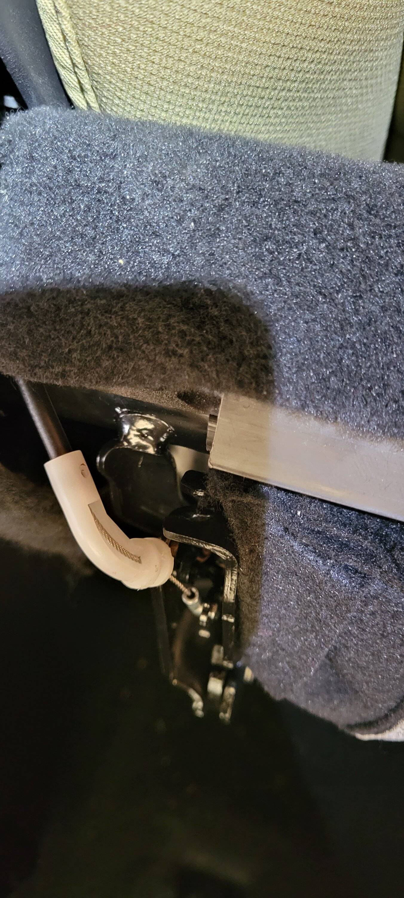

Rear seat latch won't release seat to flip up. Seems like cables are loose. Anyone know how to adjust or tighten? Thanks.

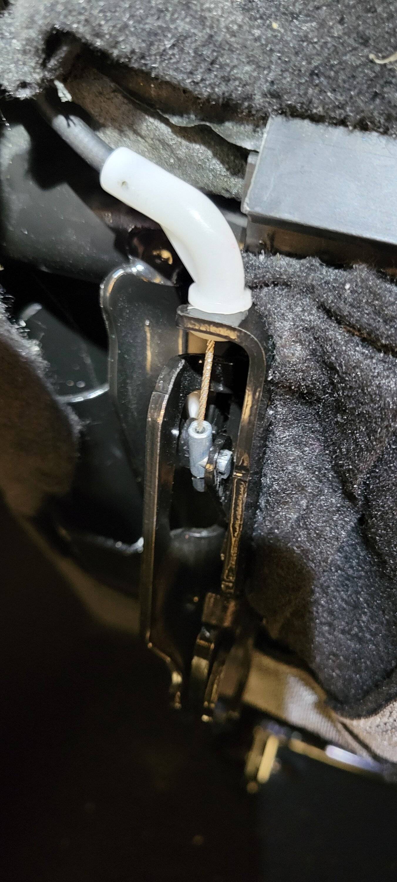

In case anyone was wondering, a small plastic elbow came out of its bracket by the left rear latch. This caused the cable to be too loose to release the bracket. You can expose the part by undoing the velcro corner of the seat corner. All fixed.
Whereabouts is that elbow on your seat? Underneath the seat or around the top corner? I have leather seats with zippers (no velcro) which I can't find the ends of... The larger back seat on my 2018 Sahara won't go down...
