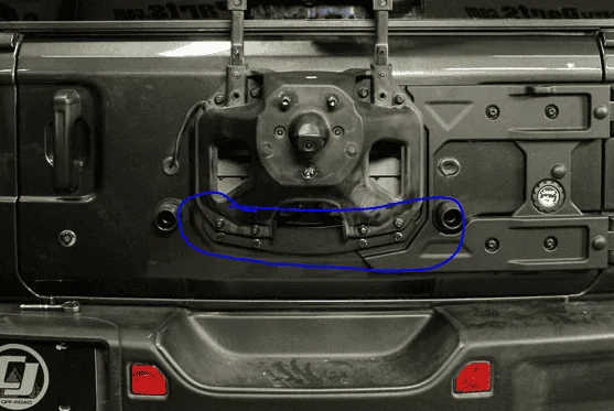

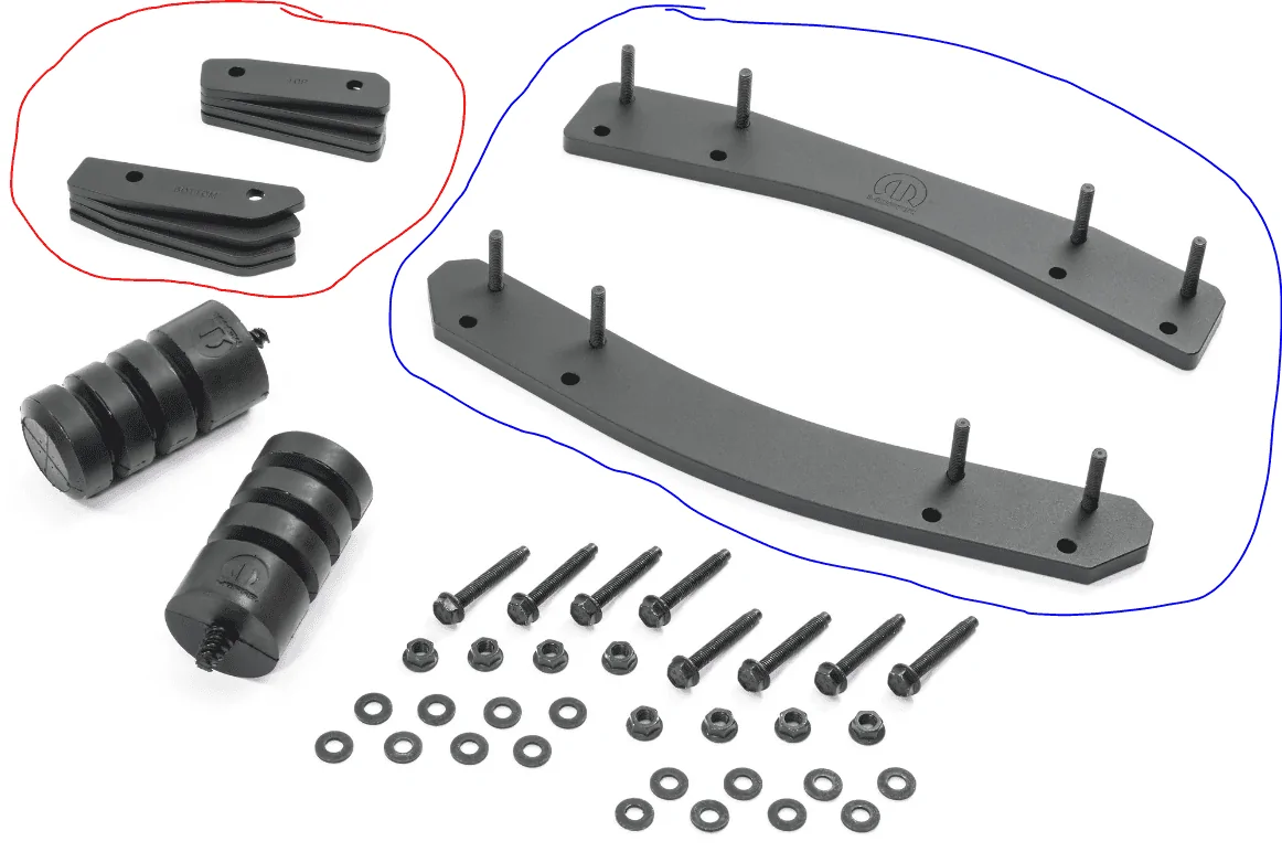

Something you can check yourself though, but you may have to take the spare off to see. Underneath the plastic tire carrier you should have spacers (circled in red). It should also have the pieces circled in blue to lift the carrier up about an inch (circled in blue).

Here is the blue circled parts installed, (you can only see them sticking out on the bottom):
Jeep Wrangler JL Rear parking sensor on JLU XR 1657030847855
If that is missing, the tire can cause the rear sensors to trigger.
If it is there, I'm not sure what would do it, perhaps the sensors are installed incorrectly.
