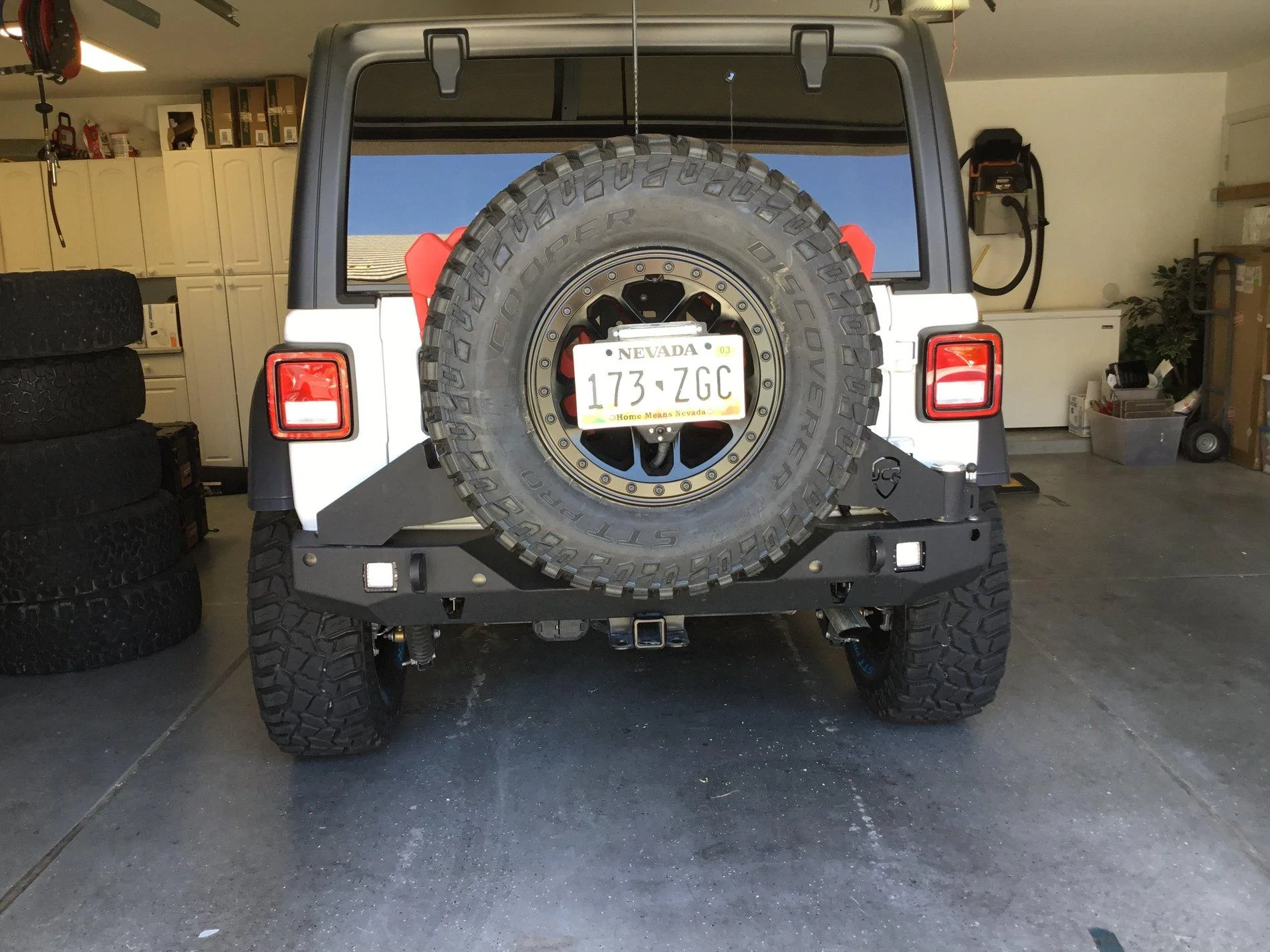

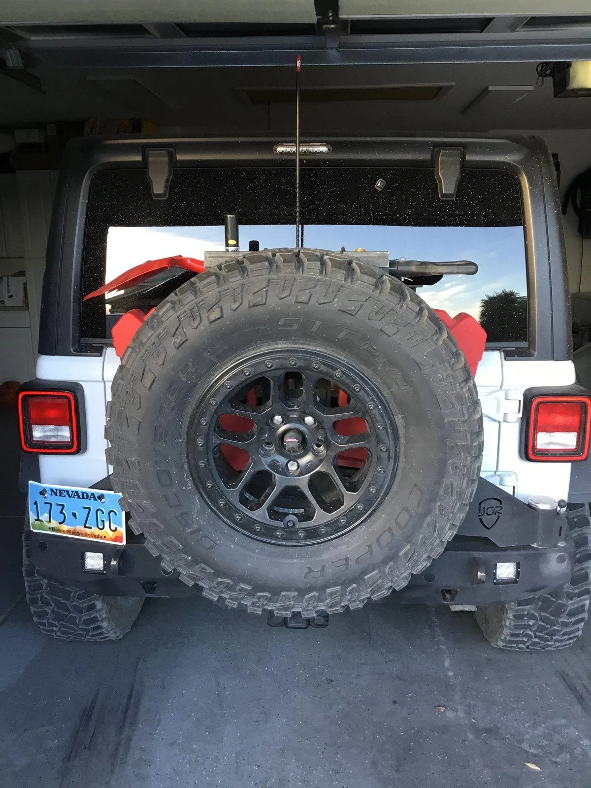

There is a quick disconnect along the existing cable a few feet from the camera end. Not sure if you saw that on your cable. Sorry no photo. I was using that in order to remove the spare, but I grew tired of the license plate, camera and third brake light needing to be removed for access to the spare. So I changed it, mounted my third brake light on the hardtop, well you can see the rest.
Good job finding the cable.
