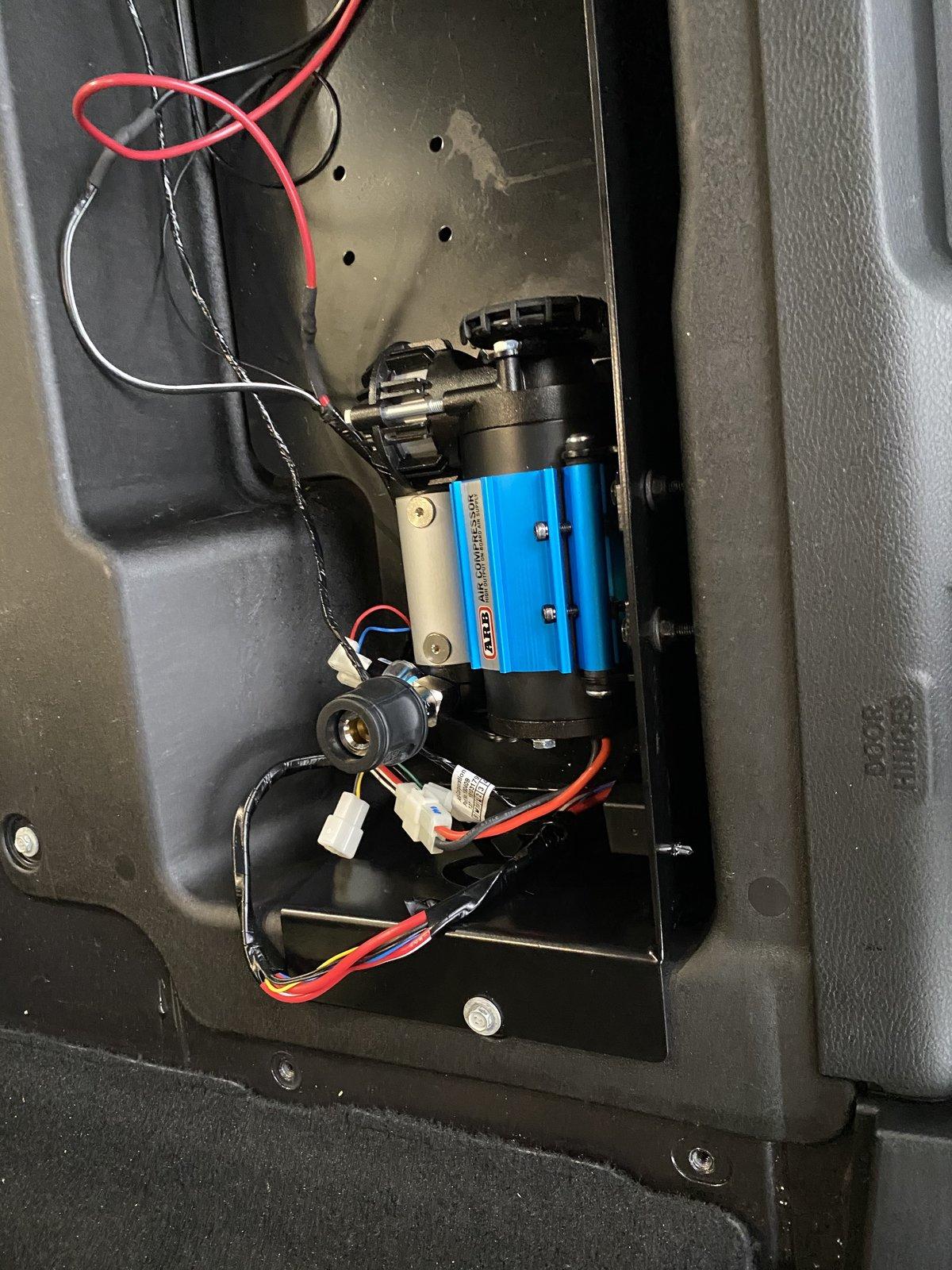

Another ARB twin air compressor user here. Have it mounted in the rear cargo area via the MORE bracket.

I also have an ARB twin air compressor with the MORE bracket installed in the rear cargo area. Works great.

Take some pics! I need visual please.

ok, I just watch and read a bunch crap on this compressor. Can this sucker be wired into aux switches that came prewired from the factory?
Yes you can hook it up to the aux buttons (or the button on the MORE mount). You'll need to run a switch wire if you want to use the Aux buttons. Each compressor can draw up to 28 amps so you'll want to run separate power and ground lines.
I basically followed this write up (except I used an aux button):
