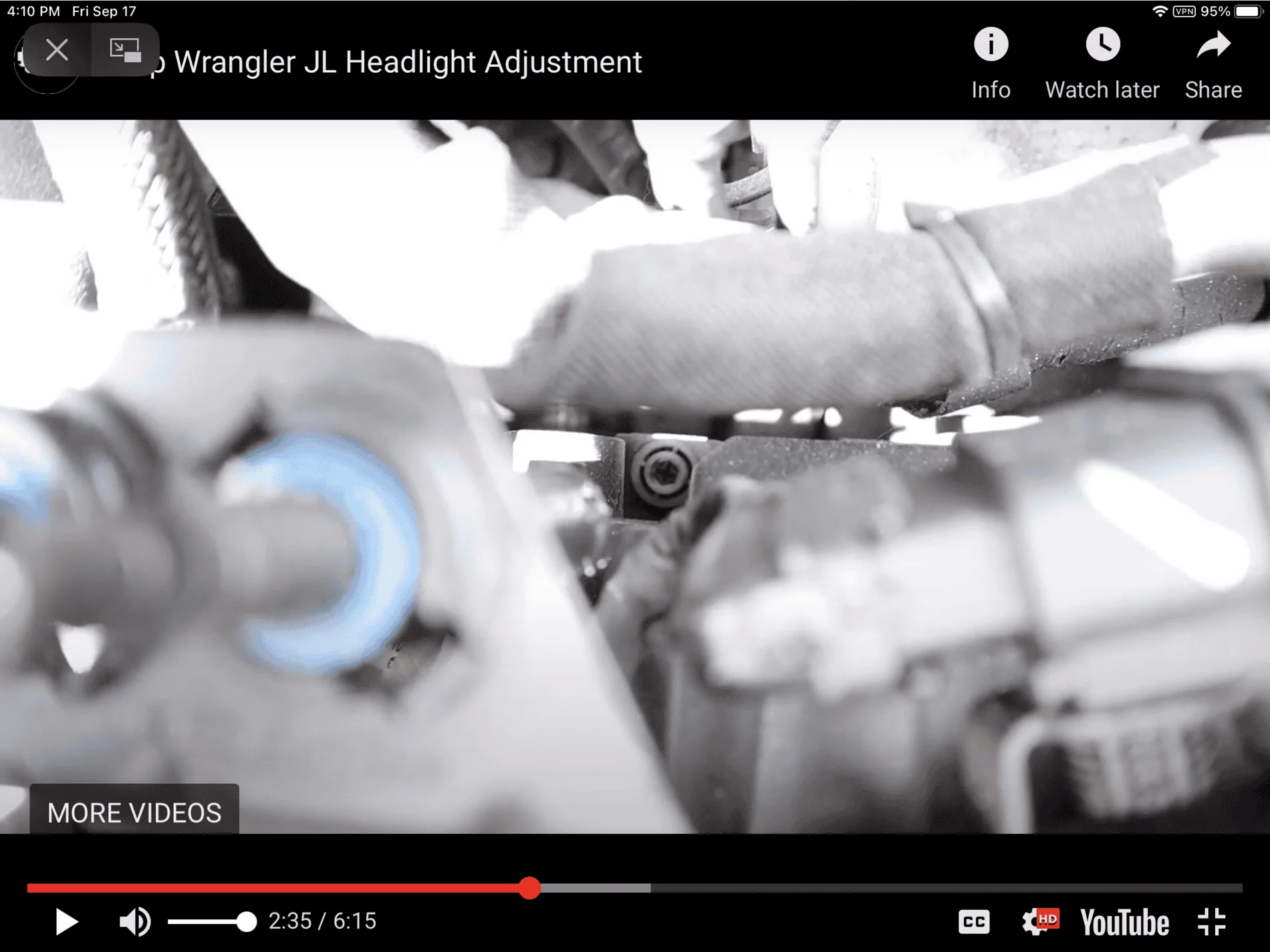

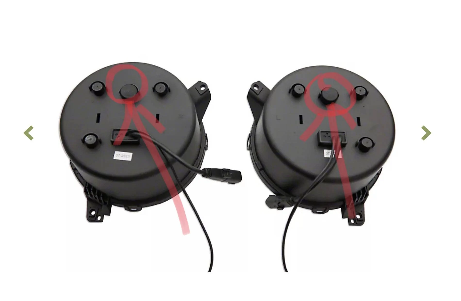

The bolts on the body your are referring to are most likely for the stock lights, on the back of the Raxiom lights there are rubber caps and under them are adjusters and the lights should have come with a wrench.
Here are the factory adjusters
Jeep Wrangler JL Raxiom led headlights adjustment A497B30B-C300-44CE-9337-F52E503B85DE
You will have to pop the caps off and park about 20’ or so away from a flat wall on level surface and do your adjustment and then put the caps back on
Jeep Wrangler JL Raxiom led headlights adjustment 055D9E95-2D92-4689-8CD8-20EEB6475431
Jeep Wrangler JL Raxiom led headlights adjustment AF1700EB-C306-4285-B4EE-B2EBE81041CD
