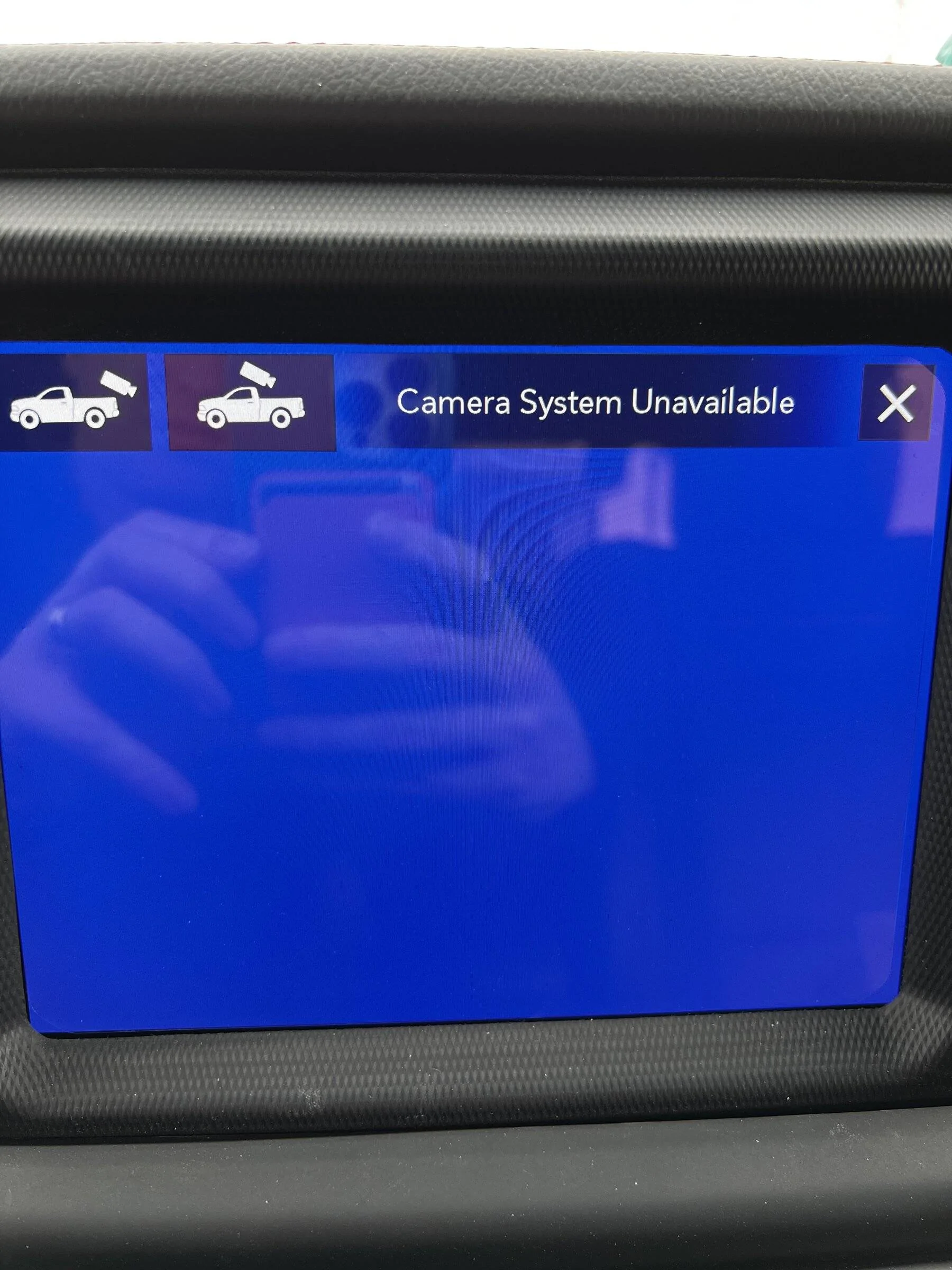

Took my 2019 in for an oil change yesterday and asked them to see if the head unit (8.4) had any updates as it is still a little glitchy (Rebooting itself periodically).
They ran a lengthy update and as I was driving home I realized the aftermarket front camera was now showing the blue screen of sadness.

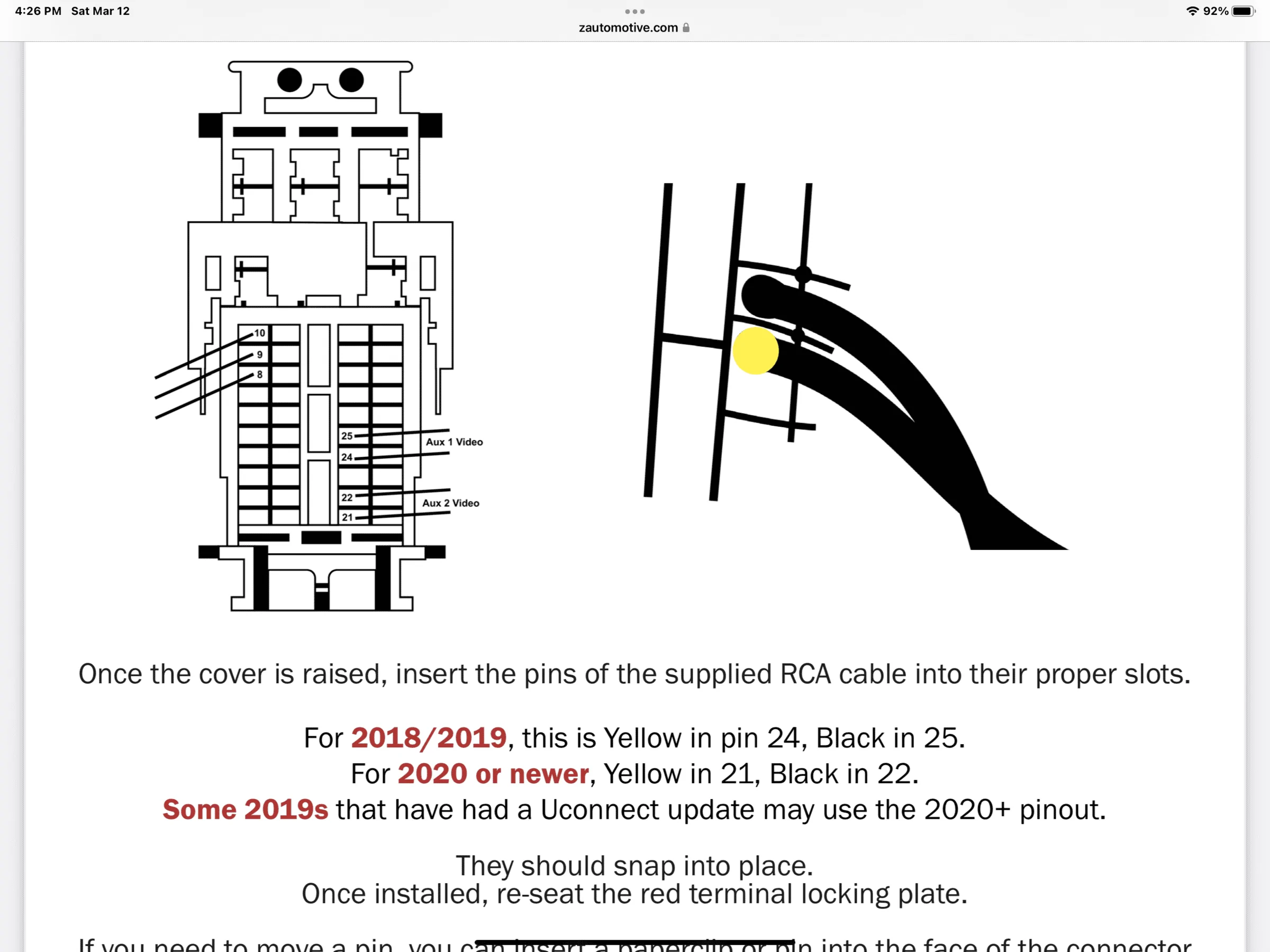

After speaking with Zautomotive (the front cam is activated through a tazer mini) it seemed the most likely cause of the issue was the radio now identifies as a 2020+ so needed the pins moving in the main plug to the head unit. I’ll say that I tried unmarrying and marrying the tazer a few times and updating the tazer firmware in case it was a software issue of some kind.
Posting in case anyone else encounters the same thing.

The solution is in the original post, the pins needed to be moved as the radio thought it was newer than it was.
