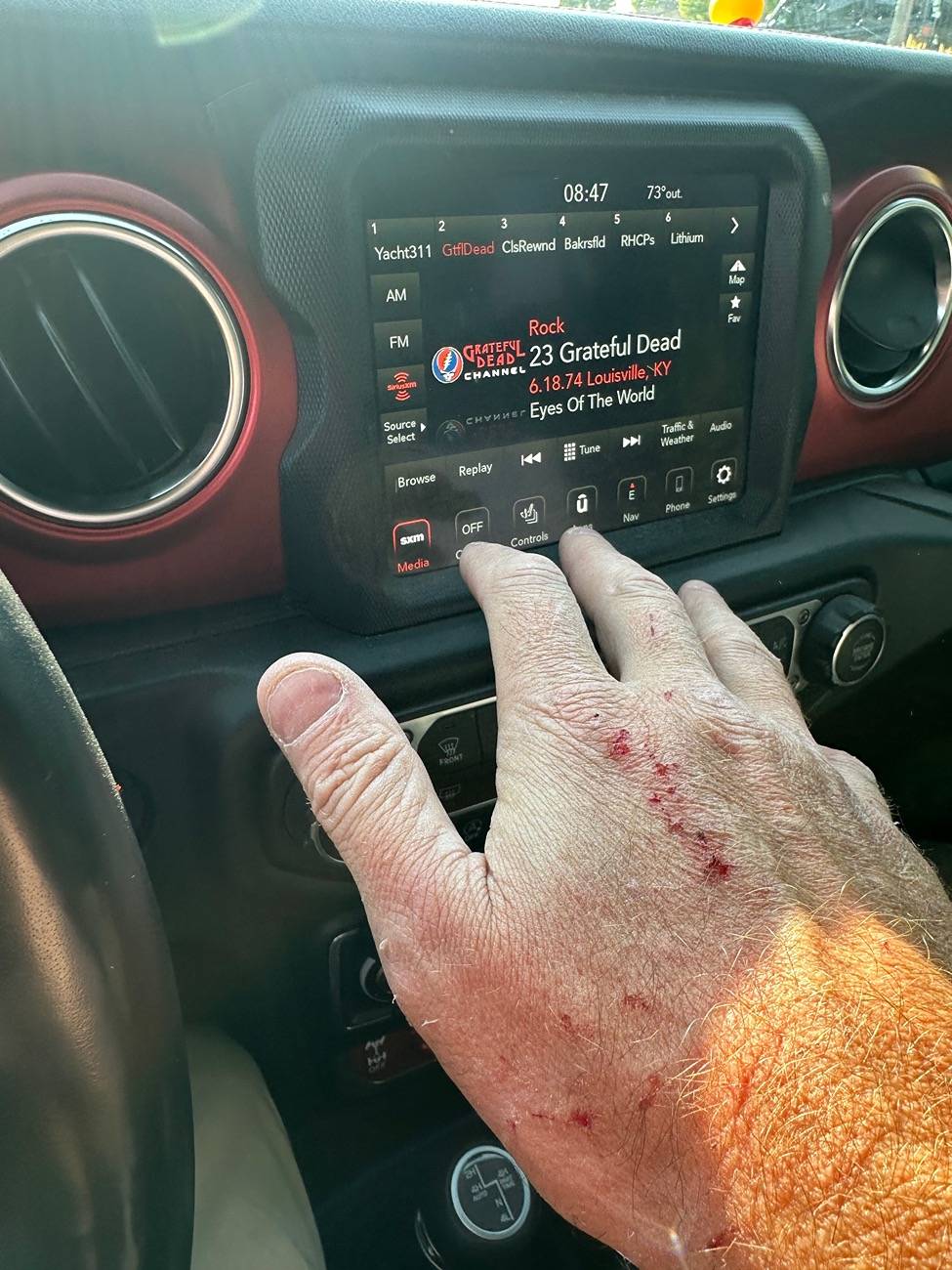

That would be nice. Only thing worse than unplugging the SGW, is plugging it back in.
Looks I’m selling this one with the Tazer connected or the head unit is bricked.
