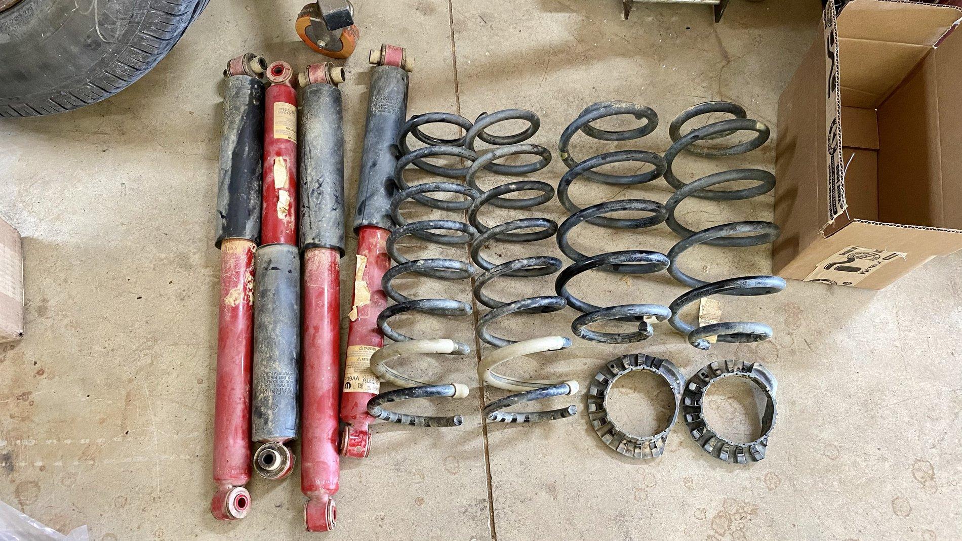

It’s a sport suspension with rubicon shocks, with heavy duty brakes.
Can confirm. Just took my springs and shocks out yesterday after I installed my lift. Sport springs and rubicon shocks.
Jeep Wrangler JL Question re: Willys suspension FF7A56A4-6375-4576-AEA7-E5F474A0209B
