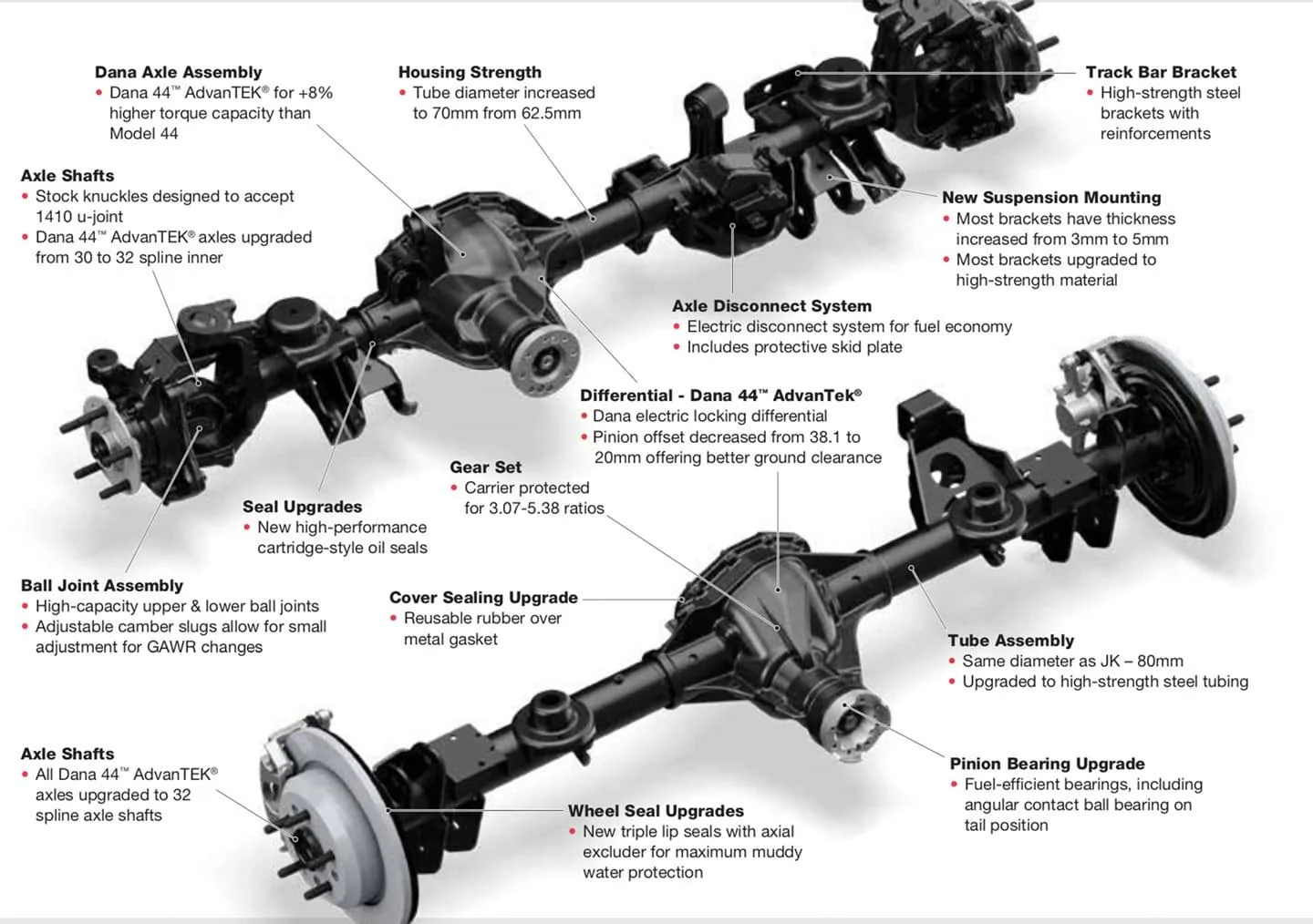

Your post doesn't mention how big is big. 35's are pretty common and probably wouldn't affect anything too much. 37's require more lift and adjustments to the spare tire carrier (if you're running the spare).
Here's an interesting (but probably not very helpful) detail of the upgraded Rubicon axles.
Jeep Wrangler JL Question about rubicon build Dana 44 JL axles
