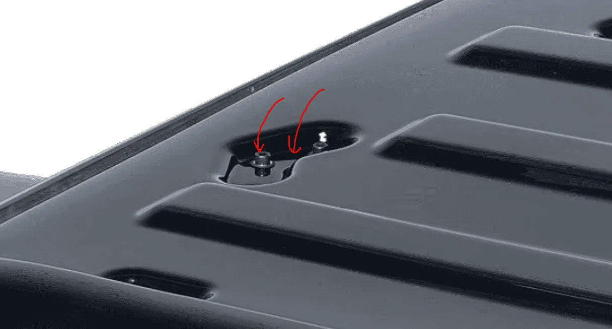

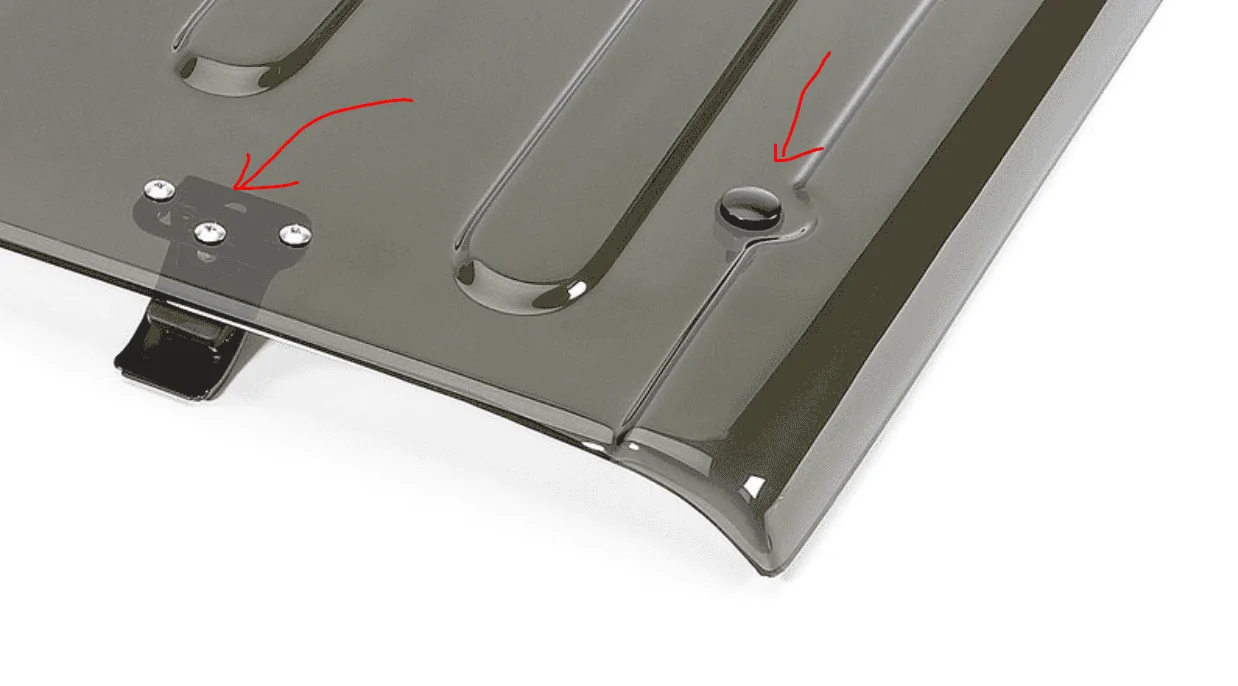

  • Attachment hardware: This is a big one and is also a deal breaker for me. Both panels use latches that attach to the panel with bolts going through the panel, but there is one BIG difference. Skyview uses 10 concave depressions (without drainage), so the metal bolts will be submerged in pooled water for hours (or days in wet climates). As a cherry on top, the bolts themselves are hex socket bolts, which means they will collect standing water inside the opening. This is going to do wonders in coastal areas. As a "bonus", the concave areas around bolts will collect crud, dirt and dust, which will be clearly visible from the inside and thus will require constant cleaning. Definitely a moronic design decision on part of whoever designed the SkyView. In contrast, ClearLidz has no concave areas and uses a combination of rounded stainless steel bolts and a flat bolts (possibly with a plastic cap):
Skyview:
Jeep Wrangler JL Putco Element Sky View 1676134656071
ClearLidz:
Jeep Wrangler JL Putco Element Sky View 1676134727861

Spoke to a Putco rep who said they have better tint and quality ??‍♂ not sure how substantial 16 vs. 18 % is but he did mention the bolts have a rubber surround and the wind should clear the dipped areas.

When I have an extra $1,5K, I'll go with Clearlidz as well. Seems like a better design and the arguments that Putco rep provided do not sound legitimate. The "better tint" statement is subjective without any info to back it up - I have yet to see a company that said their product is "worse" than a competitor's product. Not sure what he meant around bolts having rubber surrounds - their pics clearly show metal bolts. Maybe rubber gaskets? That's even worse. The wind argument is not valid either. Obviously the dirt and crud accumulate in depressions only when the Jeep is parked.

Just came across this one today and overall, I do like the tool-less design of the Putco a lot better with no need for additional spacers above the doors. Not really a fan of all the recessed attachment points that will inevitably collect rain/snow/dirt, but mostly because it just ruins the cleaner look of an OEM Freedom Panel. The Clearlidz looks a lot nicer in this regard.

Agreed, Putco's integrated spacer is a better look in the interior but I went ahead with Clearlidz anyways since they don't have exposed bolts and I preferred the brown-ish tint over the blue/gray. They don't come with a drainage channel simply bc I don't think they want anything mounted there but it definitely would've completed the look.
