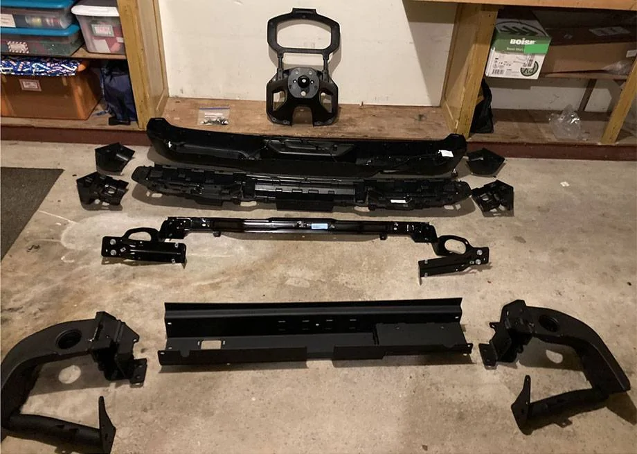

First I decided to tackle... let's get that stock bumper off!
Jeep Wrangler JL Project Redemptrix [Tentative Name] jpkp-JLR-bprgone
This was a far more tedious process than I expected. There are some good youtube videos explaining the process. I watched some and proceeded to try to find my own way. Turns out, after much trial and time wasting, those videos were pretty spot on. A harsh reminder that I'm an engineer, not a mechanic. But the worst was to come...
Jeep Wrangler JL Project Redemptrix [Tentative Name] jpkp-JLR-bprparts
The stock plastic bumper is held together by an obscene number of 9mm hex head sheet metal screws. I had an 8mm socket, a 10mm socket, and no open tool stores nearby. So I had to use a pair of pliers to unscrew each screw... and so a 20 minute job became a 2 hour job. But, I got the stock bumper off, extracted the wire harness and park sensors, and took off the stock tire carrier to boot! There's a trick to getting the camera out... the holes where the two small screws keeping the lug stud plate need to be pressed out... NOT the holes where the lug studs go through. In the above picture, we have the interlocking pieces of the stock plastic bumper on top, and the steel AEV bumper pieces at the bottom of the pic.
Getting the AEV RX Bumper on was a real test of my dexterity, patience, and humidity tolerance. But here was the end result:

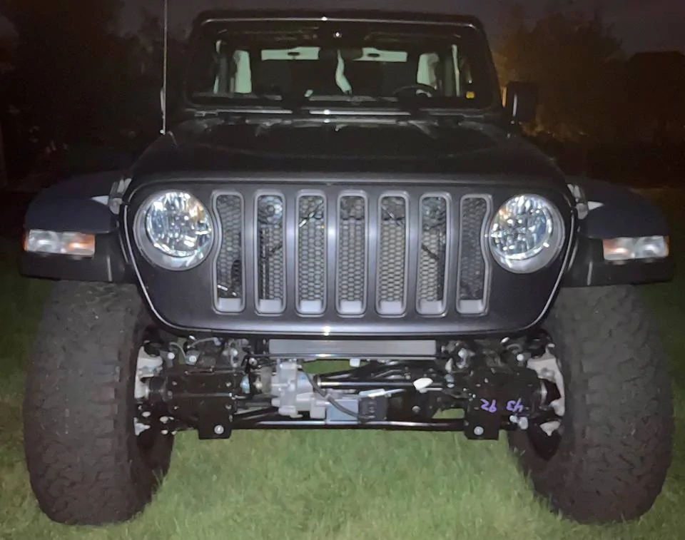

So to this point, I've made much progress with Project Redemptrix and am getting quite excited to put this Jeep to good use. In anticipation of a new steel front bumper, I went ahead and made room for it, finishing up just as evening made its way to night:
Jeep Wrangler JL Project Redemptrix [Tentative Name] jpkp-JLR-bumperless
