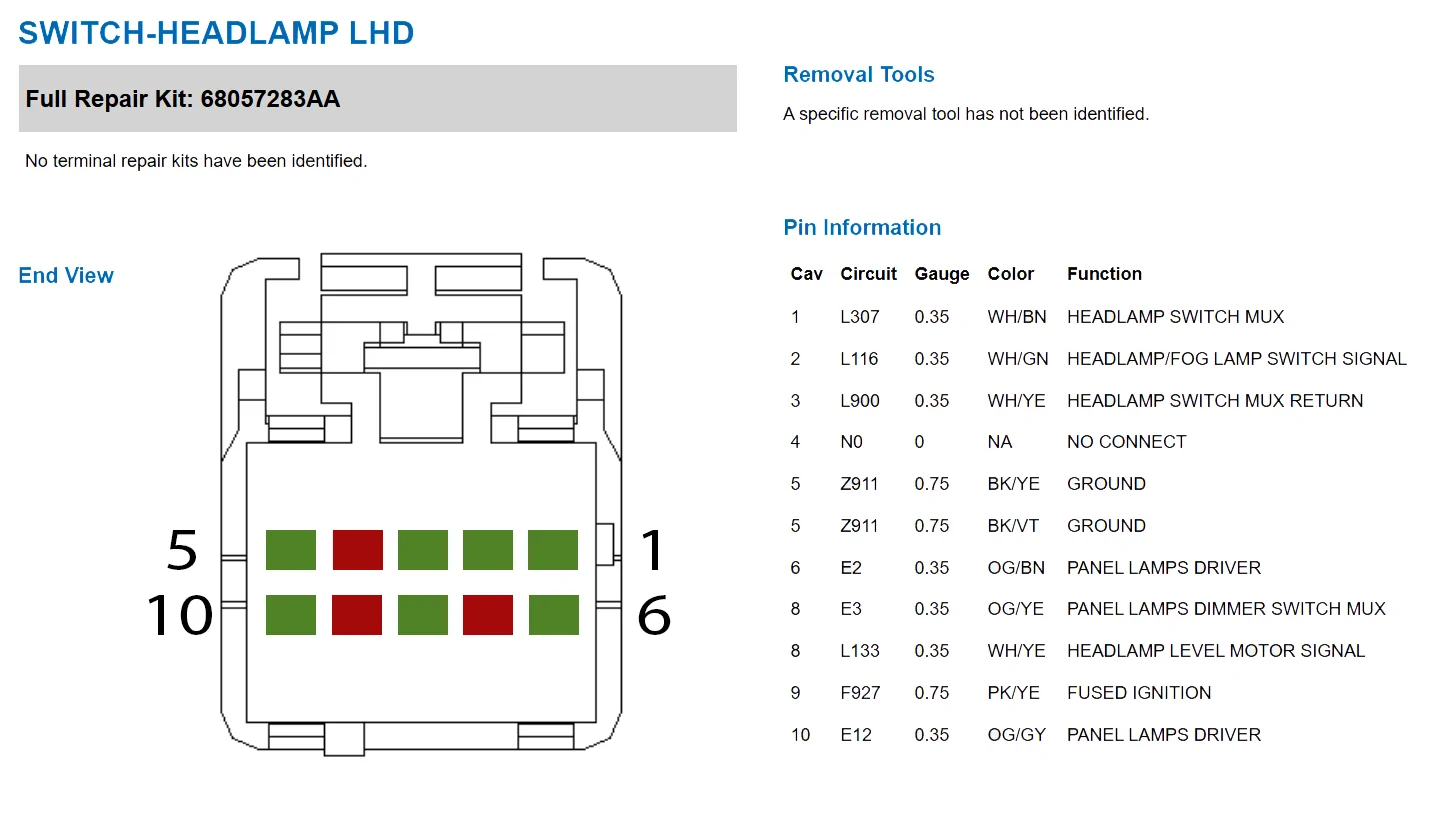

I have this type of Headlamp Switch - P68292842AC
Jeep Wrangler JL Headlights, Fog Lights and Interior Backlights Headlight Switch Panel

I checked the wiring from the Headlamp Switch to the BCM with a multimeter. All pins are correctly connected to each other. ✅
HEADLAMP SWITCH

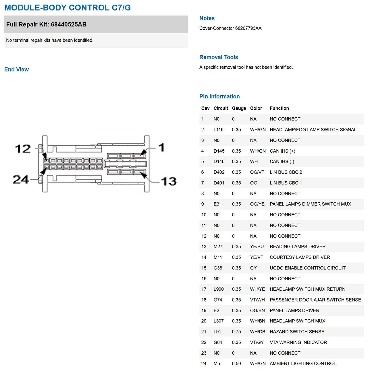

Body Control Module
DESCRIPTION
1​
20​
HEADLAMP SWITCH MUX
2​
2​
HEADLAMP/FOG LAMP SWITCH SIGNAL
3​
17​
HEADLAMP SWITCH MUX RETURN
4​
NO PIN ON SWITCH
5​
GROUND
6​
19​
PANEL LAMPS DRIVER
7​
NO PIN ON SWITCH
8​
9​
PANEL LAMPS DIMMER SWITCH MUX
9​
NO PIN ON SWITCH
10​
6​
PANEL LAMPS DRIVER (CLUSTER) (NOT BCM)
Jeep Wrangler JL Headlights, Fog Lights and Interior Backlights Headlamp Switch
Jeep Wrangler JL Headlights, Fog Lights and Interior Backlights BCM C7 G

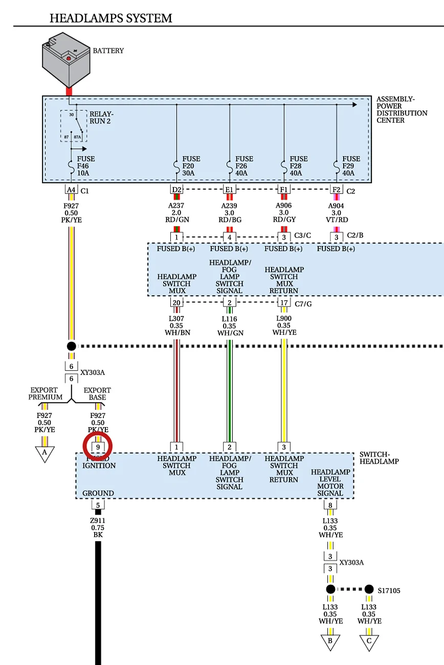

But in my case, PIN 9 is missing on the Headlamp Switch.
Jeep Wrangler JL Headlights, Fog Lights and Interior Backlights Fuse F46 Pin 9
Update:
I checked Fuse F46, it works.
