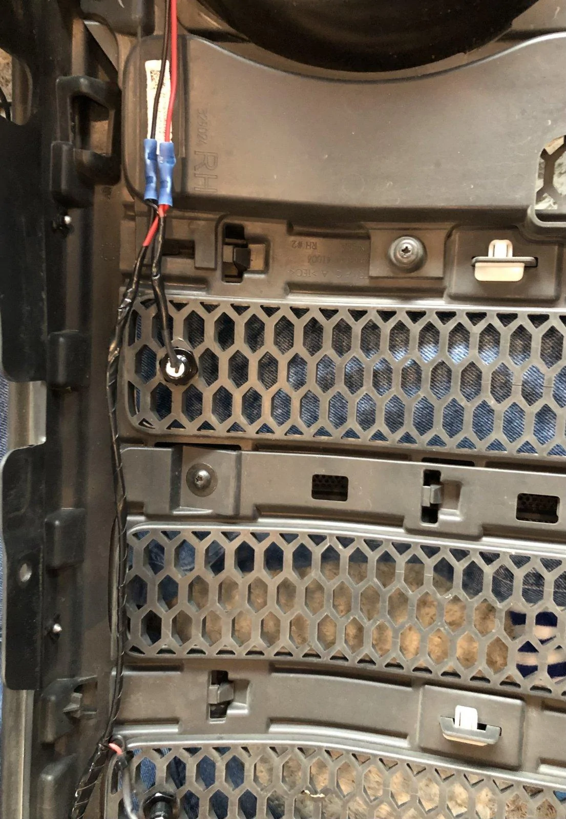

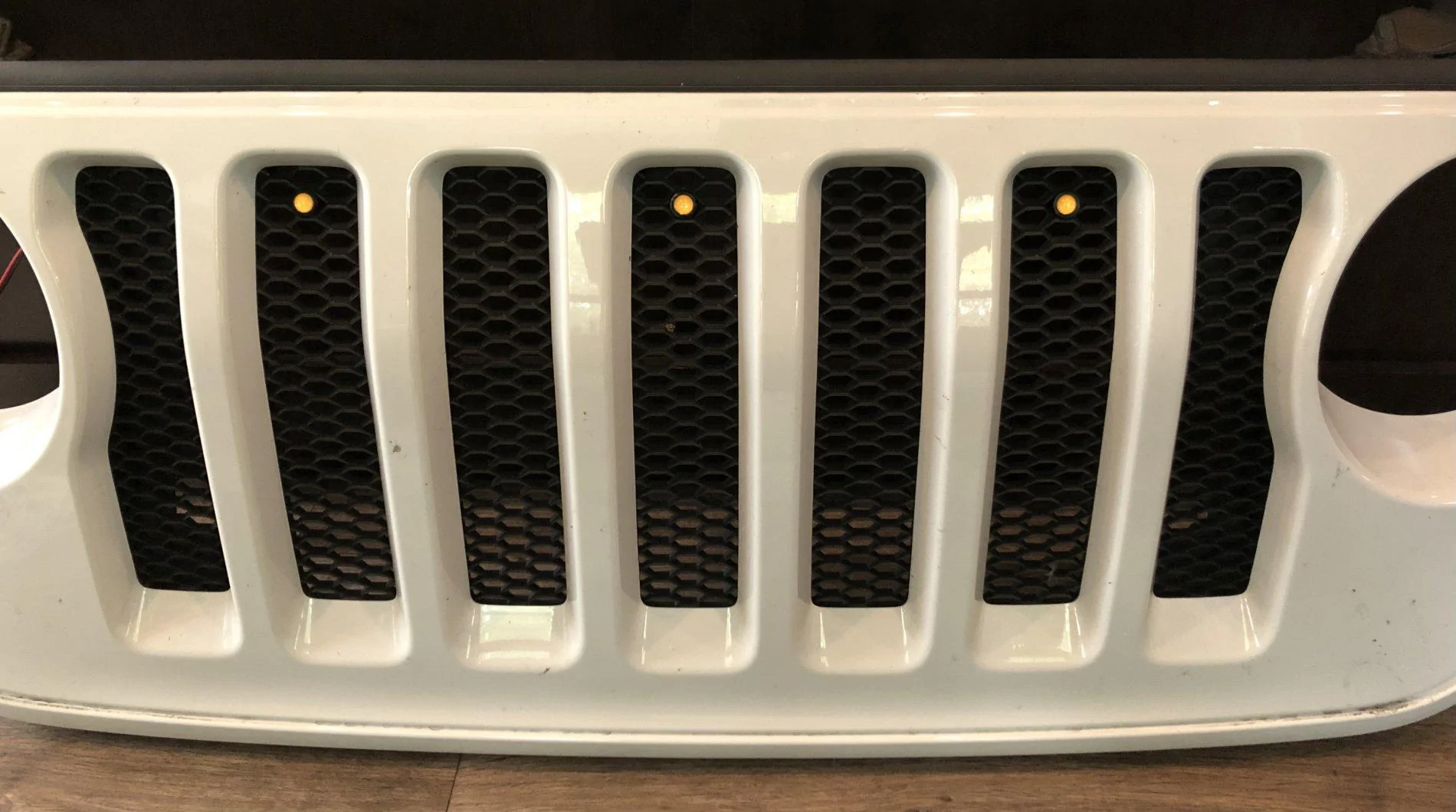

3 - Super Bright LED Light Bolts 12 A-B Amber Black ($2.95 each)
ST1C-2418 (T-Connector) ($0.75 for 4)
18G Wire
Step 1: Remove Grille

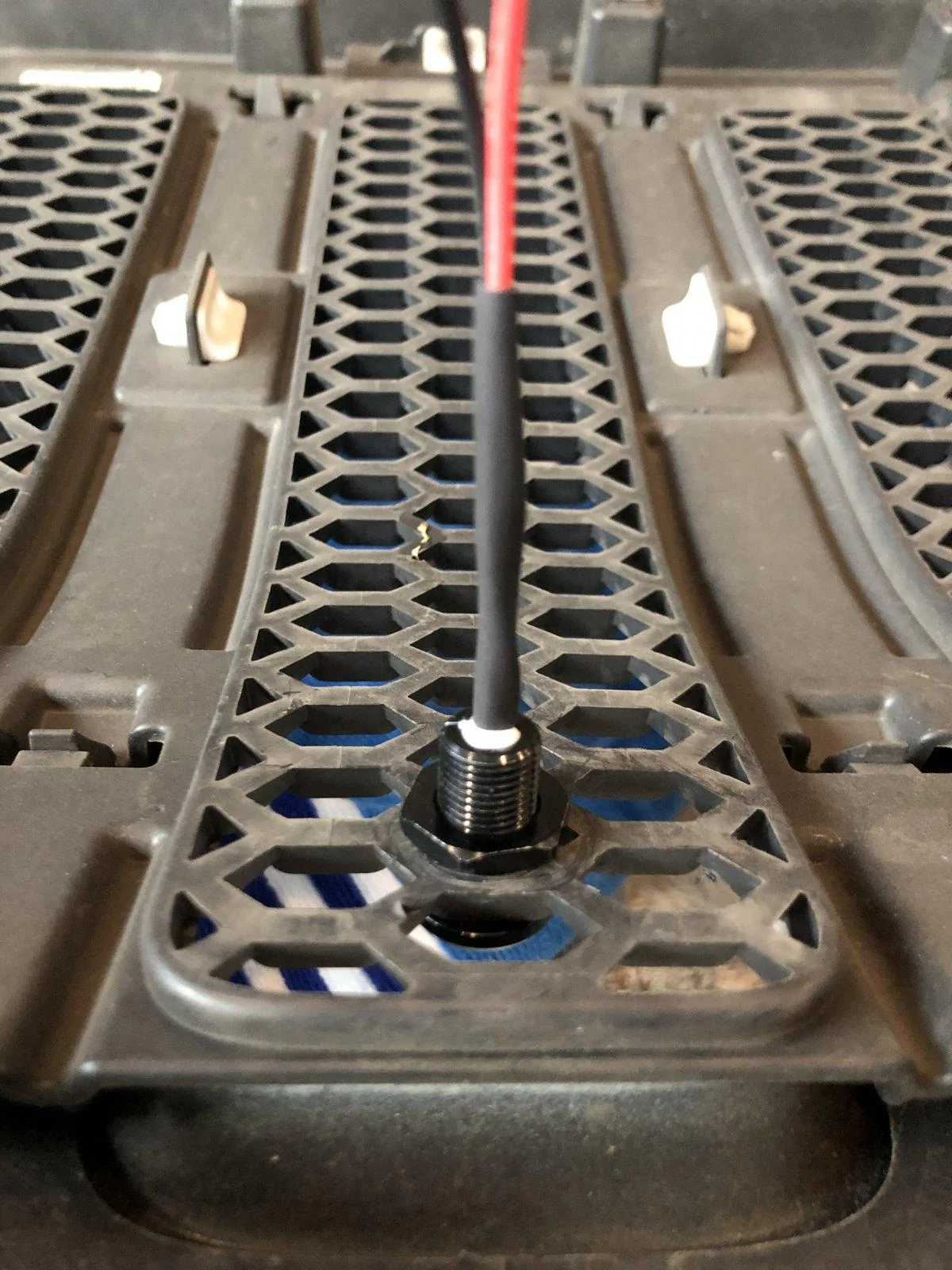

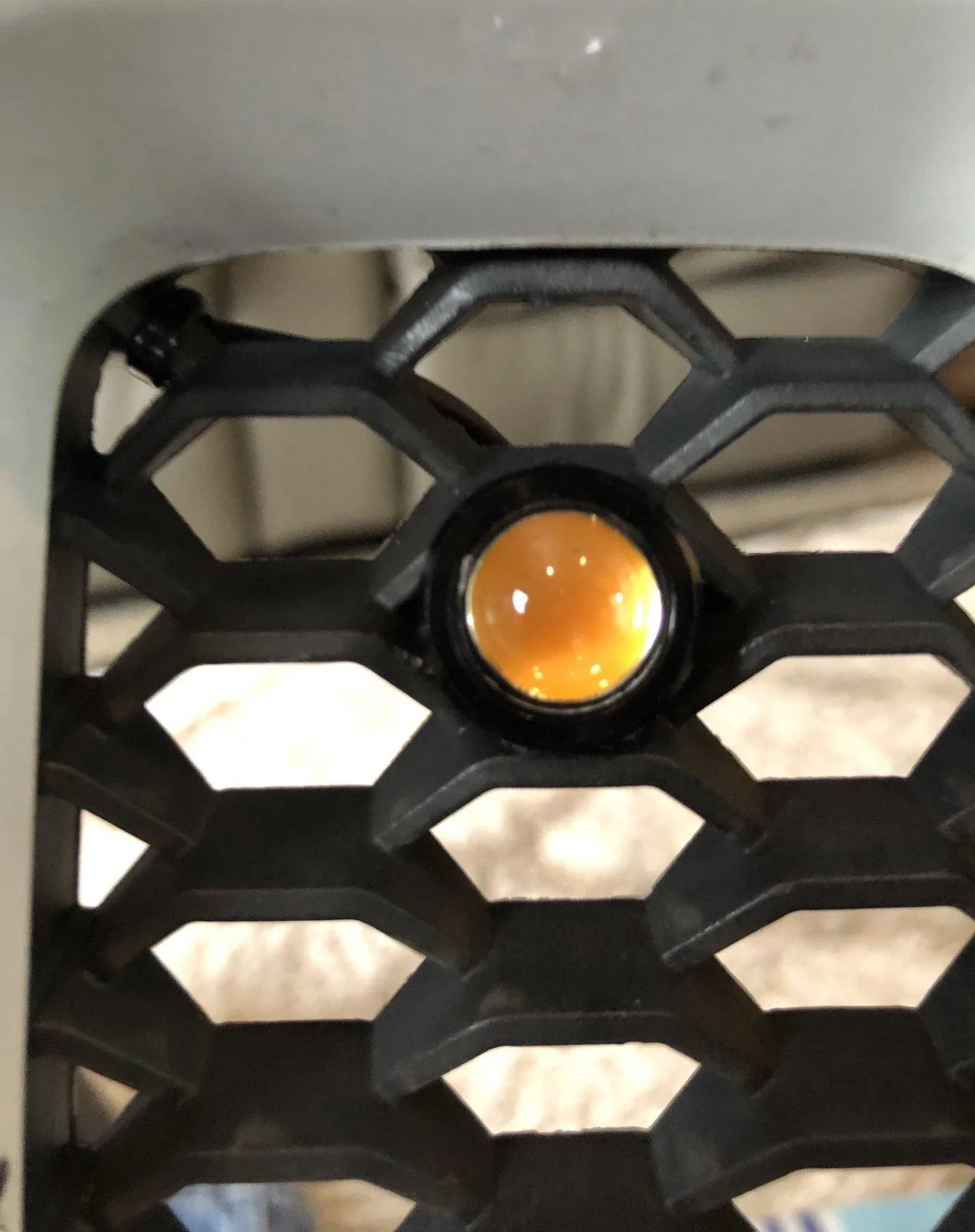

Step 2: Needed to open the hole in grill just a bit. Reamed just a bit with needle nose pliers.
Step 3: Put LEB Bolts through Hole. Secure with 11/16ā€ deep socket. (Picture 1)
Step 4: Connect Red wires and Black wires with long length (3-4’) 18G wire on passenger side
Step 5: Test lights before reinstalling
Step 6: Reinstall Grille
Step 7: Run Black wire to ground bolt
Step 8: Run Red wire to passenger side marker light (White with Brown wire). You will need to pull back the fender liner to access.
Under $10 (less tax and shipping) Had the extra wire.

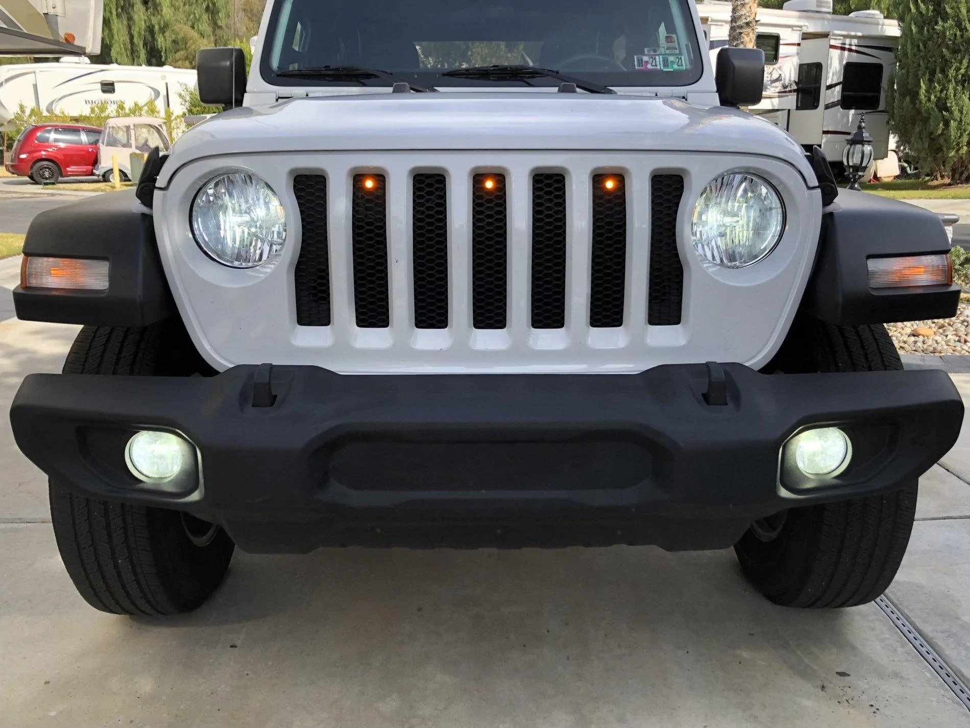

Also updated the Head lights and Fog lights with Oracle LEDā€˜s!
