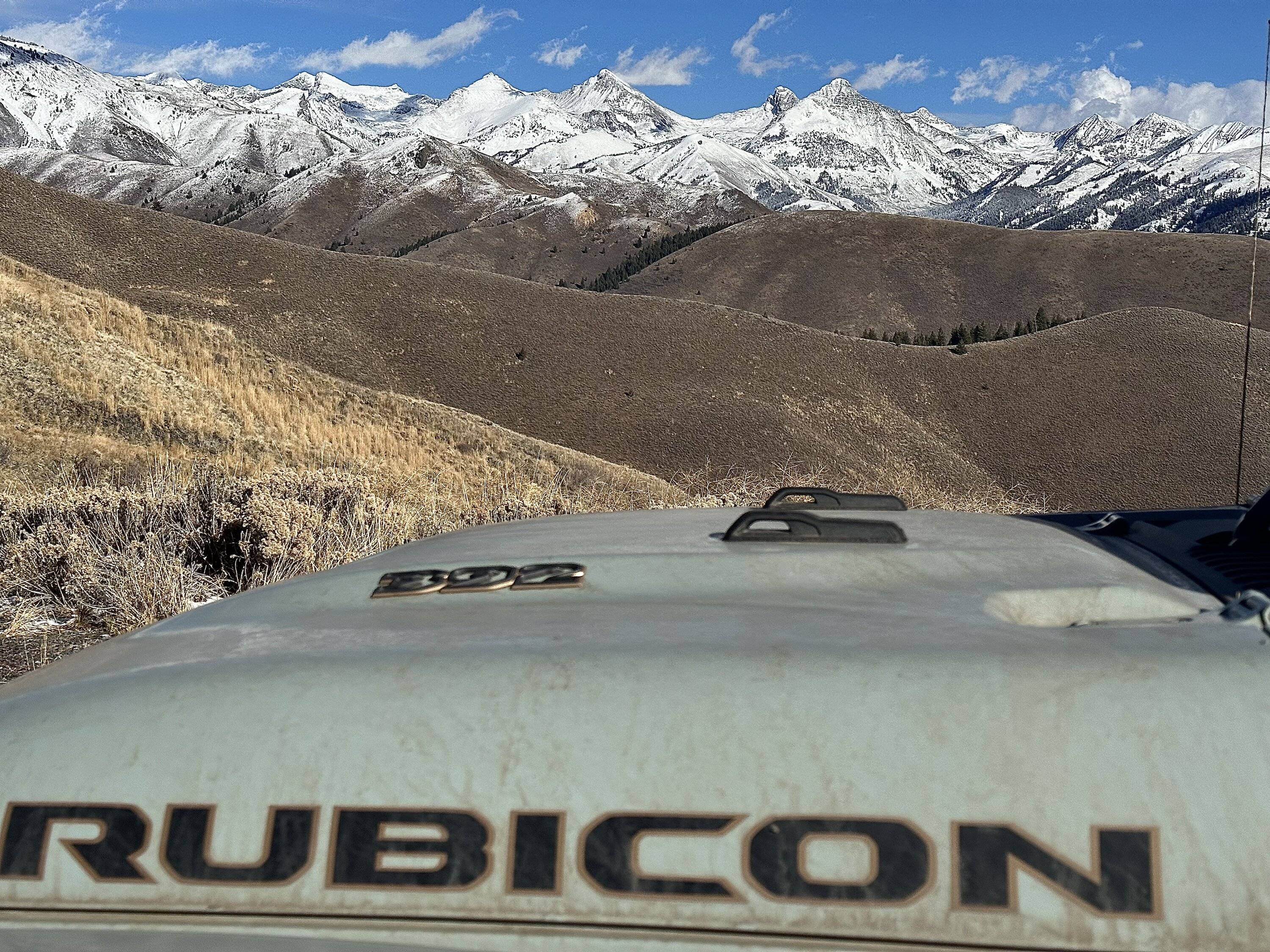

In my '23 AEV 392, I would get this message after long climbs [1600' vertical easy low range], even in 61-80F weather. Jeep's respone to my dealer was sic- just stop and wait [like charging a Tesla]. I have a Jeep to get me out not just Way Back In. Anyone else have this problem? I havent found threads in simillar circumstance.

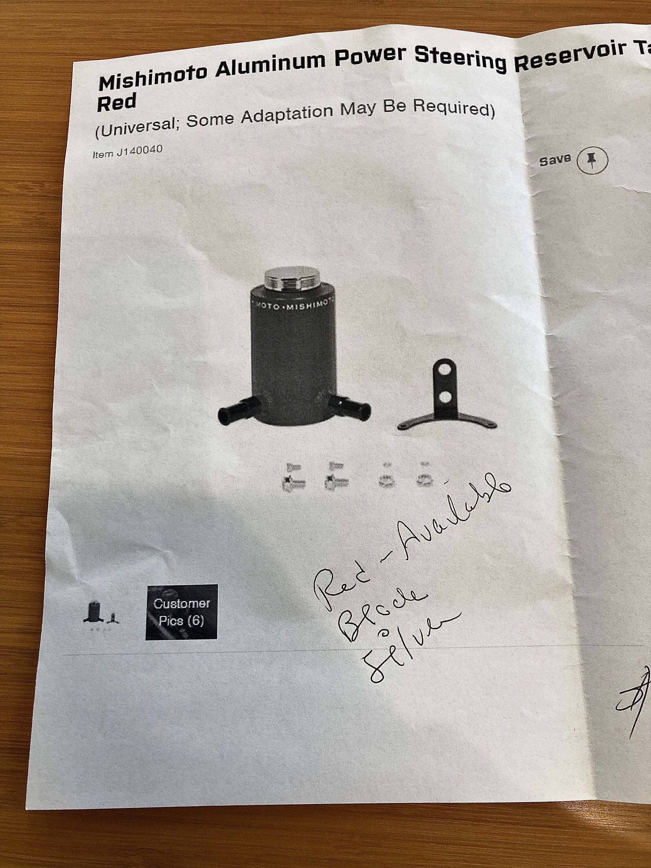

My dealer found a power steering extra reservoir tank we installed in my '24 AEV 392. It's winter here so won't know til the nasty mountain tracks open in June nor July.

I added a fan in front of my PS Pump and have never had a problem since.
