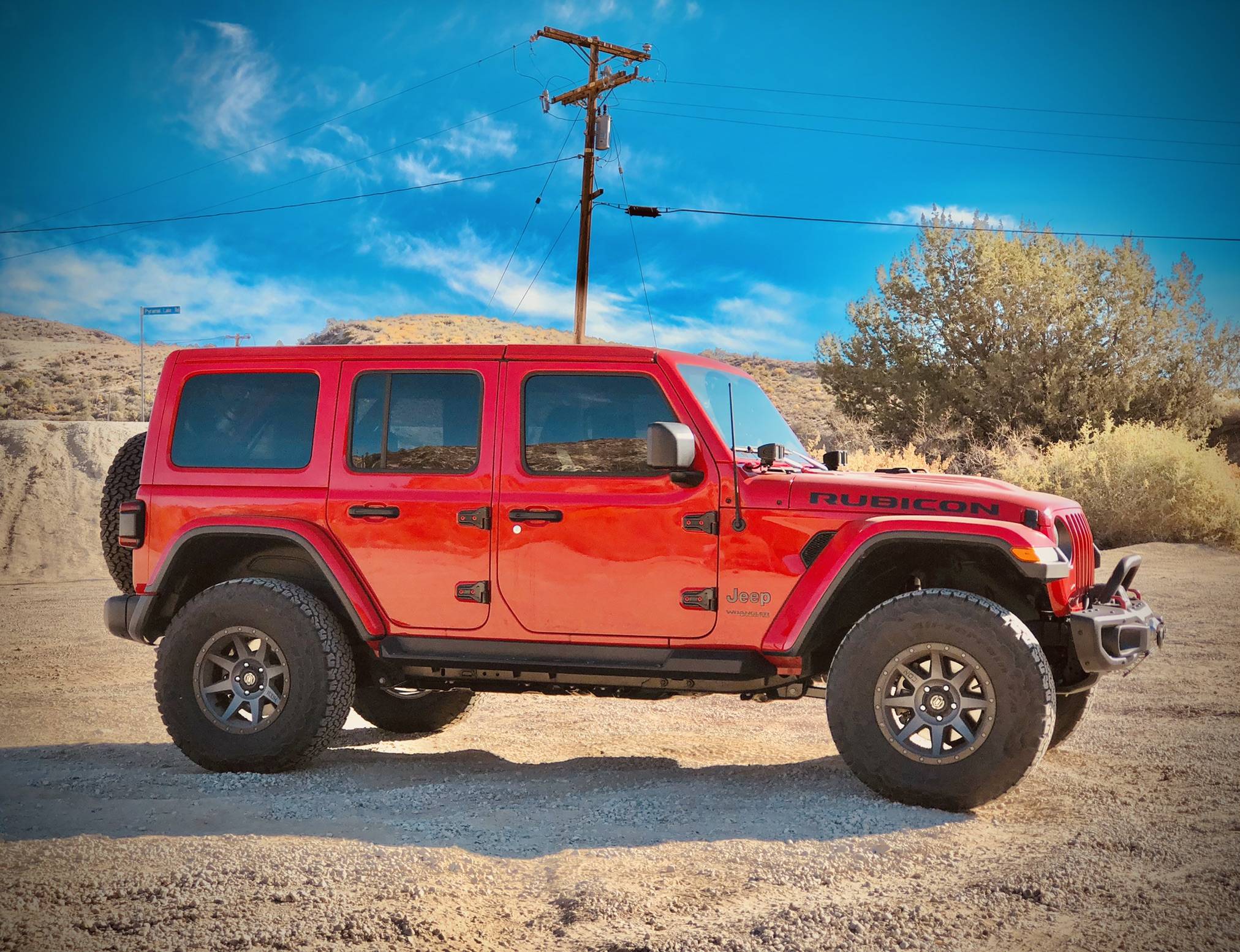

After installing said bumper and winch, look at it and make some measurements before making a decision.
If you still want to go ahead with it, I would suggest spring spacers rather than different springs for the front so your ride dynamics remain the same instead of having different kinds of springs in the rear and in the front. I put on a set of 1/2” Teraflex spacers after putting on my 12k winch in my oem steel bumper and I am happy.

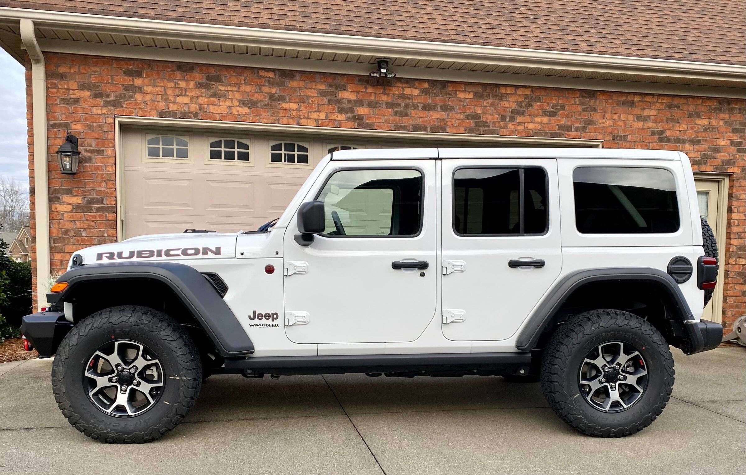

I installed my bumper and winch yesterday and, as expected, the front dropped 1/2". I am going to install a 3/4" front level this coming weekend.
I'll try to remember before and after pictures.

As promised, as follows are the before and after images of the level kit. I hate that I didn't get the photo angle the same. But, if you look at the roofline relative to the top of the garage door, you'll see the more significant rake of the Unlimited Rubicon after the winch install and before the level kit compared to the post level kit (second image).
