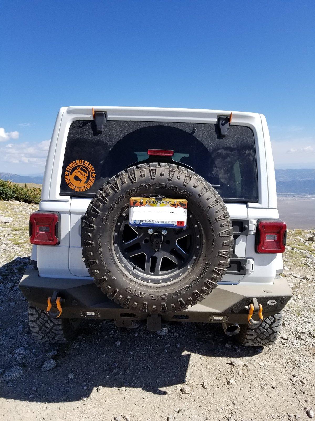

Jeep Wrangler JL Picking up power for plate light phone pics 702_LI
For anyone who has already done this - Where is the past place to pick up power for the light on a license plate? I relocated my plate (Artec Mount) to the spare tire above the camera.
Simply tap into the jeeps license plate OEM wiring. I have the same mount. You run the wires through the tire, then through the tailgate harness. Drop the wires down through the passenger side taillight to under the Jeep. Find your OEM harness and splice wires directly there.
