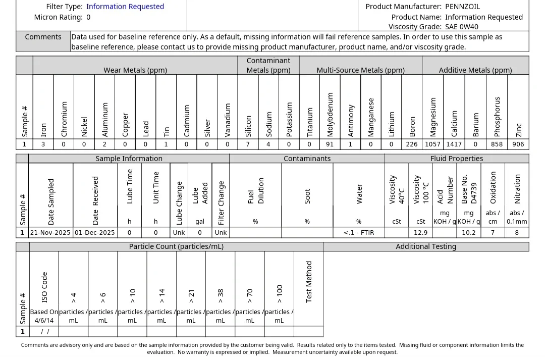

I am creating a seperate thread on this topic just in case someone in future searches for it online.
So before putting the oil in the engine I took a virgin sample and this is how the report looks . Trace amounts of Iron and Aluminum were in the oil already. So I will substract those when I get a used oil analysis report. Plus I will inspect the filter and the magnetic drain plug.
What a beautiful oil, has lots of everything
VOA: Pennzoil Platinum Euro 0W-40, prodution date May 2025
Jeep Wrangler JL Pentastar PUG and 0W-40 Screenshot_20251202_120222_Adobe Acrobat(1)

Guys, I was wrong. This is the oil that went to my Jeep. That first VOA was the one that I thought I contaminated so I reported to them to discard it and give me a replacement kit. They sent me a replacement kit without charge but they didn't discard the first sample.
Jeep Wrangler JL Pentastar PUG and 0W-40 Screenshot_20251203_203444_Adobe Acrobat
