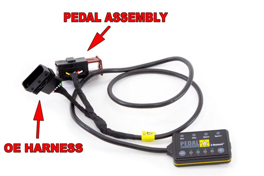

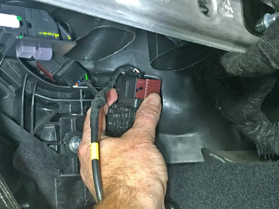

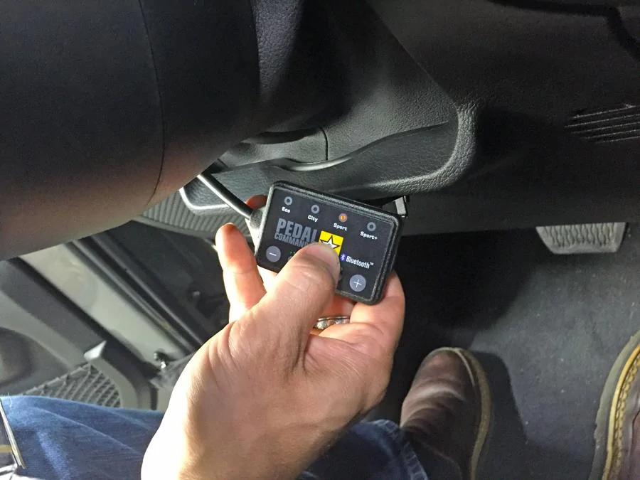

The Pedal Commander is a throttle sensitivity booster. They make the OE throttle pedal assembly more sensitive to your pedal input and reduces the pedal lag (the amount of time from pedal input to computer reading that input).
These newer drive-by-wire engine have the computer interpreting how much throttle input the engine sees. By installing a sensitivity booster, you are fooling the computer into thinking it is getting the input at a faster rate. so the computer tells the engine to go, NOW.
You could drive around town mashing the pedal to the floor each time, but it will not equal the effect a sensitivity booster has on reducing the lag.

I purchased and removed after a couple days. With a manual and the super light flywheel, it was already too sensitive and hard to control. I was hoping it would reduce rev hang but it didn't.
I recently changed to the Centerforce flywheel and clutch and the throttle is much more controllable now.
Things might be totally different with an Automatic, but for 6-speed Jeeps, I didn't personally find it helpful.

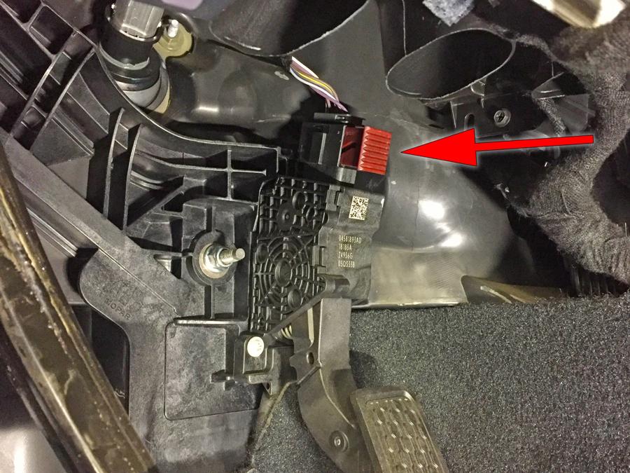

To clarify, every TPPS (throttle pedal position sensor) I've ever come across has contained 1-3 0-5v sensors inside. As you roll into the throttle the voltage output changes from .5 to 4.5 and the redundant sensors typically move in the opposite direction. Multiple sensors reduce the likelihood of a Toyota like intended acceleration issue.
Throttle modifiers like this take the voltage output of the TPPS and modify it. At 10% throttle the pedal may output 1v to the ECU. The modifier can take that 1v and change it to 4.5v, telling the ECU that you are at WOT 100% throttle pedal instead of the actual 10%.
Is that faster than mashing your foot to the floor? Yeah, it probably shaves a handful of milliseconds off the time. The engine isn't making any more power, it can't rev any quicker, it's simply making your foot a fraction of a second faster.
On a butt dyno it may be impressive. On a prepared track with timing lights, I doubt you would see any metric improve in acceleration, accept maybe your reaction time. Even 0-30 would be near identical and 1/4 mile would be unimproved.
It is a throttle modifier as it claims to be. It's not snake oil, but it's also not magic and it didn't float my personal boat. Others have really really enjoyed it. Personal preference

Excellent explanation of how they work!
Agree with them not being snake oil and not being magic either. They are what they do, which is reduce pedal lag. My best analogy is they feel like they add horsepower, but they don't.
Do not agree with the lack of performance claims. It may not make a difference with a manual trans truck, however on an automatic they launch much harder and get up moving much faster. It may not shave seconds off a 0-30 or 1/4 mile time, but the harder/faster launch will definitely improve any stop -> go speed trials.
I've installed three different throttle sensitivity boosters and driven the vehicles hard testing them out. All worked as claimed and all felt a little different.
