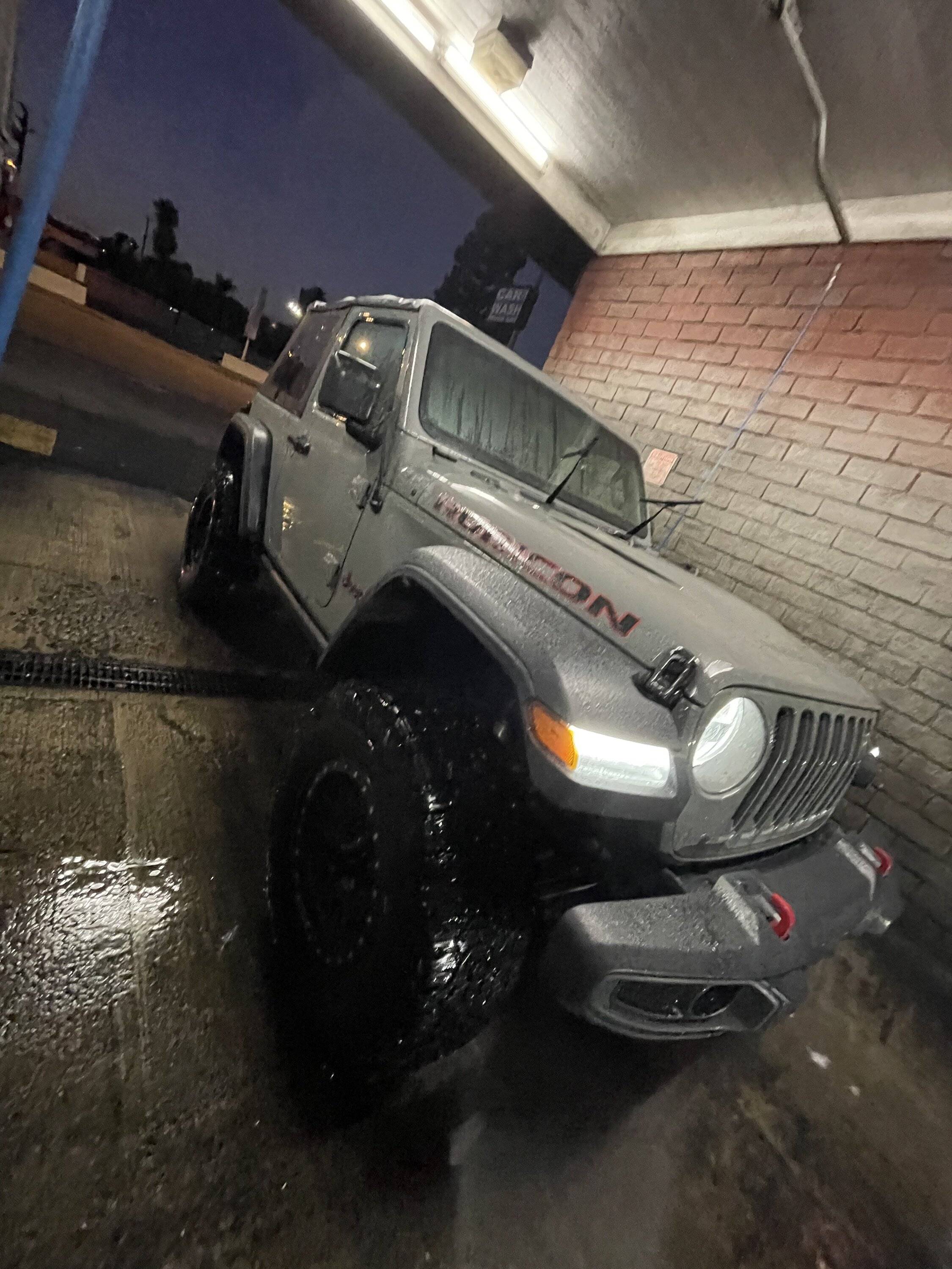

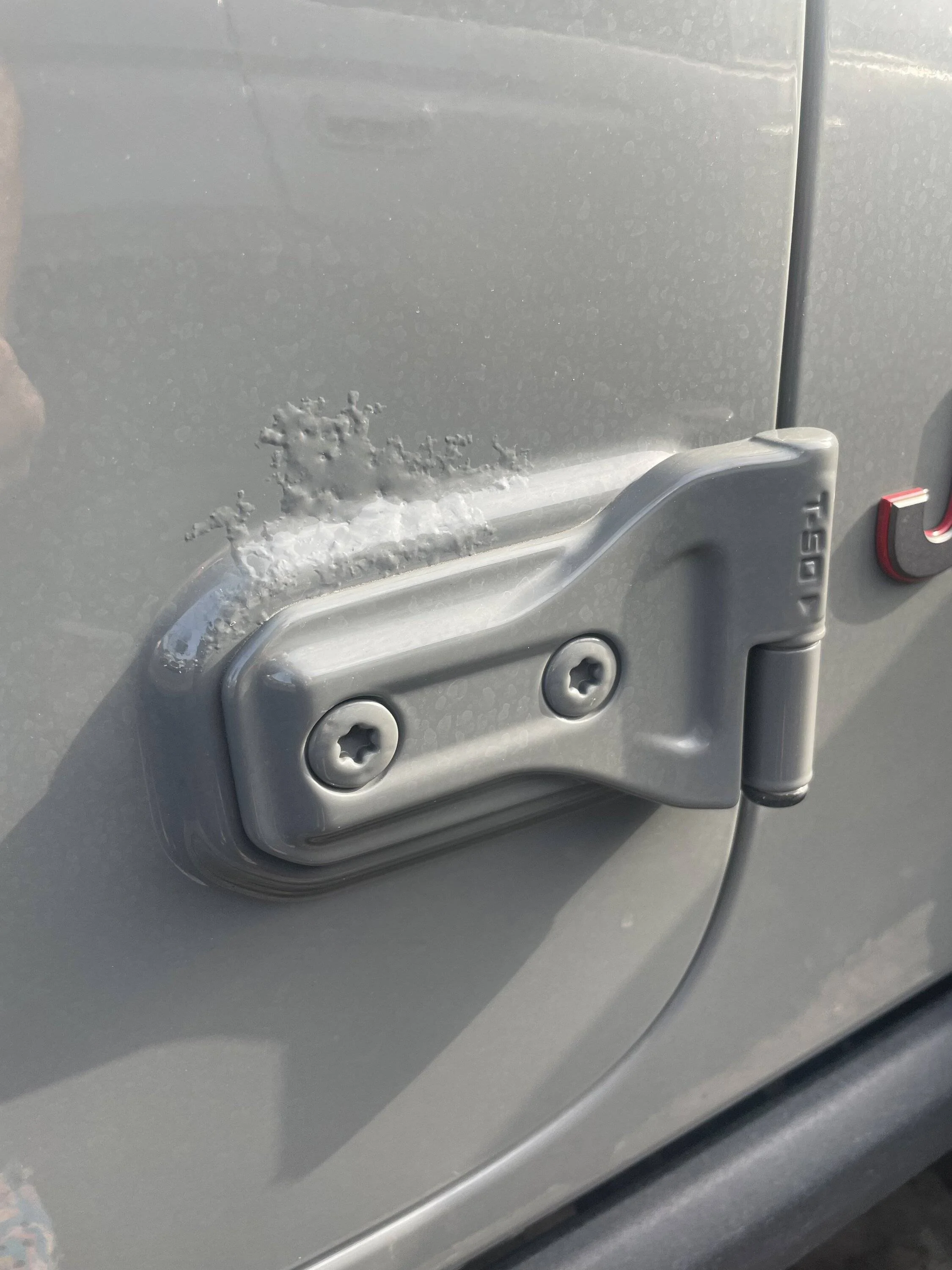

Just got my Jeep 2018 2 door
Paid cash with 32000 miles on it
I got it for a good deal but now I am wondering what I have to do to fix the horrible bubbling on the door
the Jeep is in immaculate condition
But the only thing is the hinge paint is bubbled up really bad

Good looking Jeep. Take it to your dealer and file the claim.

Yikes! That's among the worst hinges I've seen.

I own a 2019 Wrangler and it needs the entire truck repainted. Jeep has what they call a "soft" recall on all JL models. When they switched production they used Carbon steel press dies to form the aluminum body panels causing carbon contamination in the aluminum which gradually reacts over time causing the bubbling of the paint. Really burnt my but that the dealer knew about it and never said a word! Now its like a 90 day wait to get it in because of the huge amount of jeeps that need the repaint. Not to mention back ordered parts like the door hinges.
So my advice is if anyone owns these jeeps to take it into your dealer ASAP and make a corrosion claim under warranty.

Just take it to your dealer and ask them to file a warranty claim. Don't use the term soft recall because that generally refers to an issue that can be remedied without any owner involvement (ie over the air software update). It's 100% up to you to get a claim filed.
