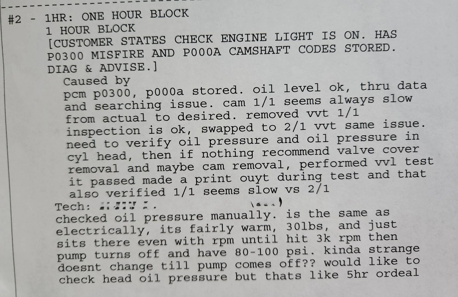

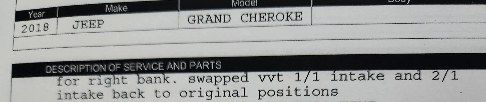

Took it into the dealership and I had just gotten laid off due to corp acquisition, so didn't have discretionary money for them to dig deep into it (their notes are attached as images). They told me I could keep driving it as it was sporadic, not overheating, etc. It has since started getting worse to the point where it happens at the start of a drive, can restart the engine, may do it a couple of times, and then it runs fine. Usually seems to trigger with that transition at 3k rpm when the oil pressure changes from 30 to 80... Can occur going up or down in RPM. While its occurring, I can shift to neutral and rev it up fine w/o issue, so exhibited more under load. Usually is a thunk/stutter, CEL, and then rough running/loss of power/mis-fire. Once it gets warm (I am assuming?) it runs fine... granted I'm not on it hard to stress it.

6) what is the "kinda strange" the tech is talking about with oil pressure and pump turning off... it seems like when I watch the guages, it goes from 30-80 normally right about 3k rpm.

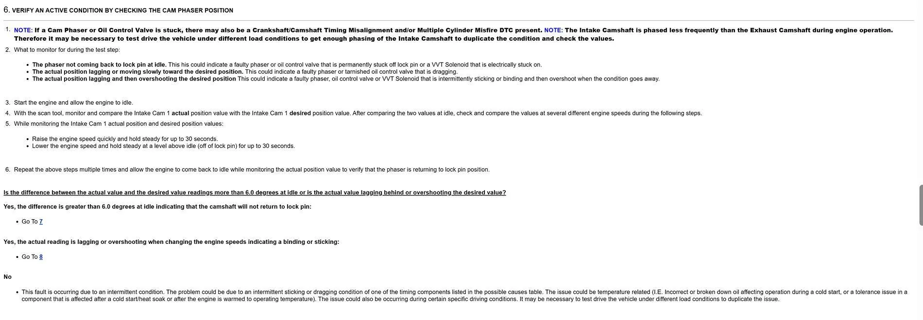

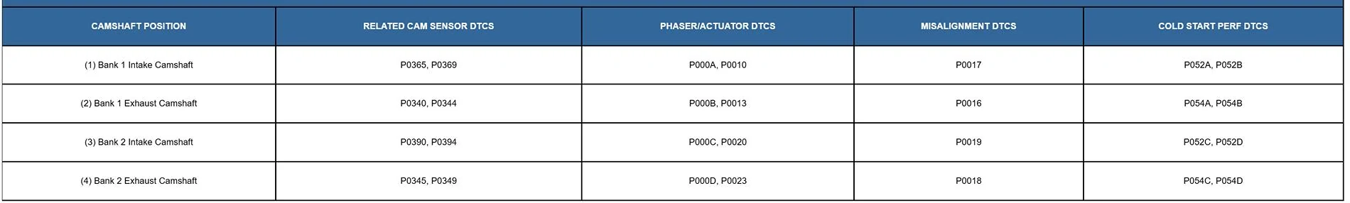

Hey there, take a gander at the following chart as it might provide some assistance going forward.
*Generally* this issue ends up with a phaser, OCV, and cam replacement. In this case you're looking at the right bank's intake cam. The rockers etc aren't part of the issue. The easy thing is to swap the VVT actuators from that affected cam with another one on the opposite bank, but it seems the dealer already did so. The oil pressure numbers seem fine, and if they were an issue you'd have problems or more than just the one bank. If the issue doesn't chase the actuator then there's a few things you can do before replacing the components:
1. Get the engine oil HOT (drive on the highway in 4th gear or so) and change the oil + use an OEM filter
2. Using Jscan (or wi-tech) run the VVT cleaning routine under PCM Misc functions a few times on all 4 actuators.
We've had some some success with the oil change/cleaning routine in the past. It's cheap and a lot easier than replacing the phaser/ocv/cam. If the p000a continues to come back then it's probably one of those components. The actual "slow response" test is outline in the below picture. JScan can probably get the data readouts required for you.
