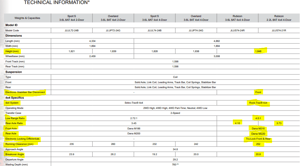

Just for everyone's knowledge, just sharing the details from the dealer on this. Regarding the suspension, dealer had attached a page from the vehicle specs in which he highlighted the componants that surround the suspension and are major factors in the reaction to the suspension and feel of the car. These additions are in the purest and simplest way of saying parts that are associated with vehicles made for nothing but offroading and add additional costs to maintance especially if not utilised and used.
For example the Dana M210 and M220 on te Rubicon is a heavy duty componant that offroad specialists sought after.
These diffs improve everything from your crawl ratio and and even your approach and departure angles that mountain climbers and hecitc offroaders fight to get....
Jeep Wrangler JL Overland vs Rubicon upload_2019-4-28_15-38-8
