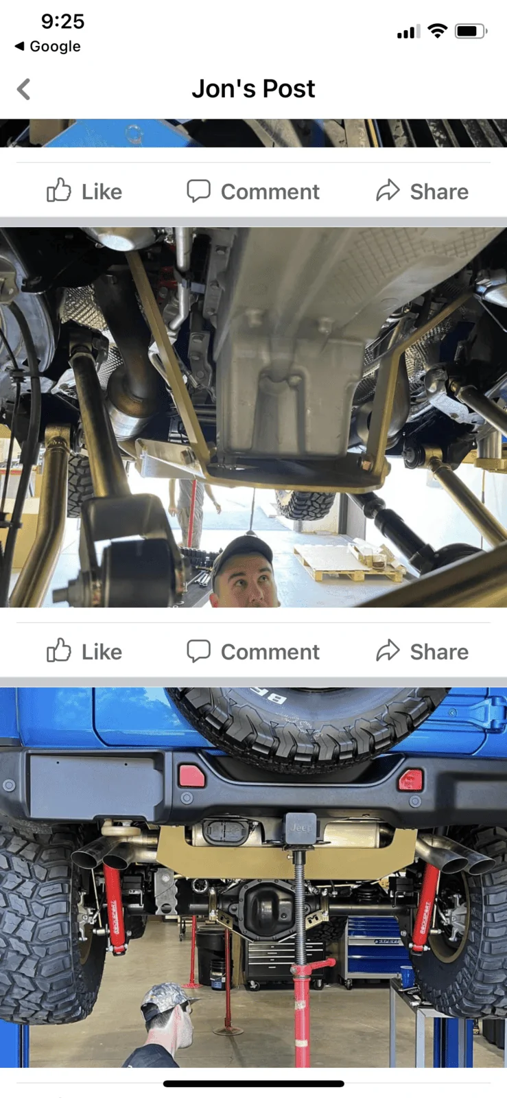

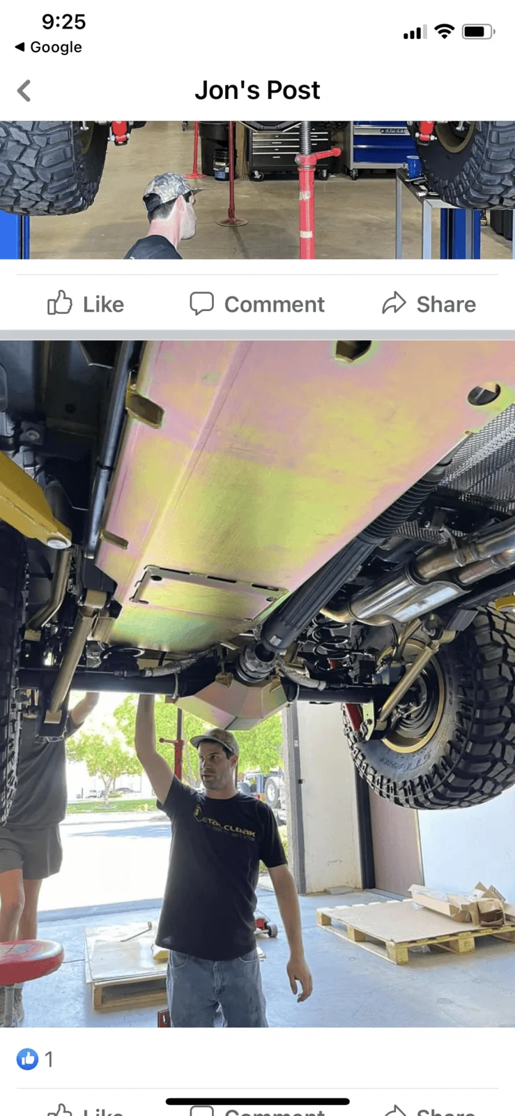

Not sure if this FB group will post here but looks like Metalcloak is close to releasing one.
Jeep Wrangler JL Oil pan skid. 6714FE8A-197B-4FD1-854A-453F1E547D01
Jeep Wrangler JL Oil pan skid. 26BBC607-A9E8-4FB7-9C2D-C1ED3F2D26C4

Great to see the first full lift kit for the 392. Metalcloak makes solid kit.
Don’t see an option for 392 on their site. Wonder if they just used the springs and from their diesel lift kits and maybe adjusted the front and rear track bars as those may be different on the 392?
I’d really like a 3.5” Dual Rate system with shock relocation brackets so I can keep the stock shocks with Gold lettering 😅.
With these types of belly skids under the engine and trans, do you have to remove them to change the oil & filter?
I Do not believe they would design anything that required removal. If you look at oil pan skid you can see access hole to drain plug.

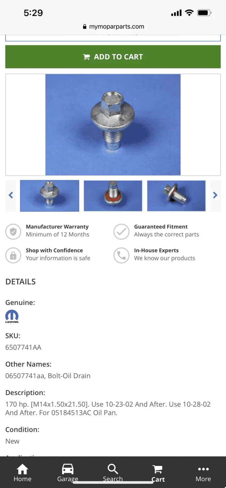

Yikes. In the meantime something like this would be better-
Also, locating this needs to gain more traction. Looks like it could gain an inch of clearance not to mention less snag points in the profile.
Jeep Wrangler JL Oil pan skid. 7412A7F0-A504-4FE4-8F53-82FCC7B3BDCE
This is the OEM plug. M14x1.50x21.50.

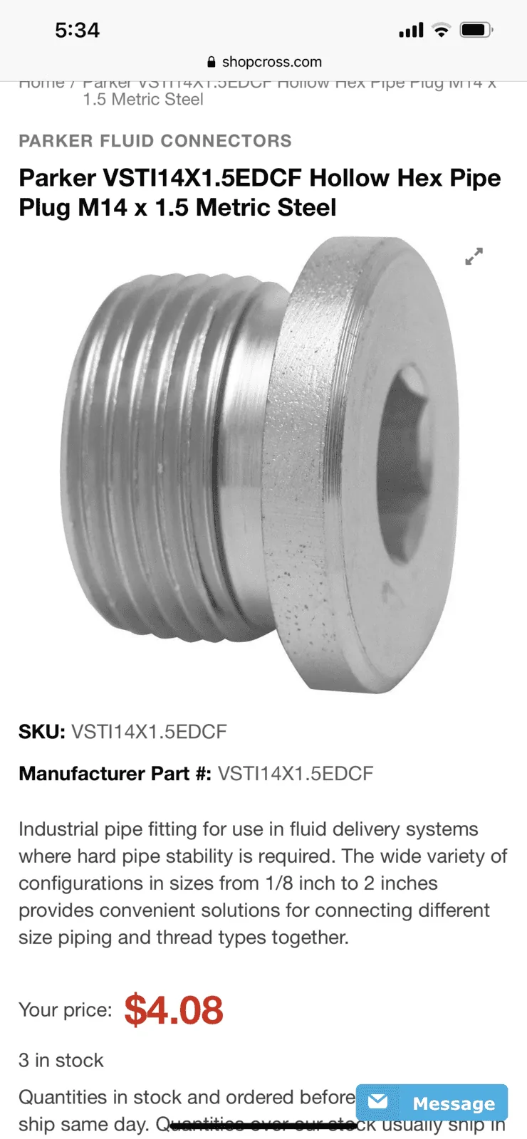

So is this it?
Jeep Wrangler JL Oil pan skid. 92FCF1ED-E85C-46F4-AA6F-2728D5314065
Others may know a better place to find the part.
